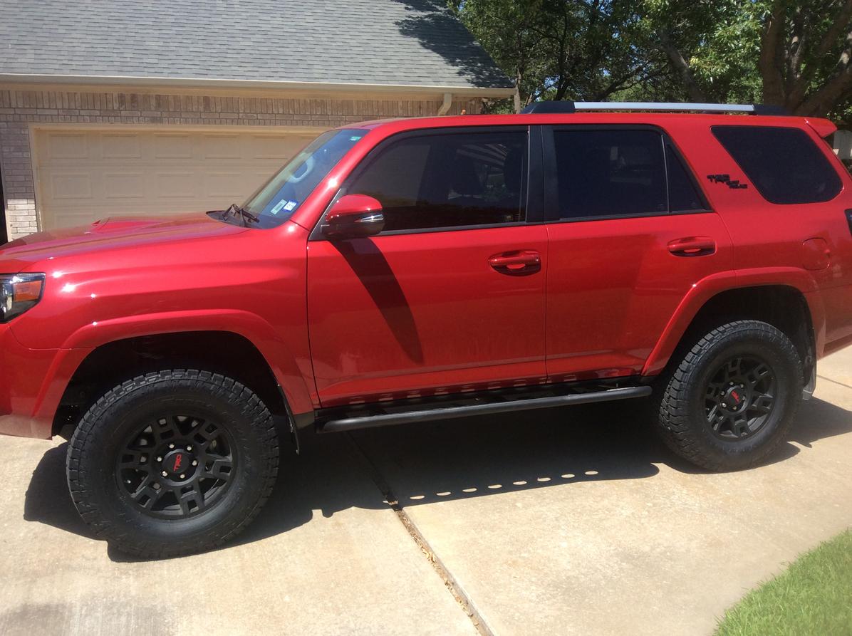

1. Will I retain a minimal factory rake with a 2.25" front + 1.5" rear spacer lift for a trail with KDSS? Or should I do a 2" front spacer.
I hear some 2.5 front spacers with the 1.5 rear lift can sometimes result with a reverse rake, so I want to avoid that, along with keep a small factory rake (in case I have passengers in the back)
I've got Dobinsons 2.5" front/ 1.5" in back.
Did you do just the springs or did you do the shocks as well? Also what are the spring numbers you got? I found them but there are many spring numbers available front and rear and lift height is different depending on weights.
