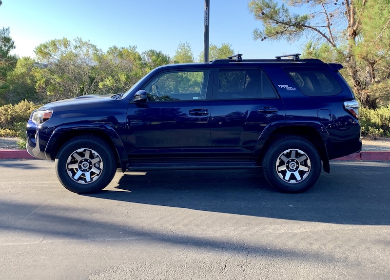

Bilstein 5100s all around 1.75 up front, stock spring height in rear
I just wanted to level out so I was going to go with .85 up front and 0 rear.
The shop tech suggested I go 1.75. It looks like I picked up a little height in the rear with just the 5100 shocks. Of course I didn't measure anything beforehand!
Levels out perfectly when not loaded down. Stock wheels and tires... for now!
