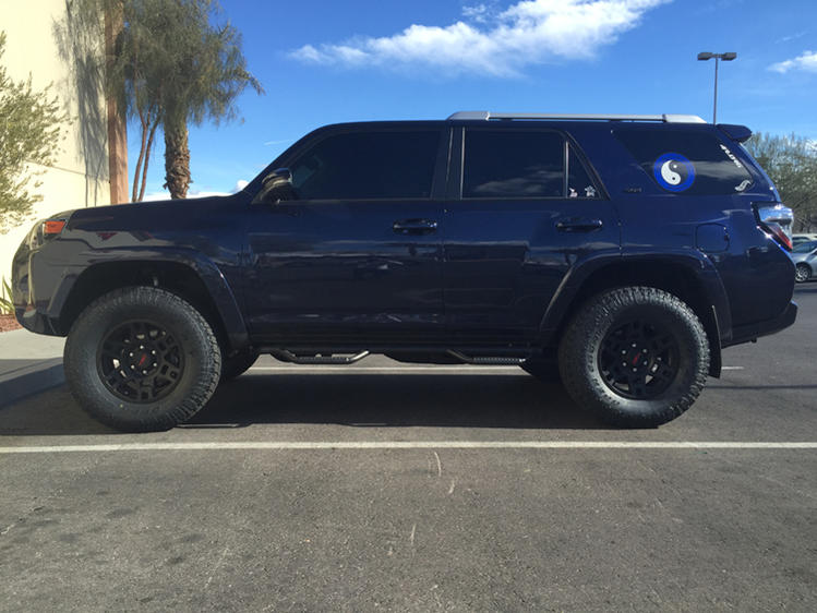

Any guesses at the Lift and Tire size on this 4R?
Does anyone have any guesses at the lift/leveling kit height and tire size on this 4Runner? I really like this OEM+ kinda look and would like to replicate it on my nautical blue TRD Offroad.
