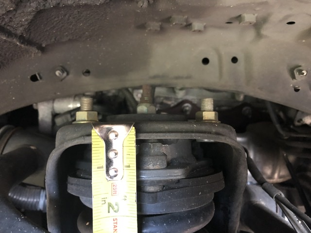

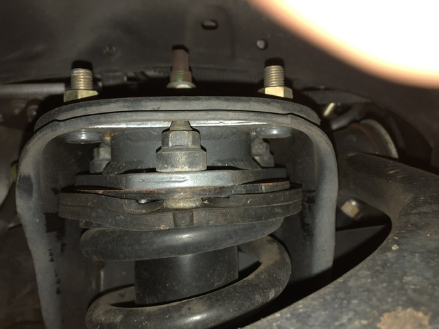

Between the top plate of the strut, and the mounting point of the frame. You remove the front strut assy, attach the spacer on top of the assembled strut, then re-install the complete assy.
A 1"-thick spacer gives a little over 2" lift, because the spacer is about halfway between the pivot and the tire.

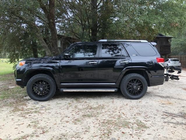

Great post with lots of info. I recently purchased this ‘11 SR5 and am trying to find out exactly what the previous owner had installed. He says he asked the shop to level it when they installed the wheels and tires. Best I can tell that’s 1.25” spacer so is that considered 2.5” lift?? I need to crawl under and take a closer look at the rear but I don’t think it was touched. As it sits right now it measures level but appears to have a reverse rake at times, which I can’t stand. Assuming the rear does not have any spacer what should be added to even it out?

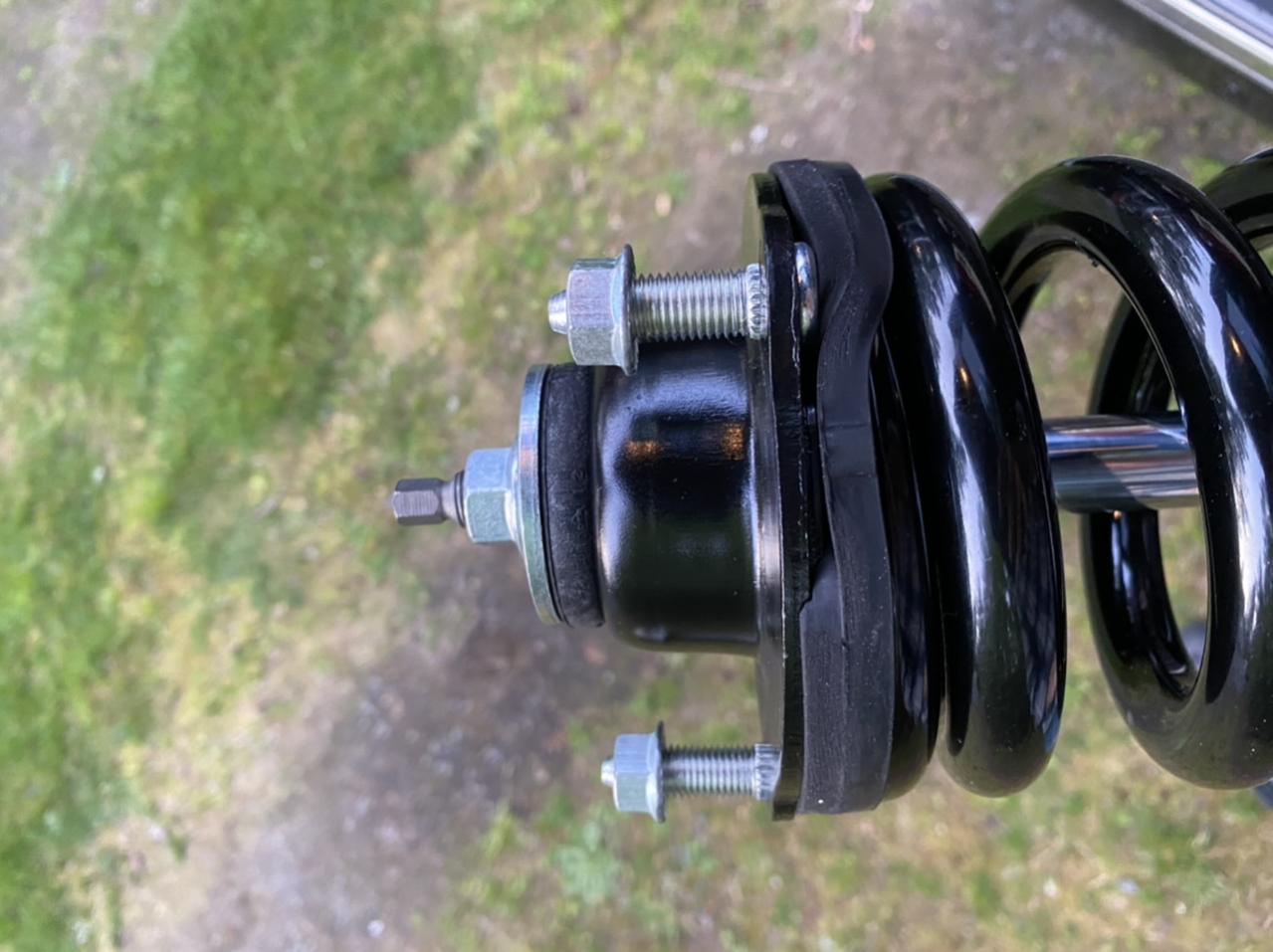

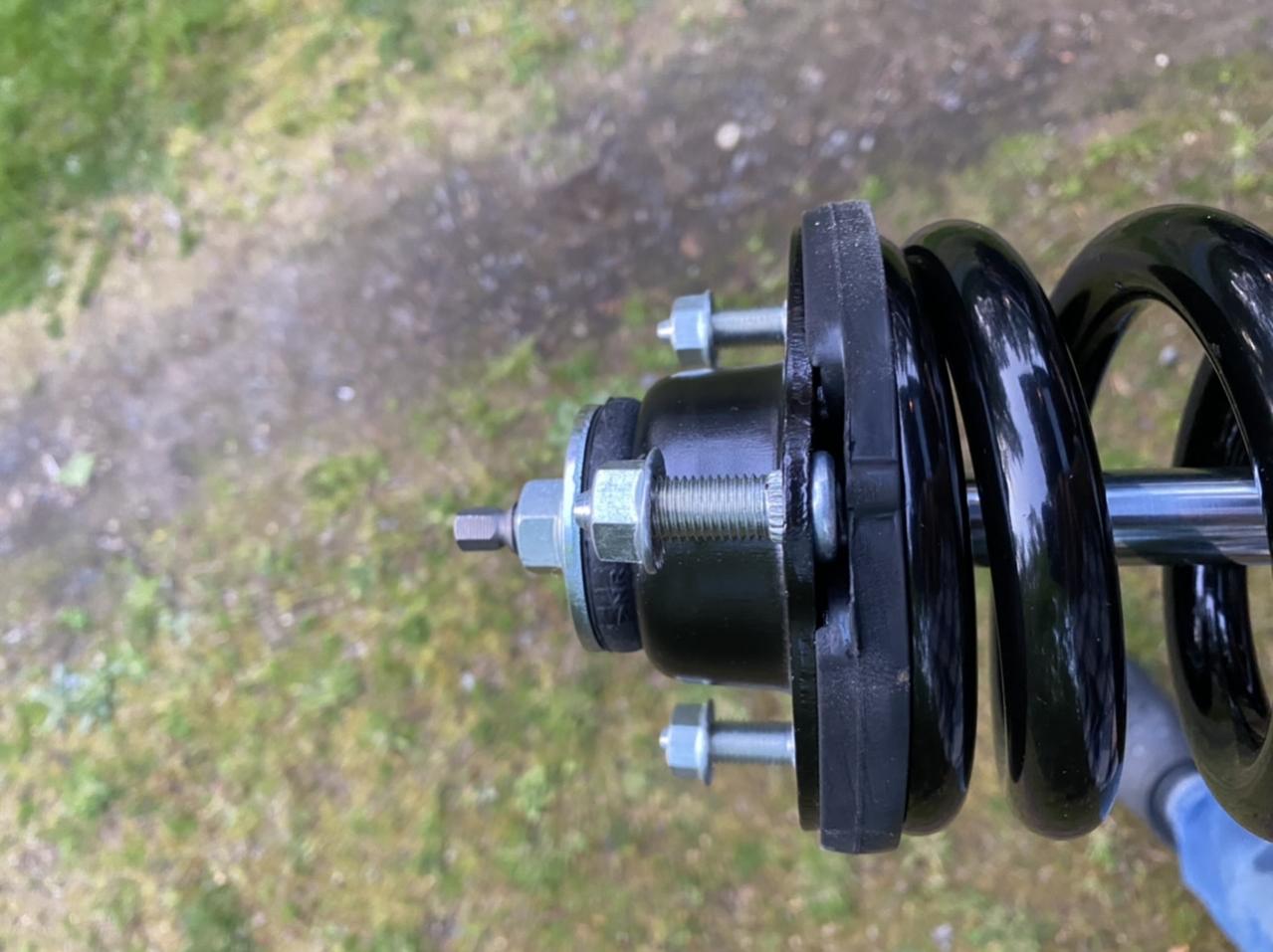

I had a set of 6112s assembled at a local shop and the top hat rubber gasket is not aligned with the bolts on one of them - is that a big deal?
