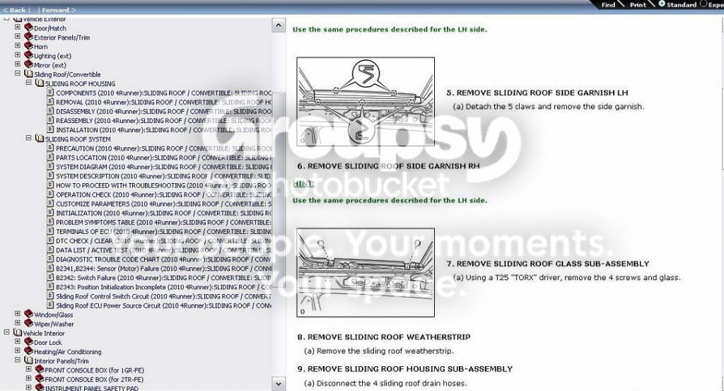

It's in the repair manual on how to replace it and troubleshoot for a bad motor/cable but nothing on specific rattles.
From your description and the manual it may be one of these T25 Torx screws under the trim that are loose are missing. If not it could be one of the fasteners from the whole assembly which requires removing the headliner to find it(not easy to do)
