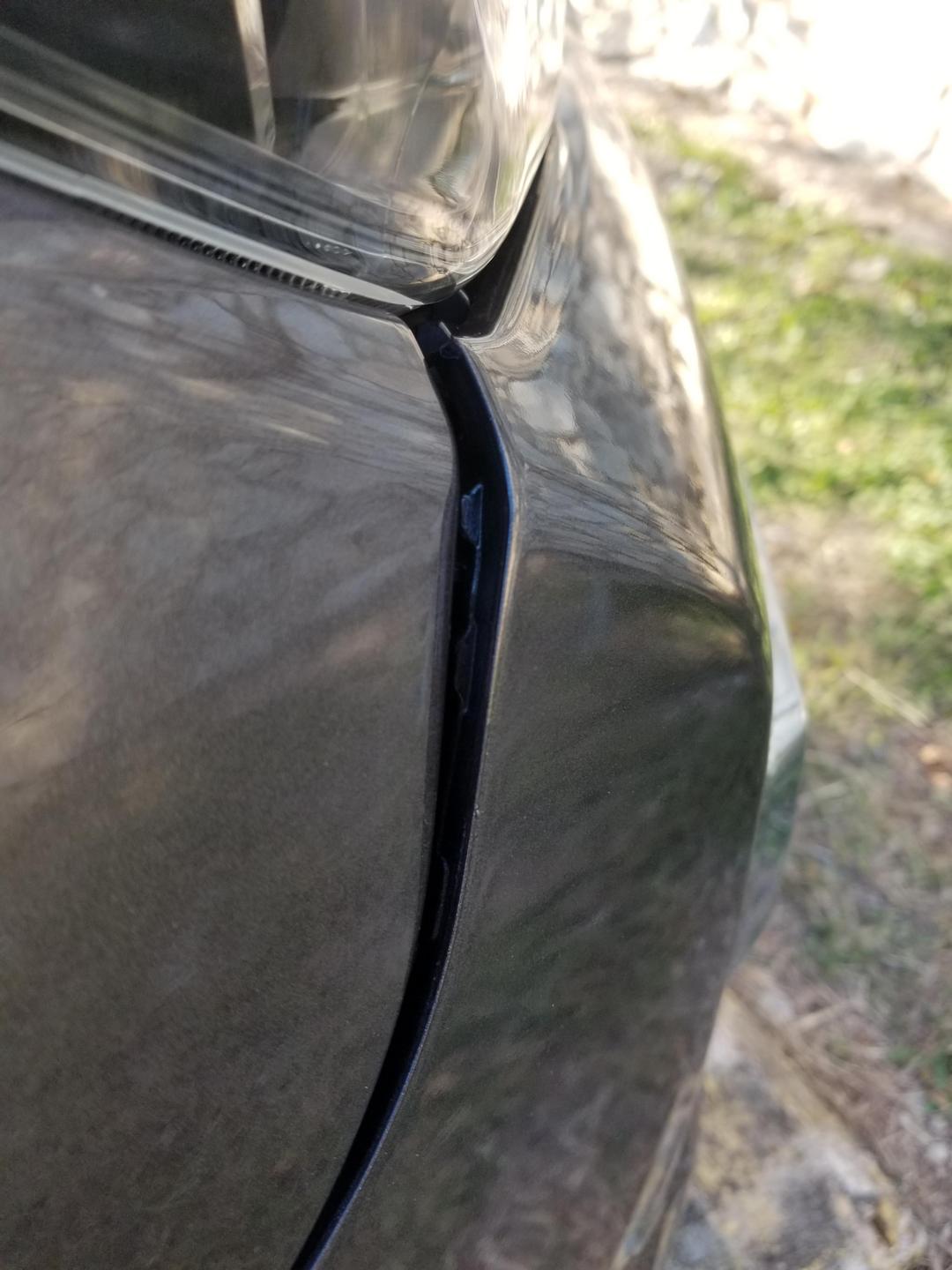

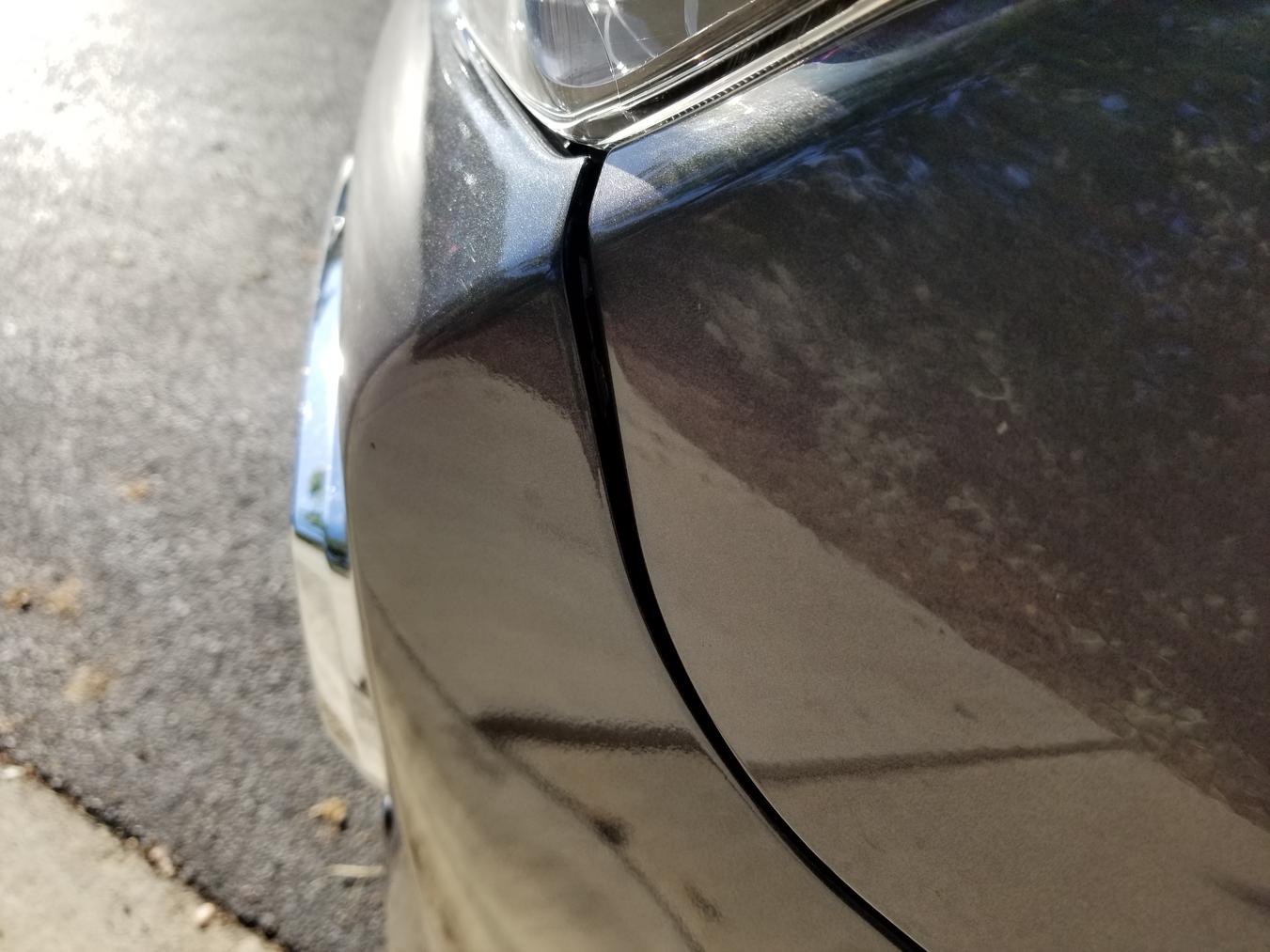

OK, so my dealership called earlier (North Park Toyota in San Antonio). I have been extremely pleased with their customer service, and going over and beyond to get this issue fixed. They have driven out to me (over an hour away) and dropped off a loaner and picked my truck up each time they have had to look at it over the past month. They called today and said they will replace the front bumper because the tabs are bent and some are broken. The loaner they gave me last week has tags that are expiring today, so they're going to send out a 4runner first thing in the morning so I can have something to haul some stuff and my family to South Texas this weekend. They'll have to paint the bumper and install when it gets in, so they said it'll be ready on Saturday or Monday. Hopefully this resolves the issue, but I have read other threads where they replaced the bumper and the same problem arises 6 months later. I'll keep everyone posted with pictures and such. I'll post some before pictures here in a little bit.
Front Bumper

Just wanted to update everyone. The dealership dropped off my truck yesterday, after getting the bumper replaced. The bumper is tight on the corners, but doesn't line up perfectly and there are definitely imperfections in the paint when they painted the new bumper. I'm sure they outsourced the painting and installation to the cheapest 3rd party body shop they could find. At this point, I'm tired of the back and forth with them. I'm going to let bygones be bygones and wait until the bumper pops out again, or the paint starts chipping. They definitely did go over and beyond on getting the issue resolved, but they cheaped out on labor and the fix which is kind of disappointing.
