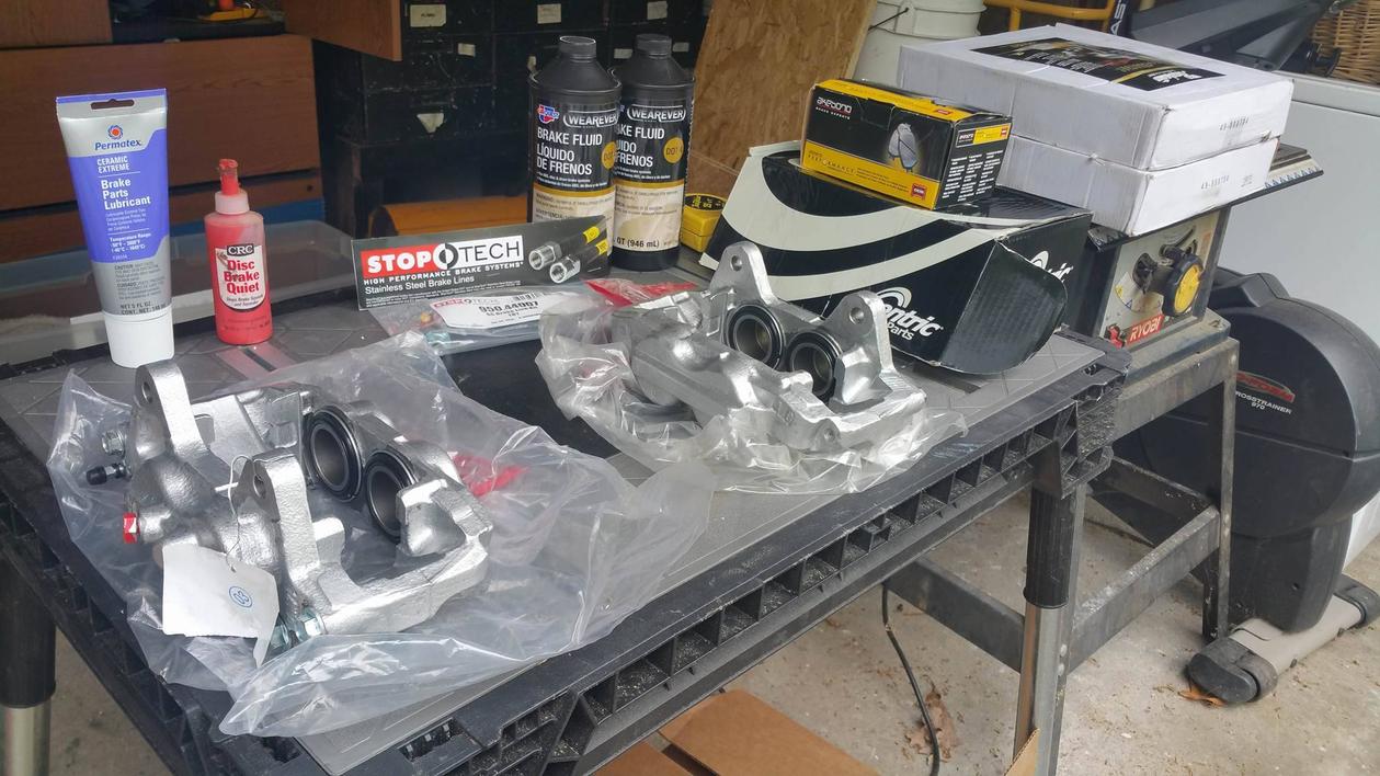

I've gone through most of the thread and just can't find the 5th gen centric rotor part numbers and rear brake pad numbers. The OP has rotor parts in his photo but I'm not sure if those are front or rear?
Edit: I think I have confirmed 120.44174 is front 5th centric rotors. 120.44175 is for the rear?
Data I have so far:
Centric 5th Gen Calipers:
141.44587 - Right Rear
141.44588 - Left Rear
141.44287 - Right Front
141.44288 - Left Front
Centric 5th Gen Rotors:
120.44174 - (x2) Front Rotor
120.44175 - (x2) Rear Rotor
5th Gen Brake Pads:
ASP976 - Front Pad (Akebono Performance Ultra-Premium Ceramic)
ASP606 - Rear Pad (Akebono Performance Ultra-Premium Ceramic)
04465-60320 - Front Pad (OEM 5th Gen)
04466-60140 - Rear Pad (OEM 5th Gen)
Brake Flex Hose Stainless:
5500FJT-AP-F - (x2) Front Caliper
950.44507 - (x2) Rear Caliper
5500FJ-AP - (x2) Rear Axle
Brake fluid (Any brand that is DOT 3 or 4 will usually work)
00475-1BF03 - Toyota OEM DOT 3 Fluid

The part numbers you have are correct.
The rear pads I used were ASP606.
I didn't worry too much about specifying part numbers since you can use any brake parts for the 5th gen. Every brand will be different part numbers as long as they are for the 5th gen 4Runners

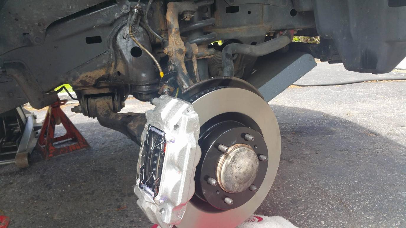

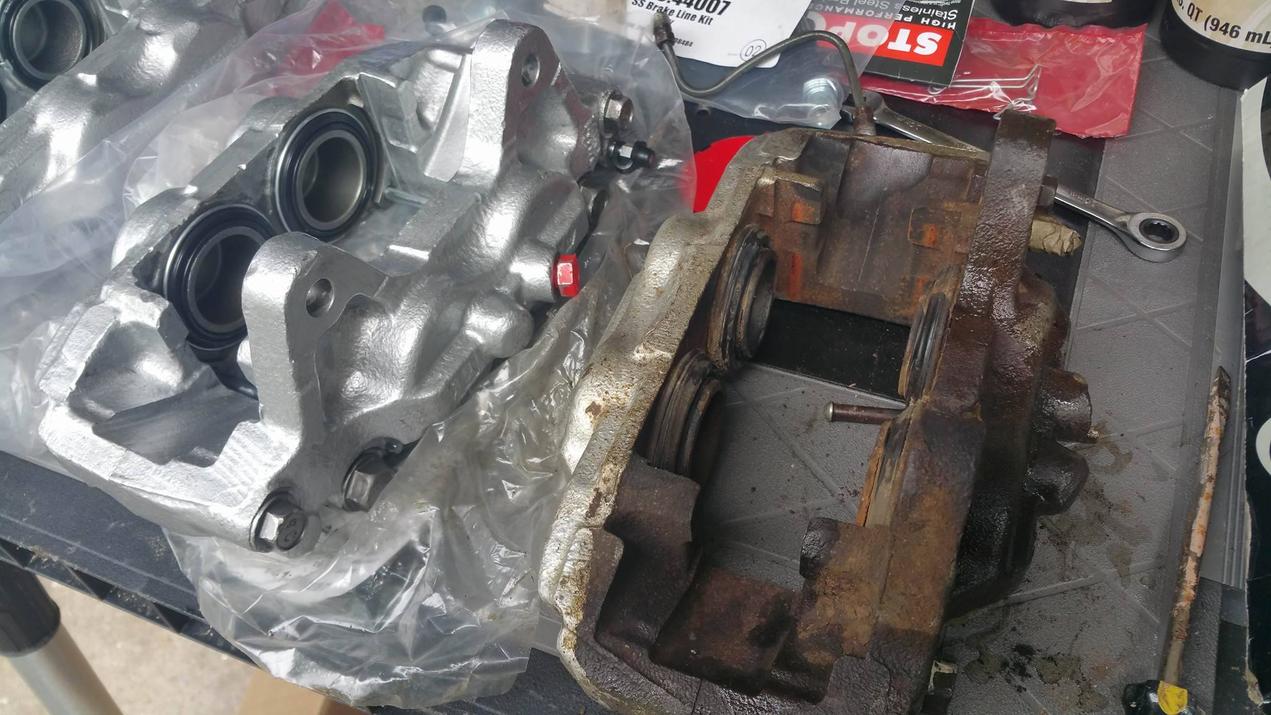

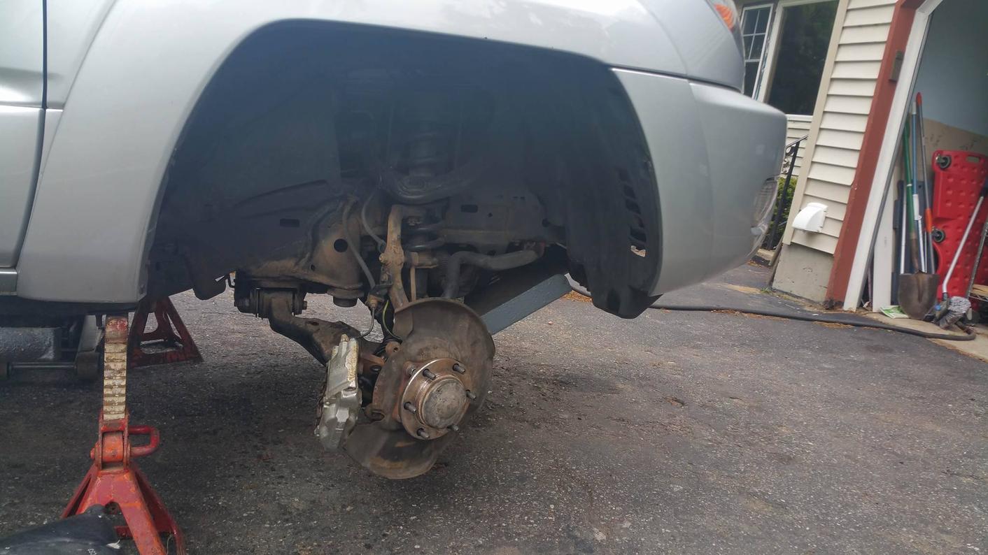

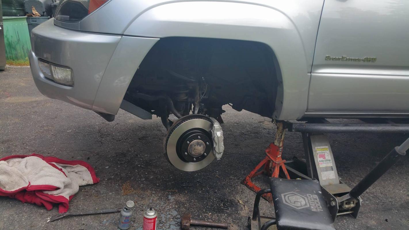

finished up the 5th gen swap up front, and installed stainless braided lines. No too bad, too my time and went over everything. Also not pictured was the touch up i did to get rid of any surface rust.
Results, they feels 100 times better then before, smooth and responsive, but I believe there is still air in lines so im going to have it powerbled.
Excellent upgrade for braking overall.
I plan to regularly lubricate and grease the slider pins on the calipers as this seems to be partially the cause for the 4th gen calipers not functioning properly over time.
