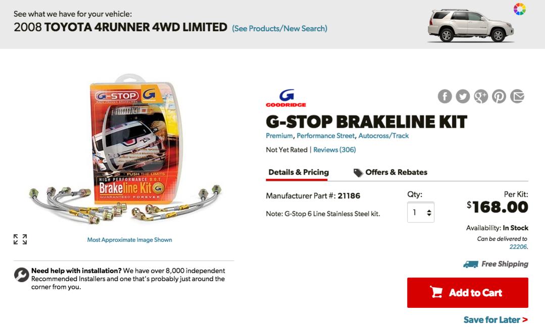

DON'T get the G-Stop Brake Line Kit - the rear lines don't fit!
I think the 5500FJ-AP-R are for the axle. If the picture is correct, there's no banjo fitting to attach to the caliper.
y3mvyL5SVnnxKm4N3SUaVRn3a0ncY1qvmyk7svoKFJ31iGjVt1MeHGh0bA1u1ZYVweSQwuPJ-N1nmGuM9efWhbEcPy1KCdauWwadTNsoJvdgSFFgxETLIraaJM9MlLVGekV8Ssun24W5Qy4bQn08sWGsQ
DON'T buy the Goodridge G-Stop Brakeline kit (see image BELOW), because the banjo fitting for the rear brake line doesn't fit
because the diameter is too large, and the connection is 180 degrees straight, while it should be bent at an angle like the OEM connection.
The result is that you can't use it, even if you try grinding something down to make it fit.
I only briefly considered mounting this aftermarket banjo fitting at a different angle, so that it does not sit inside the two "tongs" that secure the OEM fitting to keep it from rotating left or right...
but then I realized... WAIT!!!
This is a critical safety item.
Suppose it leaks or fails.
I could die or kill someone!!!
YOU DON'T want to jerry-rig your brakes. If something doesn't fit, DON'T USE IT.
So.... DON'T GET THESE.
The rear brakes require a banjo fitting, and the banjo fitting in this set DID NOT FIT. The "neck" of the banjo had too large of a diameter to fit into the slot on the calipers, and the OEM connection is at an angle, while these aftermarket ones were a straight 180 degrees. The result is that I couldn't use them at all, because they don't fit, and even if they did fit, the brake lines would have to bend at too sharp of an angle to connect properly to the rest of the system.
I figured I'd save someone else some $$$ by sharing this information. The front lines and the "center" lines fit fine. However, I had to order a different set of rear stainless steel lines. I decided not to return the set, but I wouldn't buy it again.
FYI and beware.
