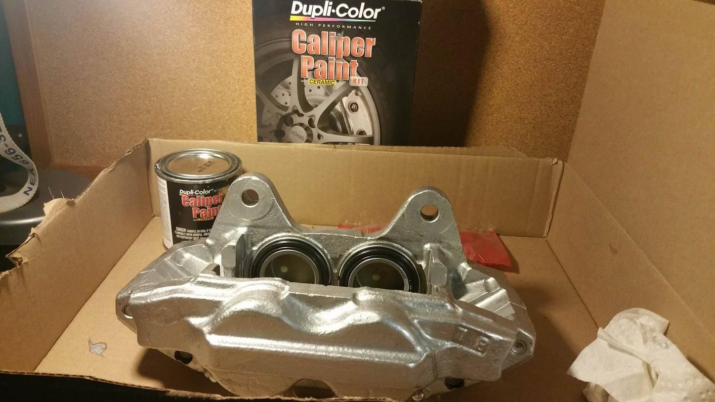

hey all, just a warning about the G2 paint system. DO NOT use a solo cup for mixing purposes. I tried to mix half the batch up front for the first coat or two and it ate right through the cup in a few minutes. lost most of it. (yup, i'm that guy. what a stupid move)
no big deal, still had enough for multiple coats on both front calipers. i posted pics here. they turned out great.
Doing some second coat paint touch up on my 5th gen Centric 141.44287 while I wait for the 141.44288 to get here from autobrakecenter.com
Calipers are hard to find in the same place apparently.
