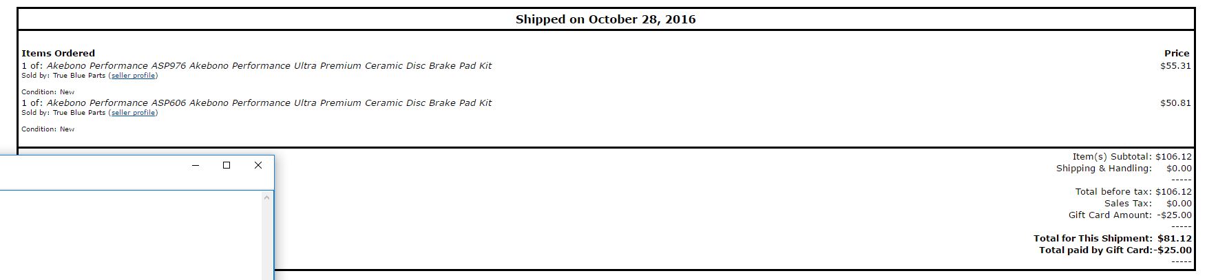

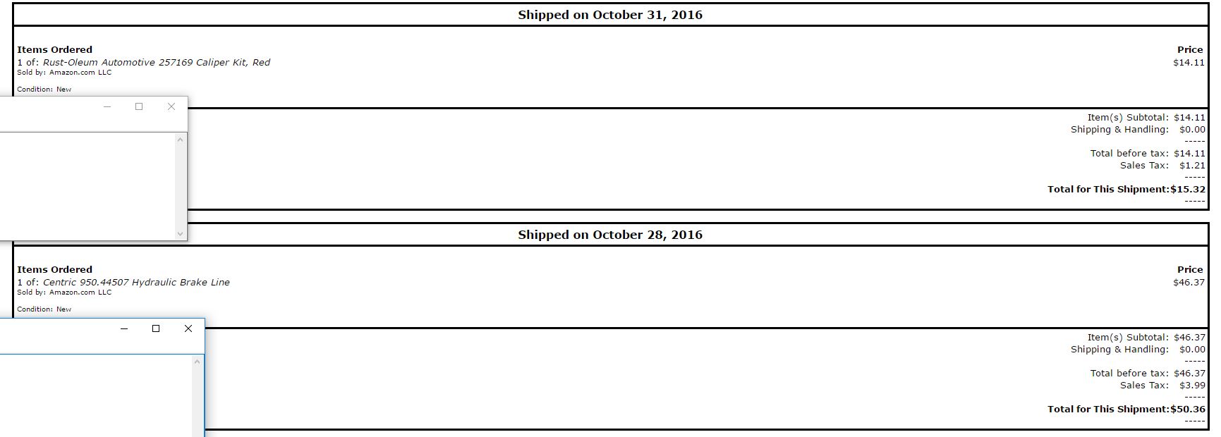

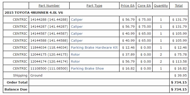

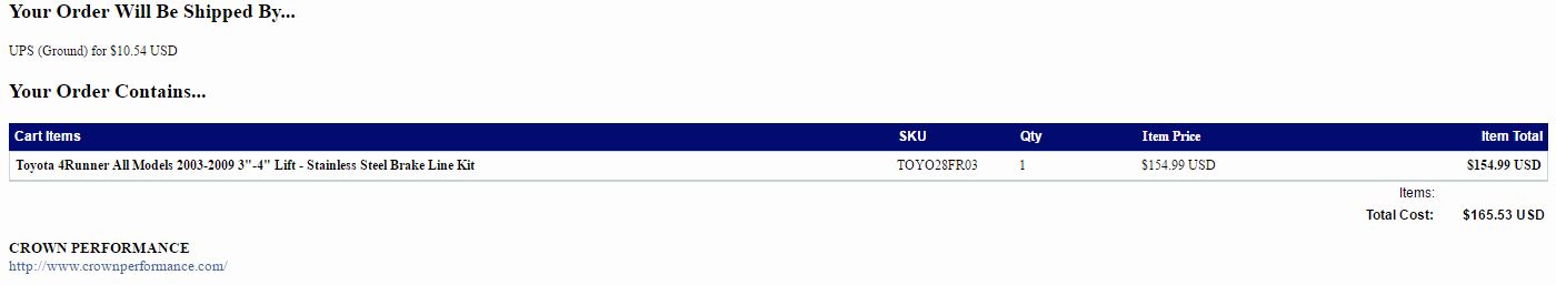

Post part numbers and preferably your receipt!!! (with personal information redacted of course)
Sent from my XT1575 using Tapatalk
Attached. The crown brake lines should be here today.
$1071.48 Out the door totals
$280 Core Charge
$791.48 Final cost (Way too much!!)
These brakes better be the shit and last another 100K!! LOL at least when I will need to do them again it'll be just pads and rotors. Since I live in AZ, these calipers should last even if they don't for those in the rustbelt.
