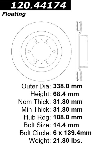

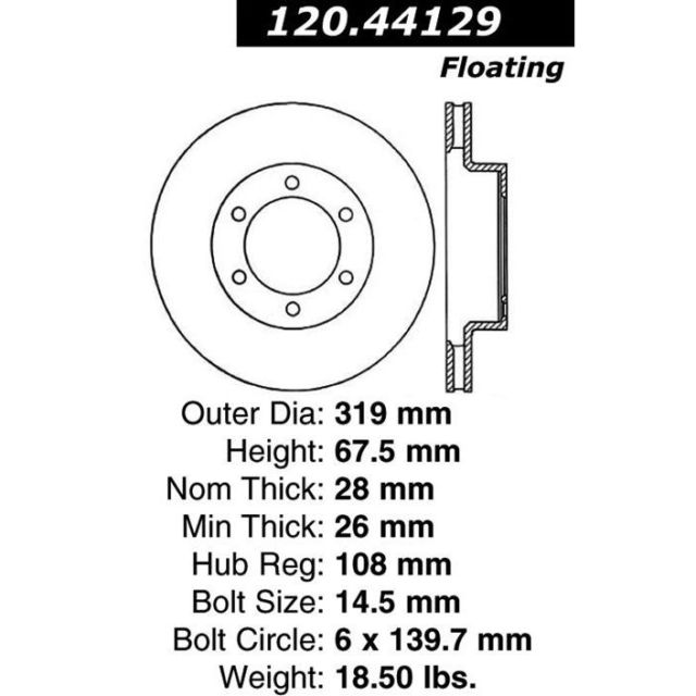

I wouldn't suggest it.
1) the 5th gen front rotors aren't just thicker, but they are also 18mm larger in diameter -- which is 0.71 inches for us American folks -- so I assume that the pads on the fifth gen front caliper won't align or grip the 4th gen front rotor properly. You're likely to have approx (more or less) 0.7" of brake pad that aren't even touching the rotor == very bad news.
See https://imgur.com/a/L8Iqx (taken and posted by a member on this same thread... I forgot who, or I would credit them)... and photos are copied here, just in case the link ever stops working.
Second, I think --at a minimum-- the front calipers should be a matching pair, just as the rear calipers should be a matching pair (that is, if you aren't willing to change all 4 calipers to 5th gen).
While this is just my opinion (as opposed to a known fact), here's some serious food for thought on why I hold this opinion.
The changes in piston size, might not be the only change. You don't want to risk pulling or uneven wear, or possibly unwanted side effects on the braking system which *is* rather advanced... not just anti-lock, but it also automatically applies brakes for traction control, to prevent roll-back while on a hill, and also for "brake force distribution" to evenly apply braking power, as well as a sensor that determines if you are in an emergency stop, based on how quickly you depress the brake pedal, it will actually apply more braking power for you automatically.
I don't know why you would ever consider jeopardizing your safety or that of others to save a few bucks. I saw the centric "c-tek" front rotors for as cheap as about $40 each, and front brake calipers can be had for about $65 (after core exchange), so you're considering saving the cost of 1 caliper and two rotors, which is less than $150 if you bargain shop. Are you willing to risk your safety and possibly your life, and that of others over $150 and about 1 hr of additional work?
