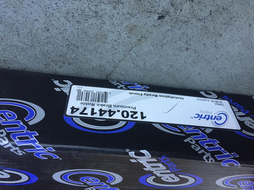

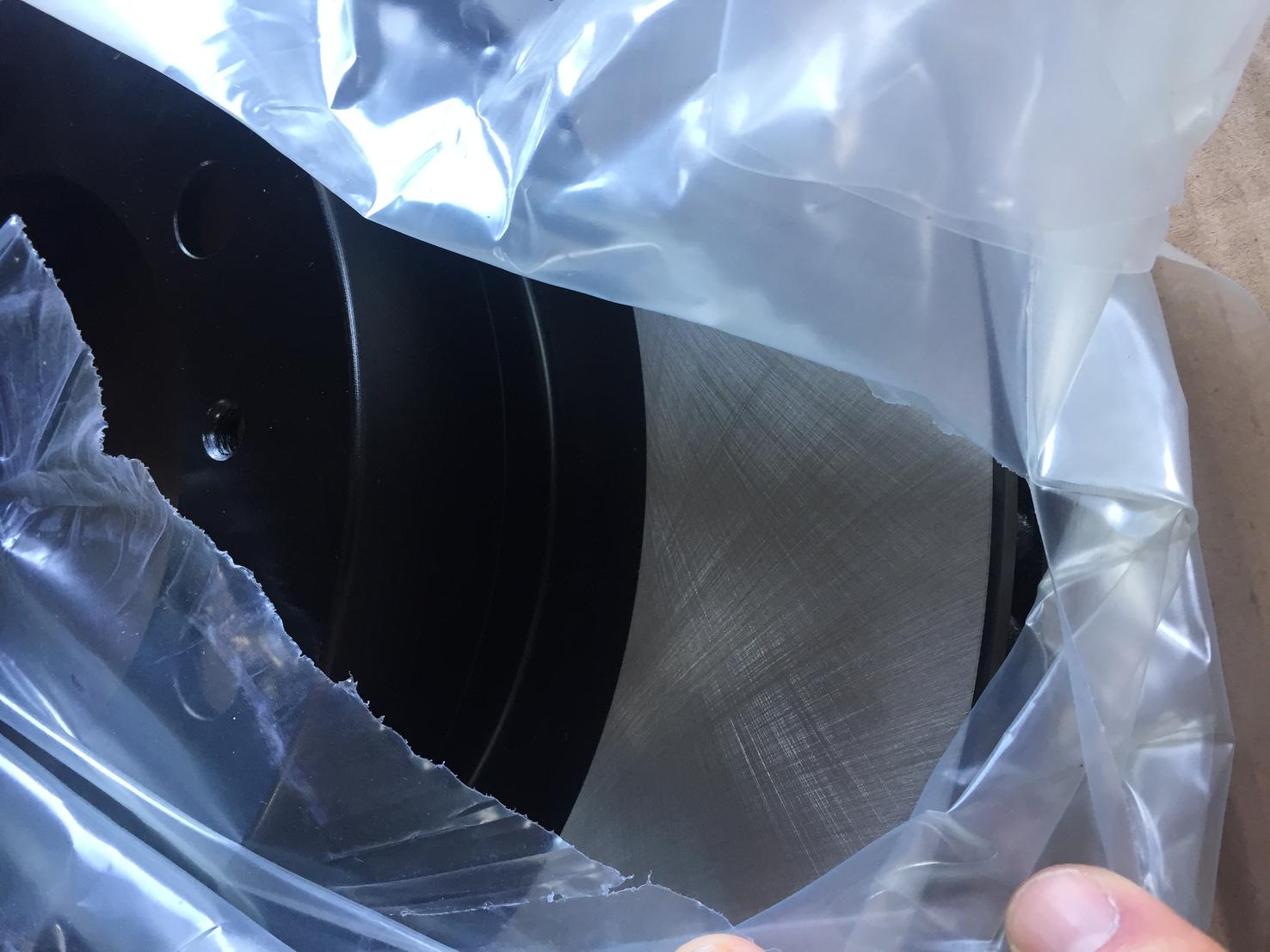

Verified the part number appears to be correct- this look like the correct rotor offset?
Shop is telling me the rotor was hitting the caliper itself, not the shield. Not sure I believe them at this point.
Those will work as long as the right ones are in the box. Get a different shop.

Unfortunately no stampings on the rotor. I'll have it to another shop next week. Worst case I have them get a set of 5th gen rotors from Napa.
Calipers have the correct 14WA stamping on them.
Thank you 084runnah
