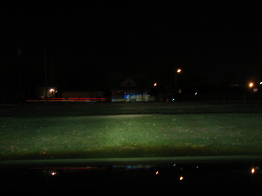

That is not entirely correct. It depends on the positioning of the "step". Bear in mind also that most (now I didn't say "all) of the road signs of concern are on the RH side of the road. Look at this picture, notice that sign dead center. It's reflecting because it's in the "step", which provides greater illumination to the right of center. No, I can't read it 'cause it's 1/2 block away, but I do know there's a sign, and I'll be watching it.

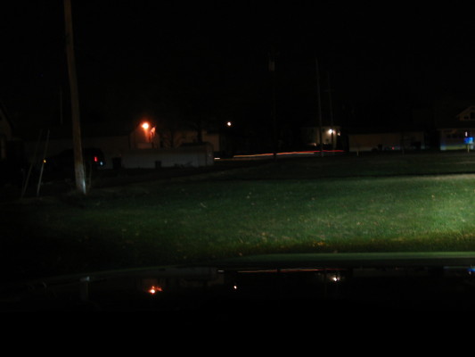

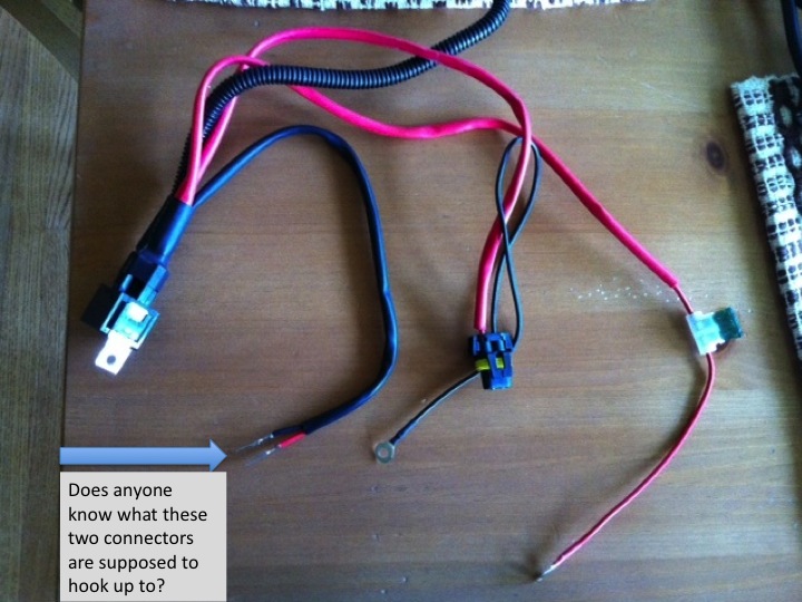

Question about Retrofit Harness
This is my wiring harness from lightwerkz, does anyone know where the two bundled (red/blk) wires with little male connectors are supposed to go?
Thanks.

- At this point, the original LB and HB plugs are off. Make sure you know which-is-which. On the driver’s side, connect the original LB’s female plug into a matching male plug on a cable from the relay. (So, when you turn on the lights, instead of lighting the LB’s, it will energize the relay, firing up the ballasts, which in turn ignites the HID bulbs). The ballasts have a heavy black cable with a unique red cap which will be plugged into the HID bulbs after the retrofitted headlights are installed.
- On the pass. side, just tape up the old LB plug as it serves no purpose.
Thanks A10MileHusker, I just realized it's where the relay plugs into the factory female lowbeam as quoted in philseys post above. I'll try and get this finished tomorrow with pics and all. Thanks guys, this forum is great!!!
