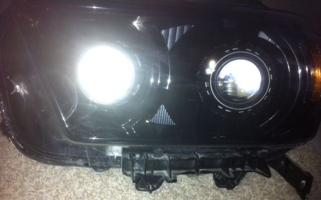

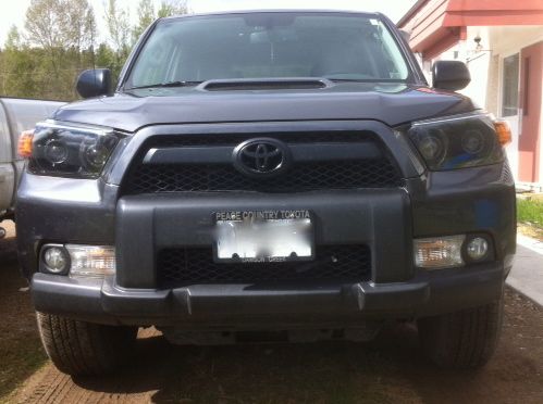

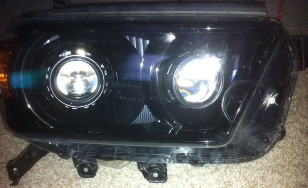

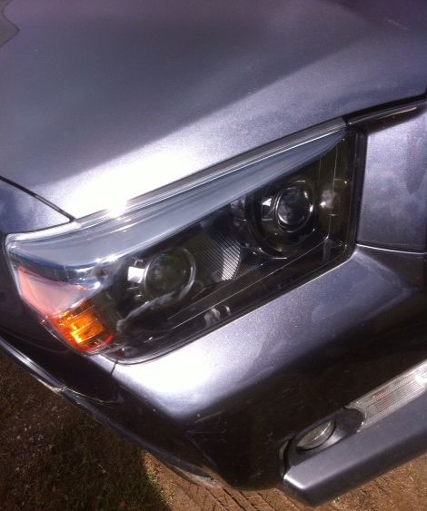

Managed to get the pictures in, sorry, photography is not in my future. The fogs are already bought and in, I agree they don't really add much when my HL are on, but they are good when the fog is out up here and the HL are off.
