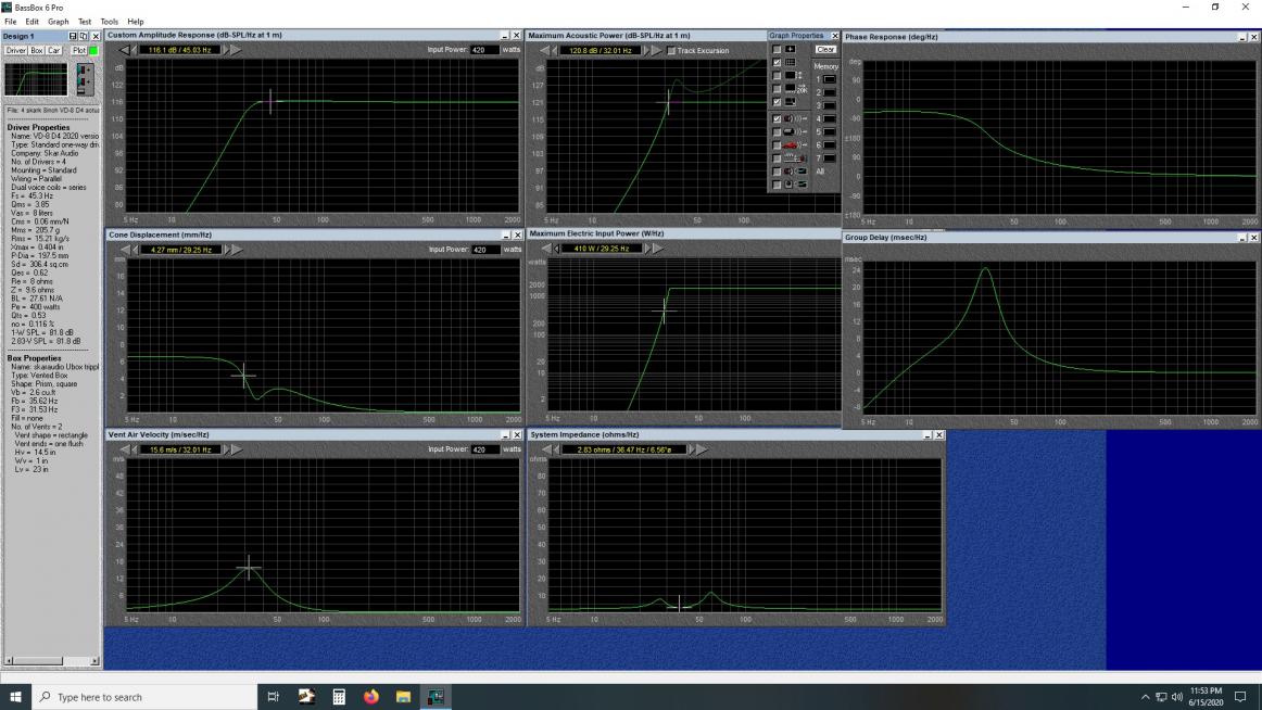

Four VD-8 4ohm DVC
Skar Audio - VD-8 | 8" 600 Watt Max Power Subwoofer (Shallow Mount)
Wired series/parallel for 2 ohm load

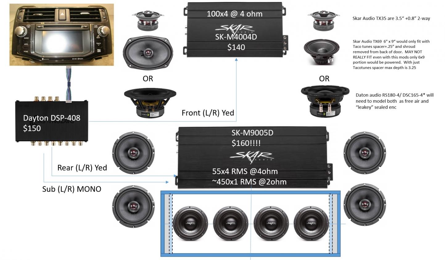

SIGNAL PATH
Factory OEM head unit
DSP speaker amp
Audio Control D-6.1200
has line level converters ( factory amp output to D-6/1200 inputs) and DSP driving ch 1-4 for Dash and doors L/R independently and 5,6ch driving rear door and hatch in parallel L/R
D-6.1200 | AudioControl
Amps
6 ch Front stage and rear fill
sub
SK-M5001D
https://www.skaraudio.com/collectio...o-amplifiers/products/sk-m9005d-car-amplifier
($120 SK-M5001D; $0.43/ watt for 380 RMS at 2 ohm) ; unfortunately audio control does not have a mini amp that fits right in that power/$ range. ($279 ACM-1.300; 0.93/watt for only 300rms at 2ohm) is the closest

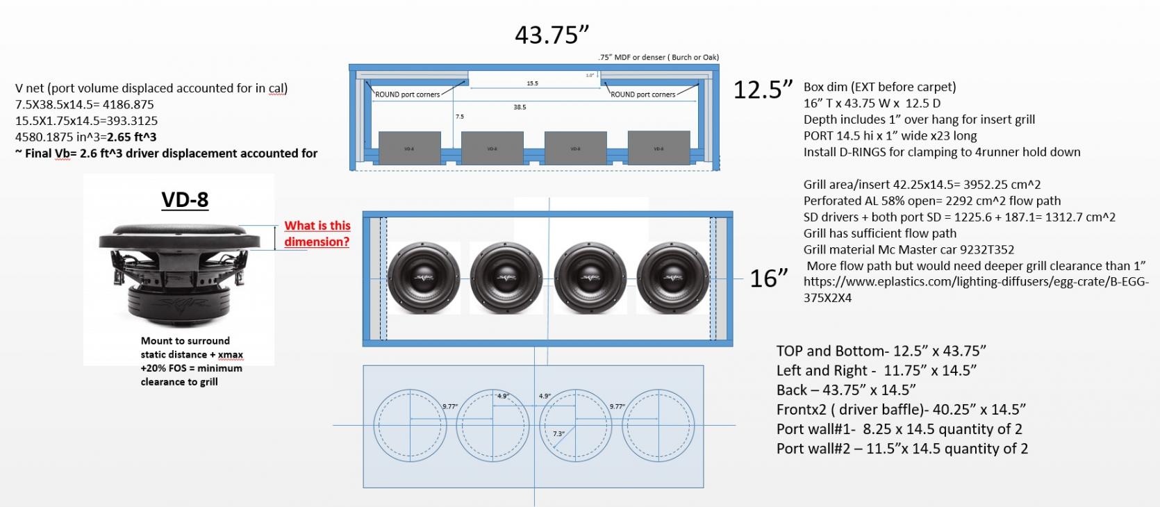

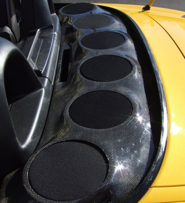

EG 6x 6.5" Tang bang subwoofers 13mm xmax!!!! in the convertable space of a Honda S2000

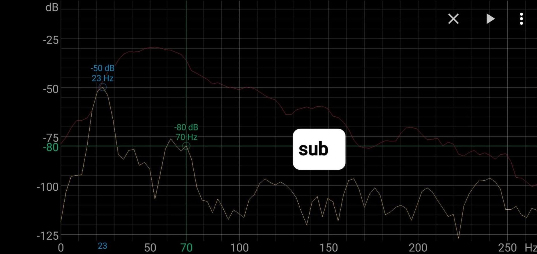

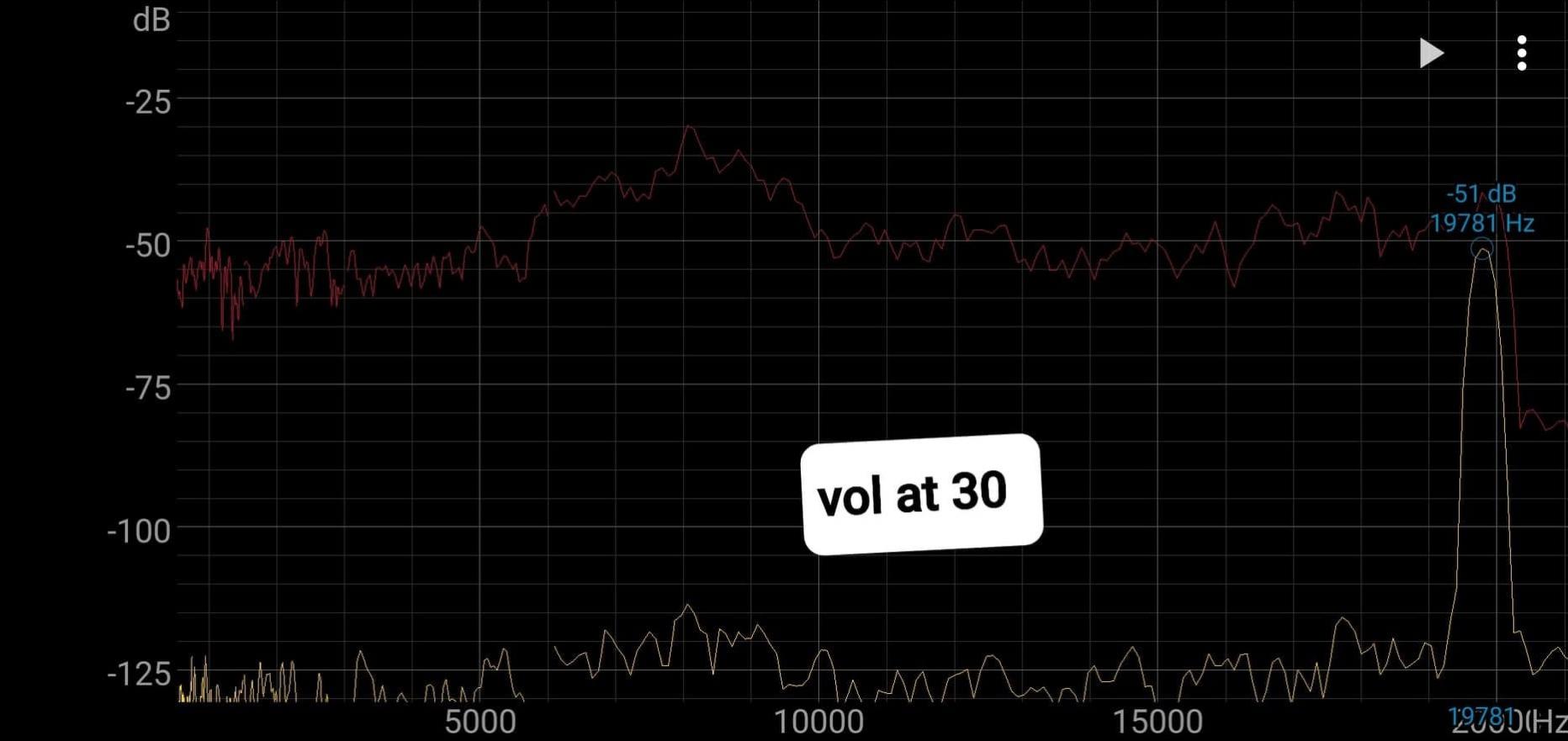

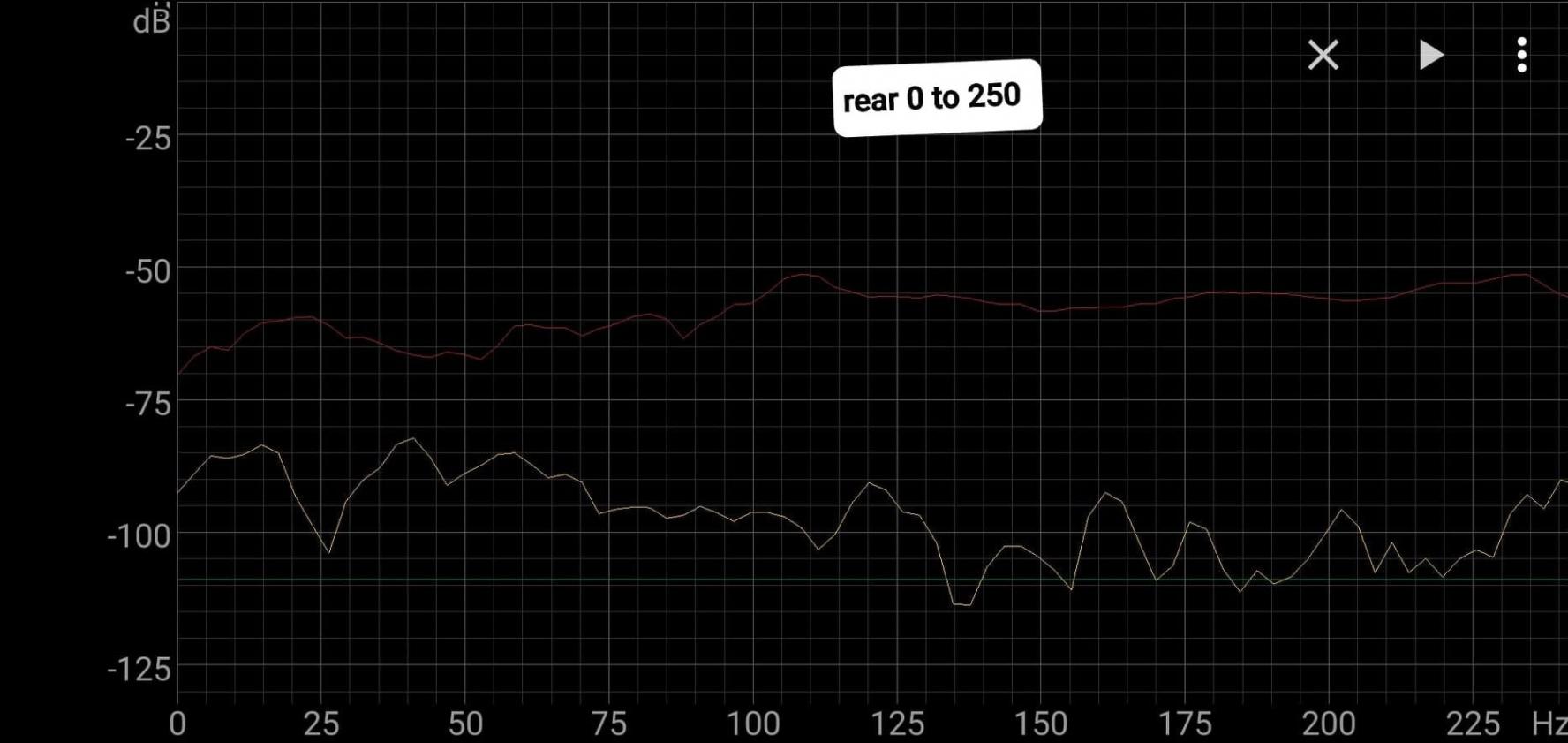

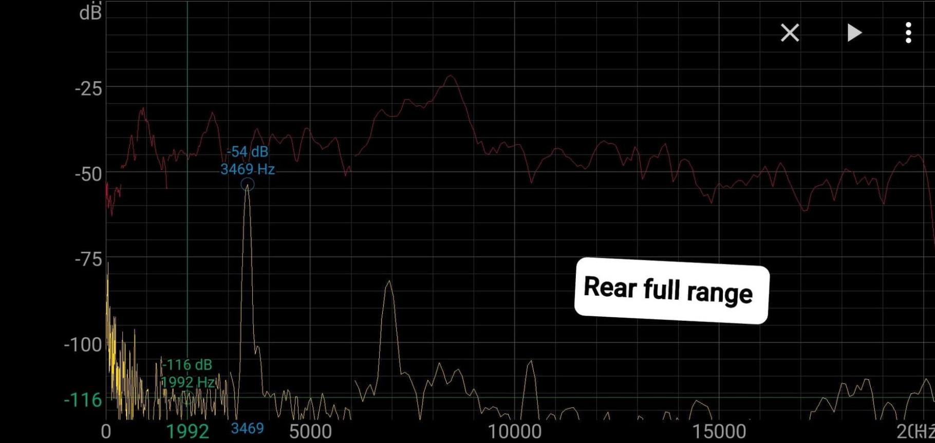

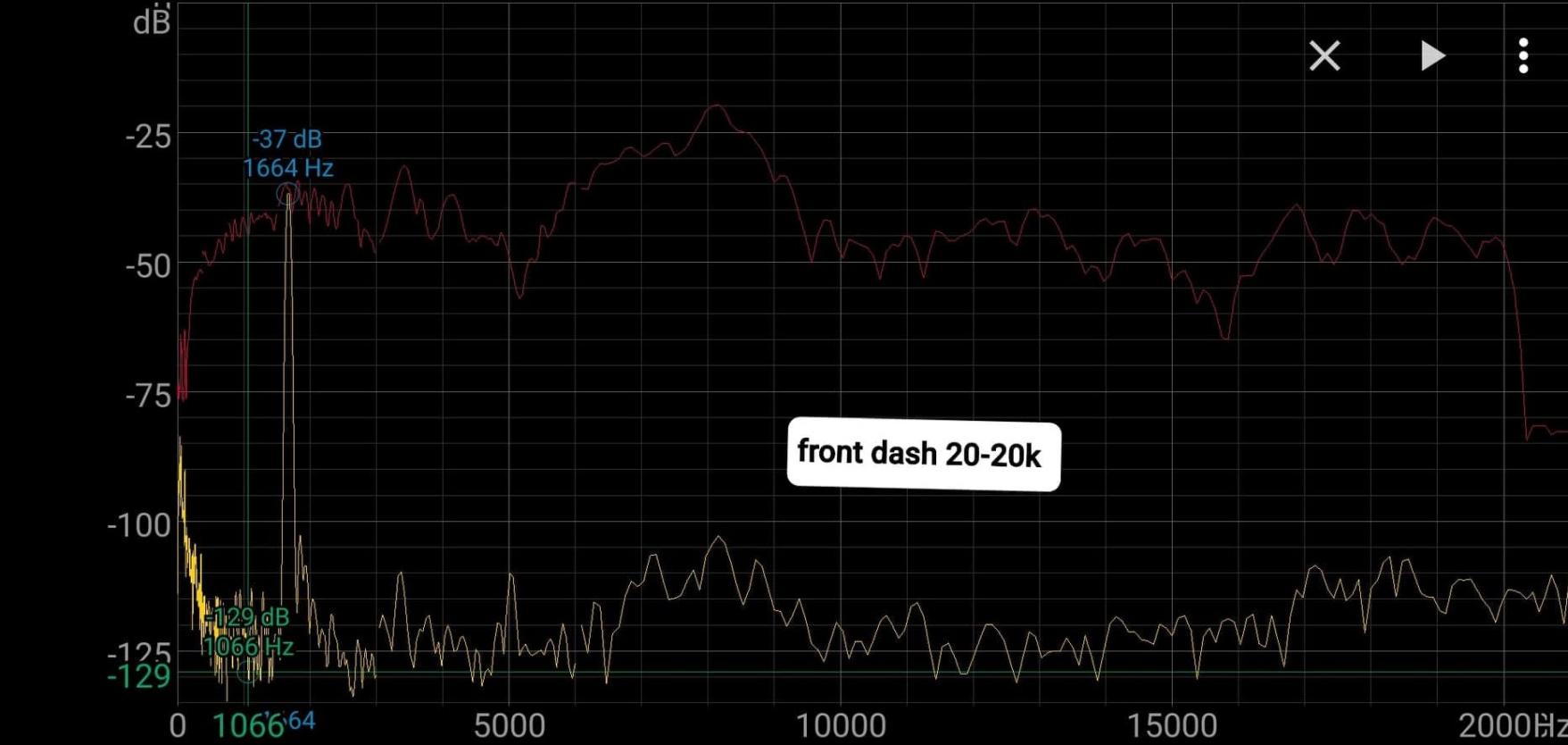

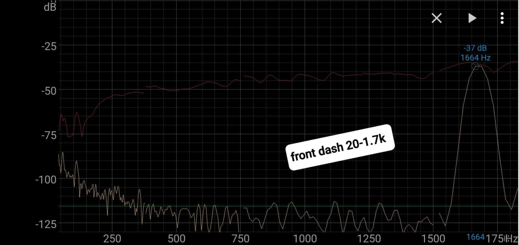

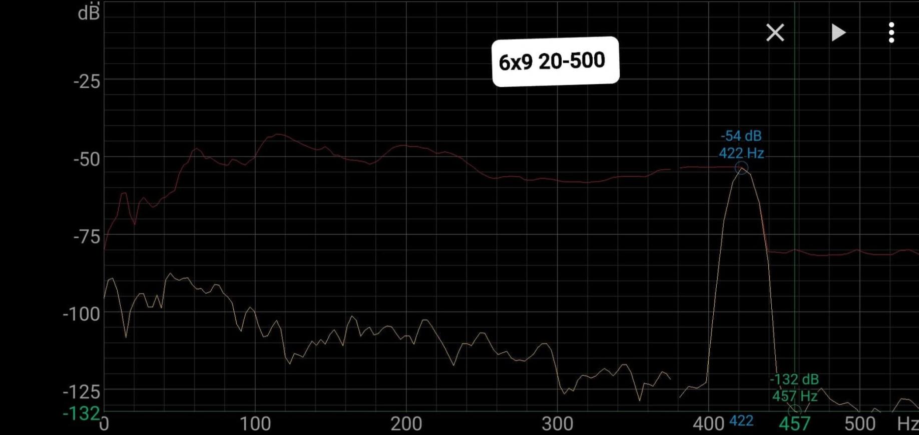

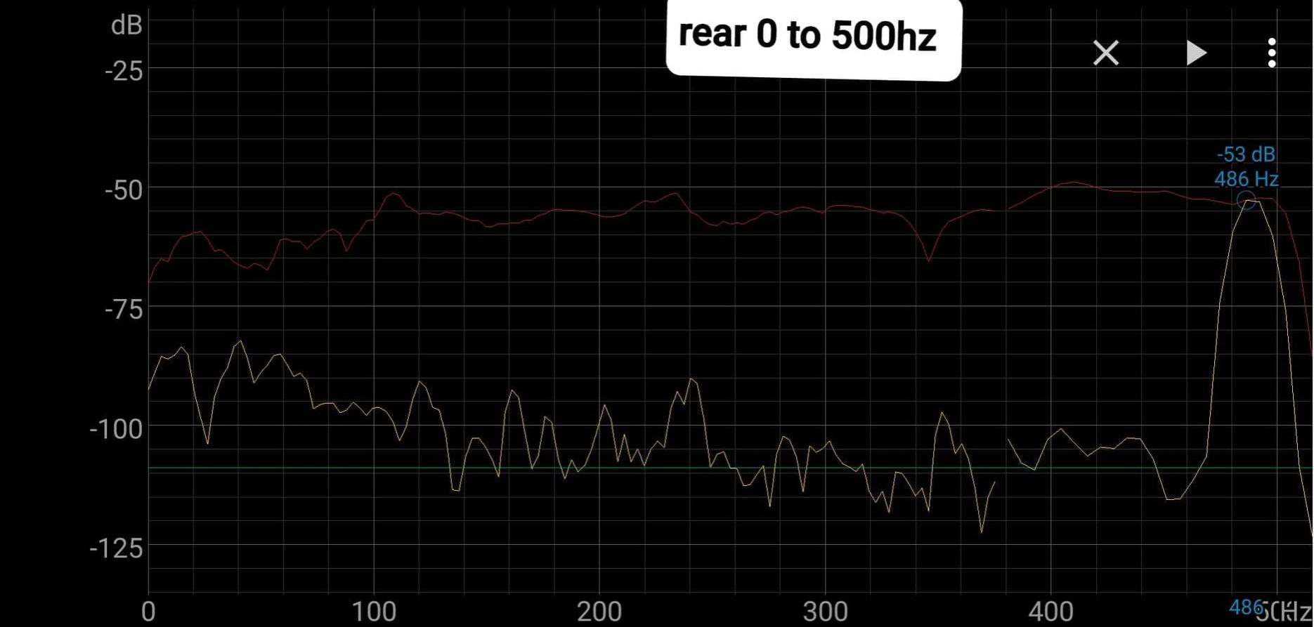

Acoustic profiles of each location ( near field measurements. RED LINE ONLY ignore the yellow.)
RED line is peak value with sine wave sweep; yellow is real time background noise at the time the data was freeze framed
this Qualitative and not quantitative data
Volume at 30
low/mid/hi all set to center value.
Data recorded at each location in with the fader/balance set to only drive that speaker
On the first graph JBL actually did a decent job of tuning for a relatively flat system response with a bump in the 6k-10k range... measurement taken at clock location.
all other measurements taken right at the speaker/driver.
note on the 6x9 I terminated the test at just over 450hz as the dash driver start to mesh with the recorded level I was recording right at the 6x9 ( despite covering the dash driver as best as I could. . Tells me the cap and or x-over for the dash driver is probably sized/set to be a 550HZ or 600Hz Hi pass at 12db/octave.

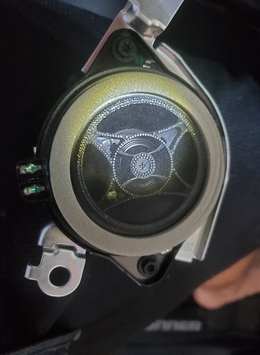

solution found .....
and just took the dash speaker out....it s a 2way was not expecting that...
AC DM-610
DM-608 | AudioControl
Tag OEM amp out puts to dash and front door +sub to ensure true full range signal
only retain OEM HU balance
use
AC DM-810.
DM-810 | AudioControl
to retain balance / fade with OEM HU
This dash speaker / coax matches my 2020 4Runner. If I understand correctly, there are 4 wires in the molex; a pair for the dash coax and a pair jumpered goes on to the front door 6x9(?)
