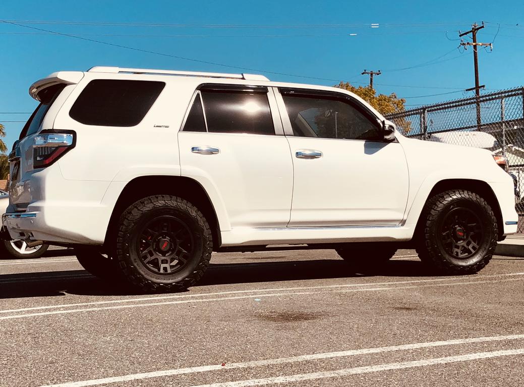

I have the same setup as yours. Fronts struts took a little more compression but it's doable. The rears ride a little harsh. I have the same tires and wheels and do not have any rubbing after the spacer install.

There are quite a number of people here who've installed the Daystar 2.5/1.5 lift and level kit on the Limited. I'll be one of those people as soon as I have time for the install. The Toytec lift is the same. Seems like your mechanic is being excessively careful, or just isn't comfortable with XREAS.

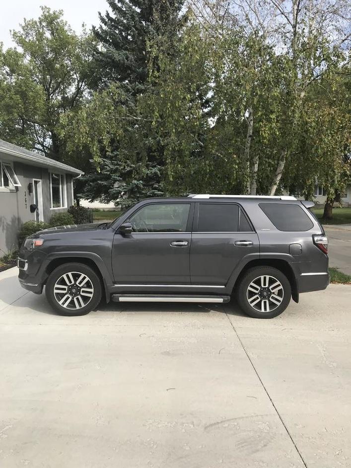

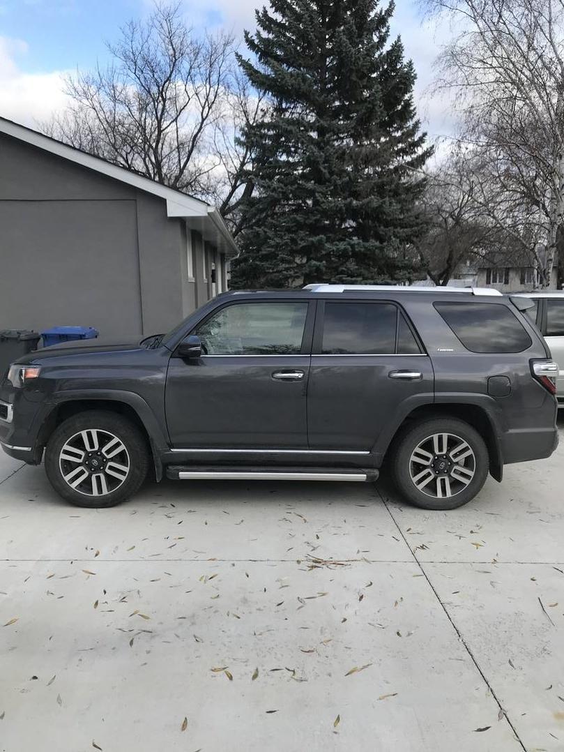

Just got my 2018 4Runner Limited with XREAS. Planning to level with Toytec 2” lift spacers for the front to keep my XREAS intact. Not looking for additional lift but just want to get rid of the stock “nose down” look. You all think the Toytec 2” spacers would be good enough?

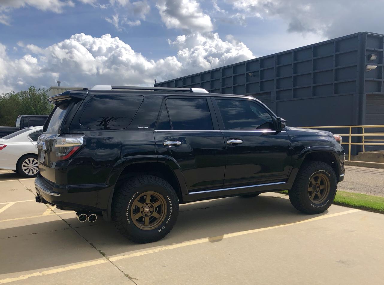

Good grief! I had my local shop install my toytec kit. That plus the alignment was less than $400! Hope you got it done. My 15 LE looks so much better with a little lift and bigger tires! Plus the front is level w the back.

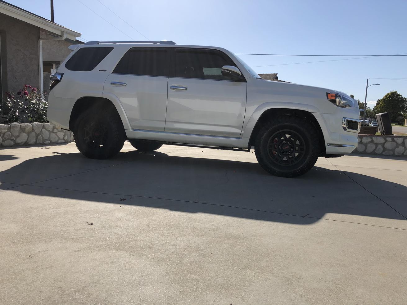

I installed a 1" front Cornfed spacer on our this past weekend, I can see how getting a thicker spacer on the front into place with the XREAS lines intact would be very difficult.
With the 1" spacer on the front only, it seems to drive and handle the same as before. Alignment and new tires go on today, should be good to go into winter!
Here's a before and after with the stock wheels.
What tires you putting on? Is it completely level now?
There's still about 1" rake with the rear taller, which is fine as I don't want it to sag when fully loaded.
I'm putting 255/75/17 Duratracs on 17" FJ Cruiser 8-hole wheels, should be ready by the end of the day!

I like your exhaust tip. Can you post a picture of the rear of your 4 runner? I just want to see how it looks with the bumper cutout.
