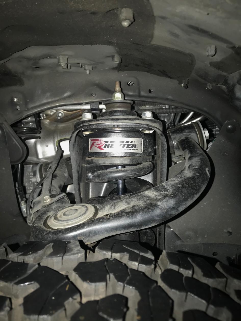

I just added the Revtek 3" front 2" Rear spacer lift to my 2019 Nightshade Limited :frog:and I am digging it, well once I was used to the slightly different handling.

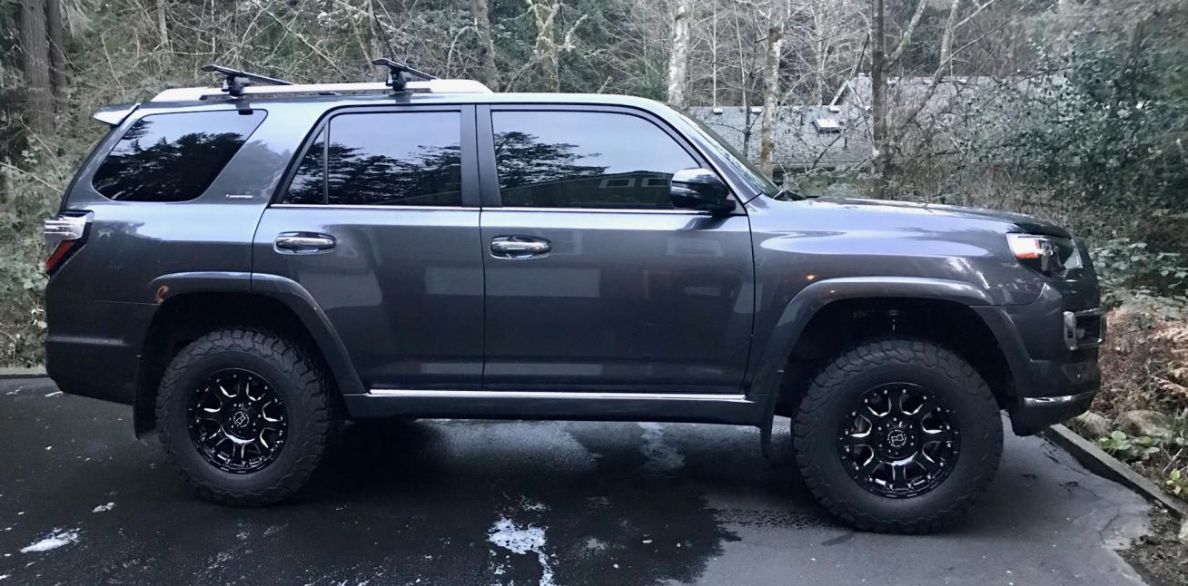

Me too! Well, almost. I can't leave well enough alone. I removed the 2" front spacer and installed the Revtek 3" front preload spacer. I left the 1" rear in the back. It sits level. Pics attached (4R is parked just slightly uphill).
