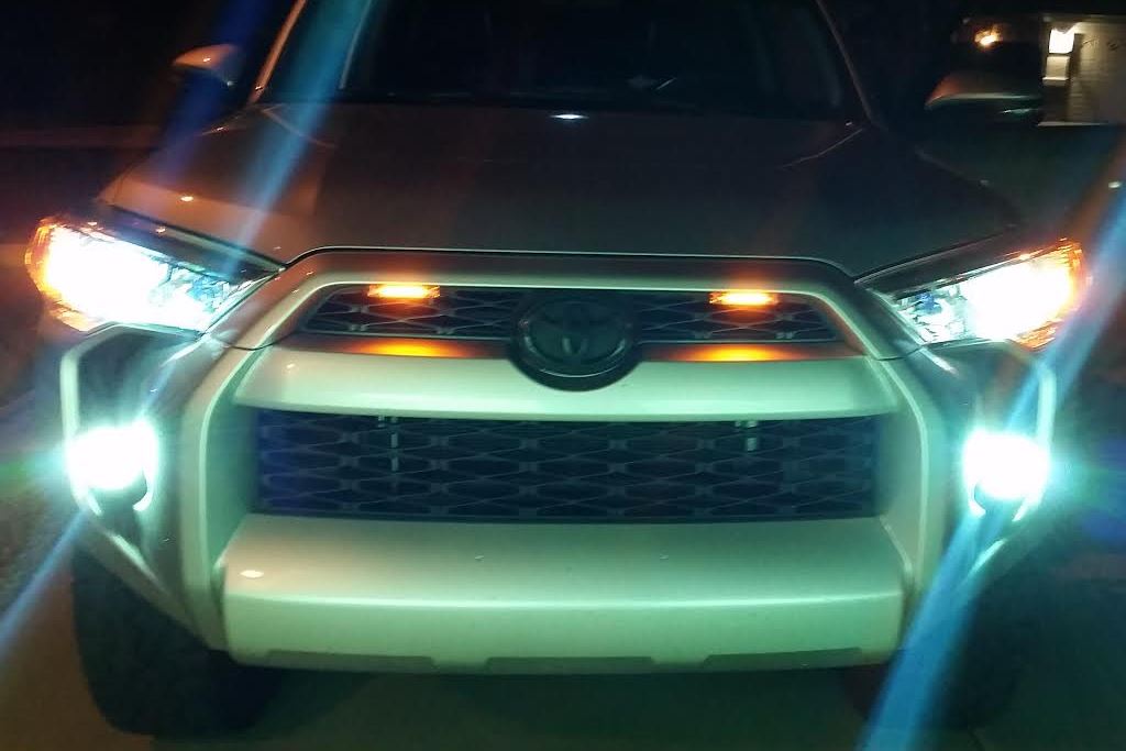

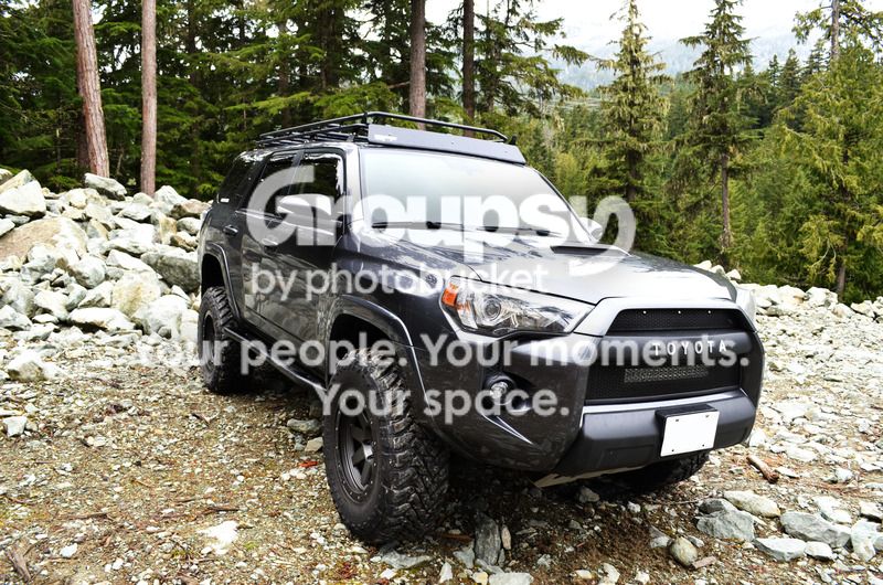

Hey there, didn't see a thread discussing this, nor can I seem to find much info at all, but I saw these marker lights that look pretty sick on the runner. Wondering if anyone knows which lights they are/how to get them wired up? Thanks in advance
They just look like cheapie universal amber led markers. Should be able to find something on eBay or Amazon.
As for wiring, I'd either tap the marker light cct so they flash along with your signals, or maybe they'd be cool to just come on with the DRLs or headlights. Personal preference, really.
Maybe 3 little subtle oval LEDs might look cool too. Raptor-esque.

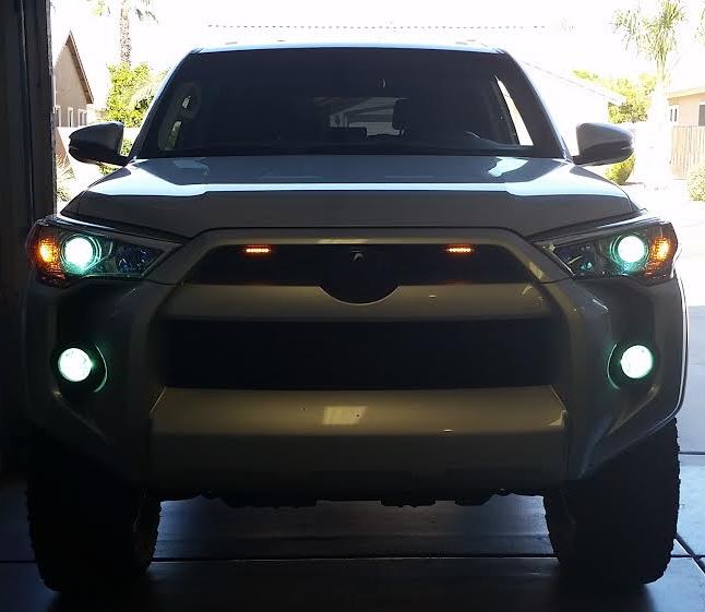

I'm running these flea-bay LED lights as markers in my grill. Don't know how long I'll keep them. I go back and forth on how it looks. $10 or something. Search Amber eagle eyes. Wired directly into the turn signal wires.

That looks sweet too! Didn't think for it as a blinker, thought it might be cool just as a semi truck kinda look. Any suggestions on more elongated lights?

Definitely like the raptor idea, but be on wit drl's and headlights. Would wiring them with the drl's solely do the trick for this?
I was thinking something like these:

I have Amber Rigid lights on my rig too I may wire in if k decide I don't like the angel eyes. There are tons of options like that tbh. Rigid are a bit spendy for just turns but they are damn sexy.
What color wire do I tap for DRL??
Bringing back an old thread here...
But I just ordered 4 amber marker lights to run in my grille, i'm planning on wiring them to come on with the DRL but I'm not sure which wire to tap into...
I'm going to use a "T" tap into which ever wire the DRL connects to, and run the ground to the chasis.
Has anyone else done this? and if so what color wire should I tap for DRL?

He colored ones in the wire kit. There is a blue on the passenger and green on driver for hot. The other is white with black line.
Thanks! that's exactly what I needed to know. I will tap the positive to the green, drivers side wire directly behind the light somewhere. And negative wire just grounded to chasis.

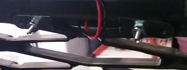

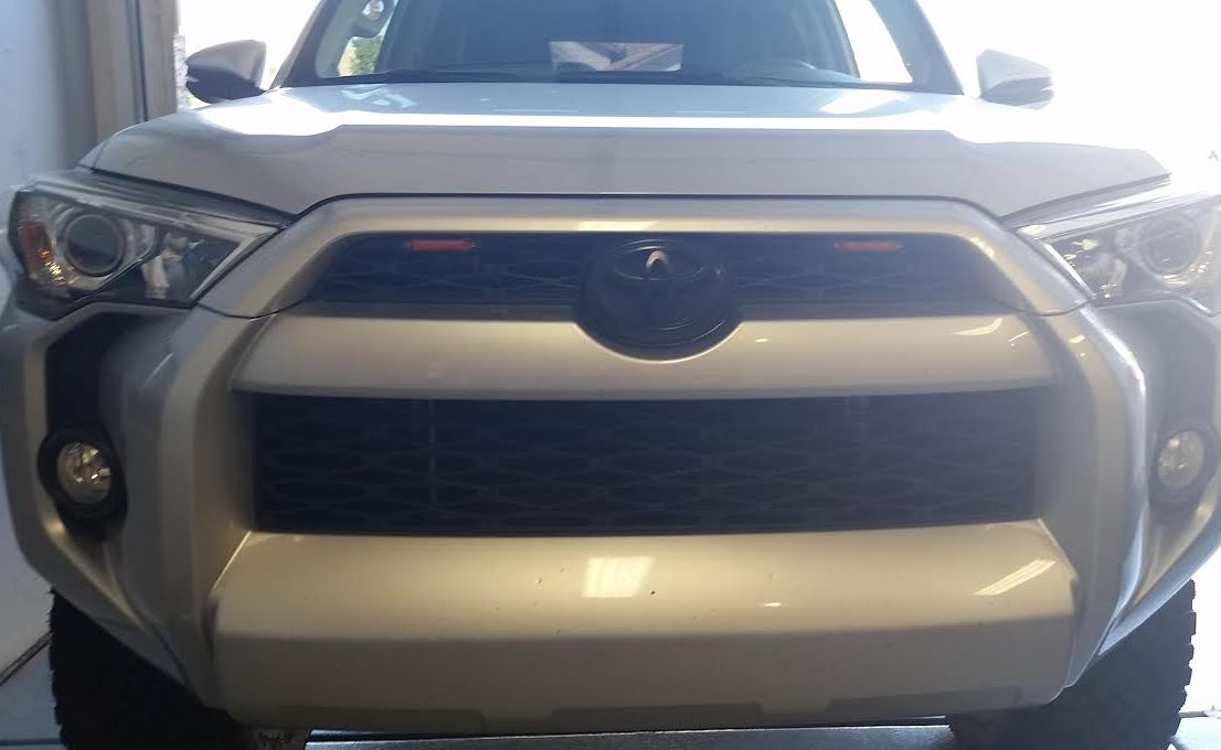

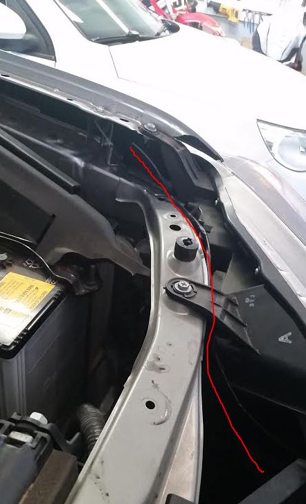

I completed the install and i do like the way it looks. It was a slight PITA but worth it. See previous post abt parts.
Feel free to ask if you have any questions.

Wow I am late to this feed! the pics you found are my rig [MENTION=123371]fargo4x4[/MENTION] lol
below is the link to the lights i used
http://amzn.to/1JCUIxl
Basically tapped into the headlights and ran a wire to a relay that turns on when headlights are on (not DRL or blinkers) although if you prefer that you can wire it to them as well but anywho i then put a little home depot bracket behind it fastened through the grill.
Hope that helps!
