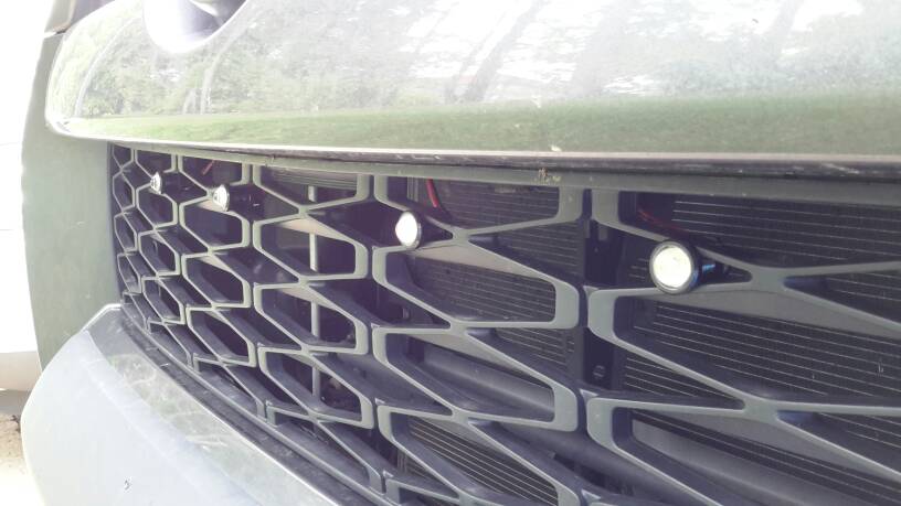

[MENTION=107277]GU4runner[/MENTION],
Can you get us a close up photo of the mounting of one from the front and back, so we can see how they are mounted?
I imagine you just daisy chained the wiring...correct?
Thanks in advance! :D
Correct on the daisy chaining. I'd be happy to post up a front and back shot. Won't be able to get it till tomorrow sometime though due to rain and enough light.

Would have tried to upload a pic earlier, but I where I work they don't allow electronics and I completely forgot to at least bring my phone with me to leave in my vehicle like I usually do. Luckily I had my tablet and was able to snap a quick pic so you don't have to wait too long. The light are essentially a bolt with a nut attached to them. I just wedged each light in the corner of each part that i mounted them too and tightened the nut in the back of the grill. So far it's been sturdy and has not moved at all. Even checked them after my short wheelin trip this weekend and had no issue. I'm planning on cleaning the wiring up a little in the future because right now I just have all the wires routed with zip ties and the little stickies that you can run the zip ties through. If the lights ever become loose, I was thinking about grabbing a really thin piece of metal from Home Depot to put behind the grill and then just mounting the lights on the so they will sit deeper into the grill. If you still want me to snap a quick pic of behind the grill with the wires and everything [MENTION=103267]Saker[/MENTION], just let me know and I'll do that as soon as I get home.
