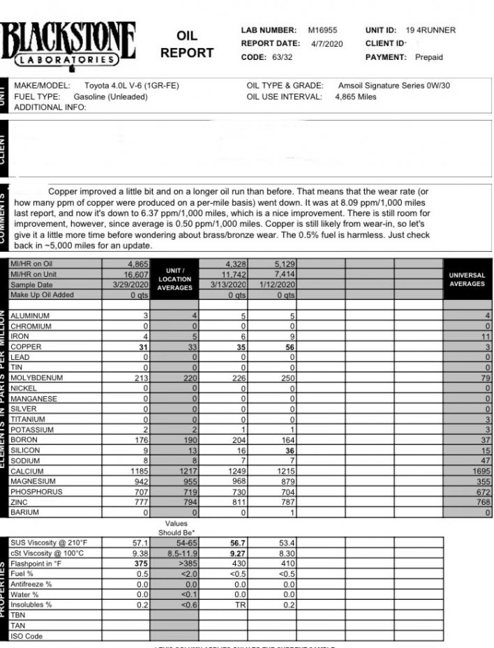

nice report but only 4300 miles on Signature Series stuff....you drained it way early! any particular reason for doing so or were you concerned you'd still be seeing a lot of break-in material? you could more than double that run, between the high TBN and stable viscosity that blend is known for.
I dumped it early because I was going out west, totaled around 4800 miles round trip. I know the Amsoil can handle it but I wanted fresh oil just for peace of mind; light off road, over landing in the Utah desert, over the San Juan mountain range in a snowstorm, all while maxed out on GVWR. The rig ran great but did struggle in the higher elevations.

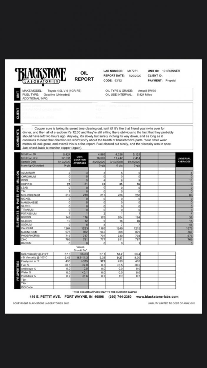

Check out the UOA! Not bad considering the oil got worked hard.

roger that, fair enough. UOA looks great, thanks for sharing! super low iron, if you're under 1ppm per 1000 miles that's impressive. most 4Runner UOA's show 2-3 ppm per 1000. iron is your valvetrain, timing chain...anything steel. given you probably had to drop an extra gear and climb the RPM's up at altitude that's great wear.
your copper and aluminum will keep dropping and level out at around 30-40k miles. that seems to be where most 4Runner UOA's show those values stabilizing and indicating its actually broken in.
i think you found your blend! i'd go ahead and run that 8-10k with confidence from here on out :beer: i might even pick some up for myself sometime...

Not every oil change, I wanted to see how the engine liked the 30 weight oils. Ran two 0w30’s back to back and currently running the Amsoil 5w30 and the engine Loves it, UOA’s look good.

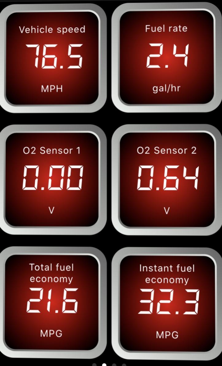

Check out the pic of my gauges!!!
Not sure how much fuel loss I’m getting with the 5w30, but I’ll take 21.6 MPG’s cruzing at 75 MPH LOL:hatsoff:
This was today from Georgia to Florida about 500 miles. ENGINE is Butter Smooth.

at 75mph, i'd take that number all day and twice on Sunday

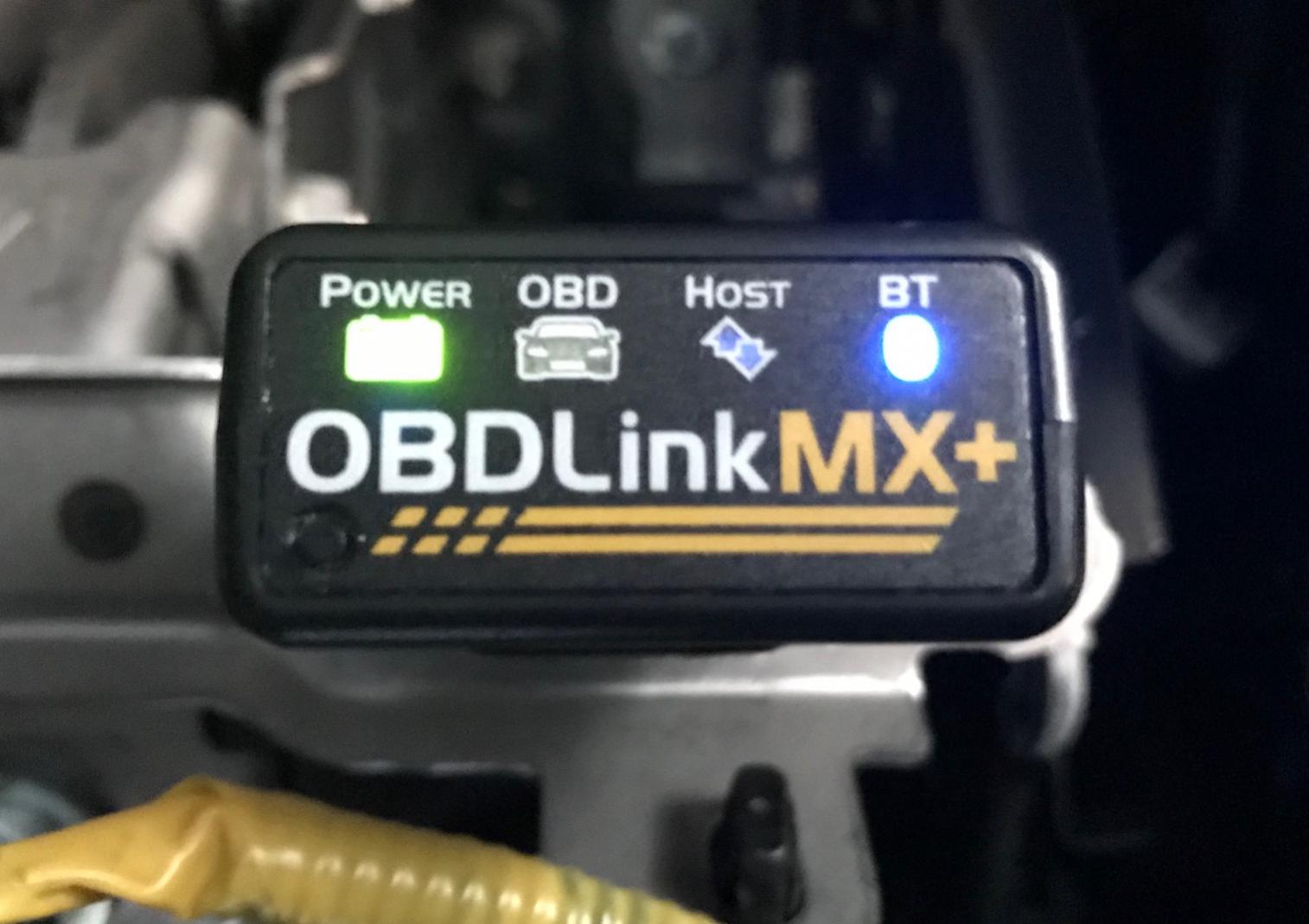

What app are you using for those numbers?
Nice! These engines are specified for thicker oils overseas, not surprised it is doing well for you.
I snapped a pic for ya. I got it to monitor my engine oil temperature, transmission temperature, coolant temperature, air intake temperature and battery voltage. But it has Hundreds of options for monitoring so it’s very versatile. And it can read/clear trouble codes.
