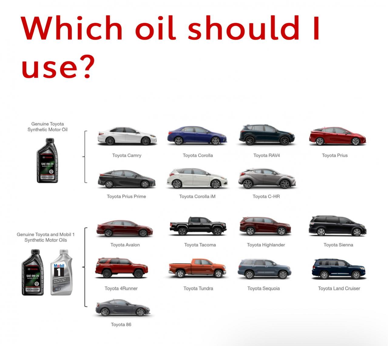

Every dealer service bay I’ve ever seen pulls their oil from a 500 plus gallon drum of who knows what brand oil. I’ve yet to see a dealer use oil out of a Toyota branded bottle. It’s just whatever bulk oil they get. Maybe the dealer you work for is different, who knows.
Yeah they contract with a local distributor. You can usually tell from signage around the shop or the windshield sticker or even on their website. I would expect these distributors can also supply TGMO.
Flyers Energy Dist has taken over around here
Mobil Lubricants - Mobil Oil Products Distributor
Here’s what my local dealer’s webpage looks like.

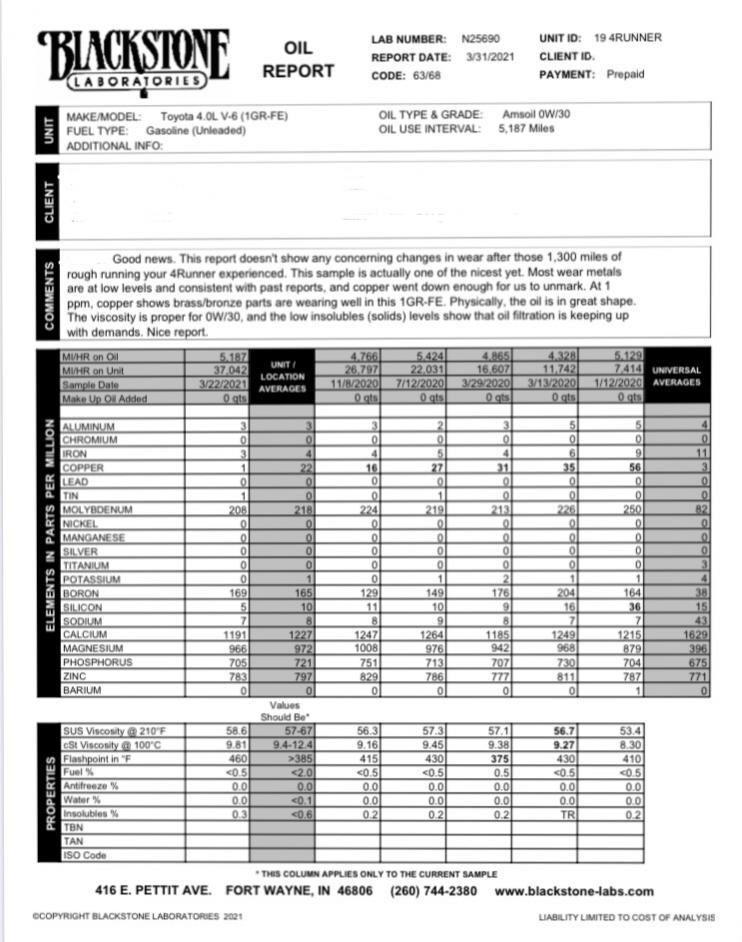

Did 5000k+ miles in 13 days out west wheeling and back to Florida and dialed in a Fantastic report. Had low octane gas for about 1300 miles and the engine ran poorly but it didn’t have any negative affects. I must say this report really surprised me; bad gas, a vicious head wind and loaded down with gear at elevation put some severe duty on the engine and transmission but all is good under the hood.
incredibly low iron (steel parts) wear. flashpoint looks...bizarrely high, but blackstone isn't known for accuracy on that and its not an issue with our engines anyway.
you could easily extend your changes, but otherwise do nothing else different and drive it as hard as you want.
