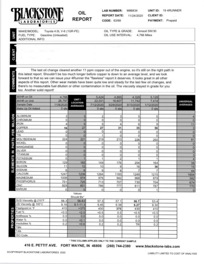

Another Amsoil SS UOA, this was 5w30.
solid report. really low AL and iron and the flashpoint is really really high which is great.
i wouldn't sweat the copper one bit. on a lot of the UOA's i've seen for these trucks it doesn't truly level out into the single digits until around 35-40k miles sometimes. its on a downward trend and that's all that matters.
stayed in grade fairly well too. i'd just keep doing what you're doing, all your reports are showing great numbers.

Here is the latest oil report using a 30 weight oil; all is good. Acceleration is smooth and overall really happy with my decision to move up in oil weight.

nice report. copper's coming down just like it should with more break-in miles, should be gone by 40k judging by other reports i've seen. if you're keeping these engines at or under 1ppm iron per 1000 miles i'd say the oil's doing an excellent job particularly on an engine with a big steel timing chain like ours. great looking flashpoint too.
no idea what your usage case looks like but my only nitpick is you're draining that pricey Amsoil at half its useful lifespan! its a very thin 30 weight judging by the 100cSt but it seems to be doing the job well.
Thank you sir, things are coming along nicely. Definitely on the thin side for a 30 weight. I know the oil can run longer but i cant get comfortable with the 10k interval.

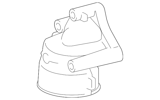

I put aluminum housings on both of mine at their first oil change with I did at 2000 miles.
IMHO Aluminum filter housing in contact with aluminum cylinder block may be not best as many people over-torqued housing, and eventually thread in block may be compromised. broken plastic housing cheaper to replace than block.
Oil filter housing does not thread directly into the engine block. It threads into an oil filter bracket, which is replaceable. The part number for my vehicle is 15671-31040. Camelback Toyota sells it for $107. Amazon sells it for $97.
