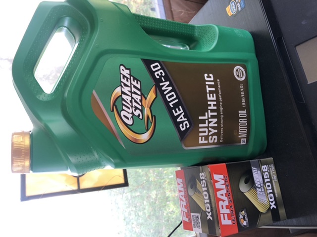

Thats a fantastic report, nice to see the 4R eat that 0w40 with ease. I'm running my first 10w30 in QSFS and she's a happy girl; I'll be running the 10w30 for most of the year from now on. Engine liked the 5w30 and 0w30 just fine but the 10w30 is even better. Super happy!
Running Fram's ultra synthetic filter also, I'll report back on what I think about it. Seems to flow better but that could be my wishful thinking.
Fram's XG filters (ultra synth) are top notch and nothing like the cheap trash-tier orange filters that gave them such a well deserved bad reputation. it'll probably be 100% fine for you.

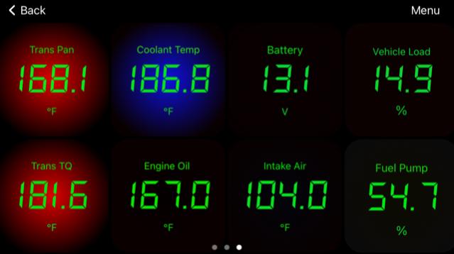

I think I got the same OBDLink devise to monitor all my fluids; just curious how you got your screen setup? I really like the piece of mind I get from being able to monitor all my fluids on the trail or long interstate driving.

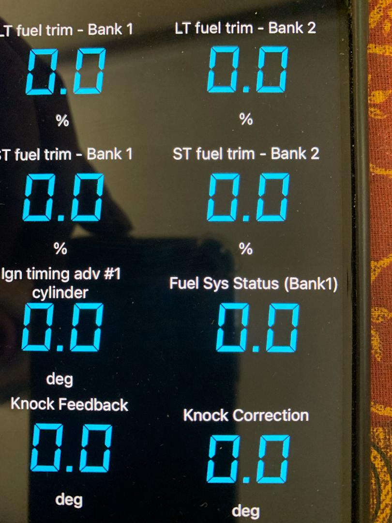

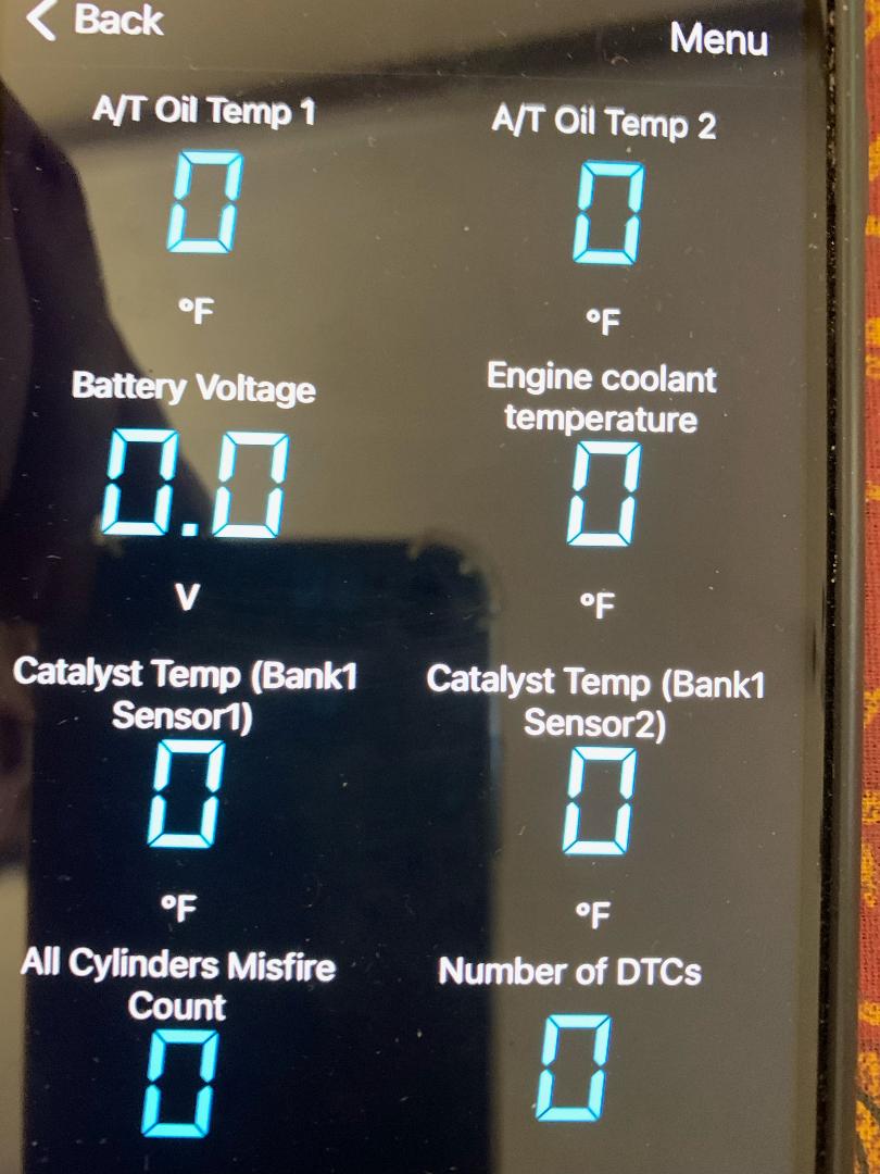

I have the OBDLink MX+ and I like it. Display data is similar to yours as well as some diagnostic data, such as catalytic converter temps, all cylinder misfire count, diagnostic trouble code count, short term fuel trims, long term fuel trims, knock data and tire pressures. YouTube videos explain how to diagnose rich or lean conditions using fuel trims and oxygen sensor voltages. I hope I'll never have to dig that deep into a diagnosis, however it's there if I ever need it.
