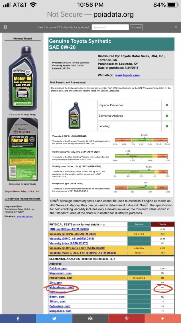

They changed it by adding MORE moly.
See discussion here...
PQIA Toyota 0w20 results are something!! - Bob Is The Oil Guy
If you live near Madera California you can get it for $5.06/qt but they will not ship.
002790WQTE01 - Toyota 0w20-single quart (w. Oil, motor, maintenance, fluids, filters | Madera Toyota, Madera CA
Good so it still contains the 787 PPM of Moly. That is unmatched by anything else off the shelf so that is what I will continue to use even though I don't like the $7.00+ per quart locally which is about the same as online.

Very interesting, thanks for locating this. It shows that just about any major brand oil is OK with proper oil change intervals. I wonder if there is a tabulation of 2018-19 0W20 formulations to be found.
On the PQIA site if you look at the most recent M1 AFE 0W20 and compare it to the 2013 M1 10W30, the additives look about the same. And if you compare the most recent M1 AFE 0W20 to the most recent Toyota 0W20, likewise, the additive packages look very similar, except for the molybdenum. Toyota must use M1 and tweak the formula; add a little more calcium and magnesium, and a whole lot of moly. So for those of us with OCD we all can take comfort in using M1 AFE in place of Toyota oil.
