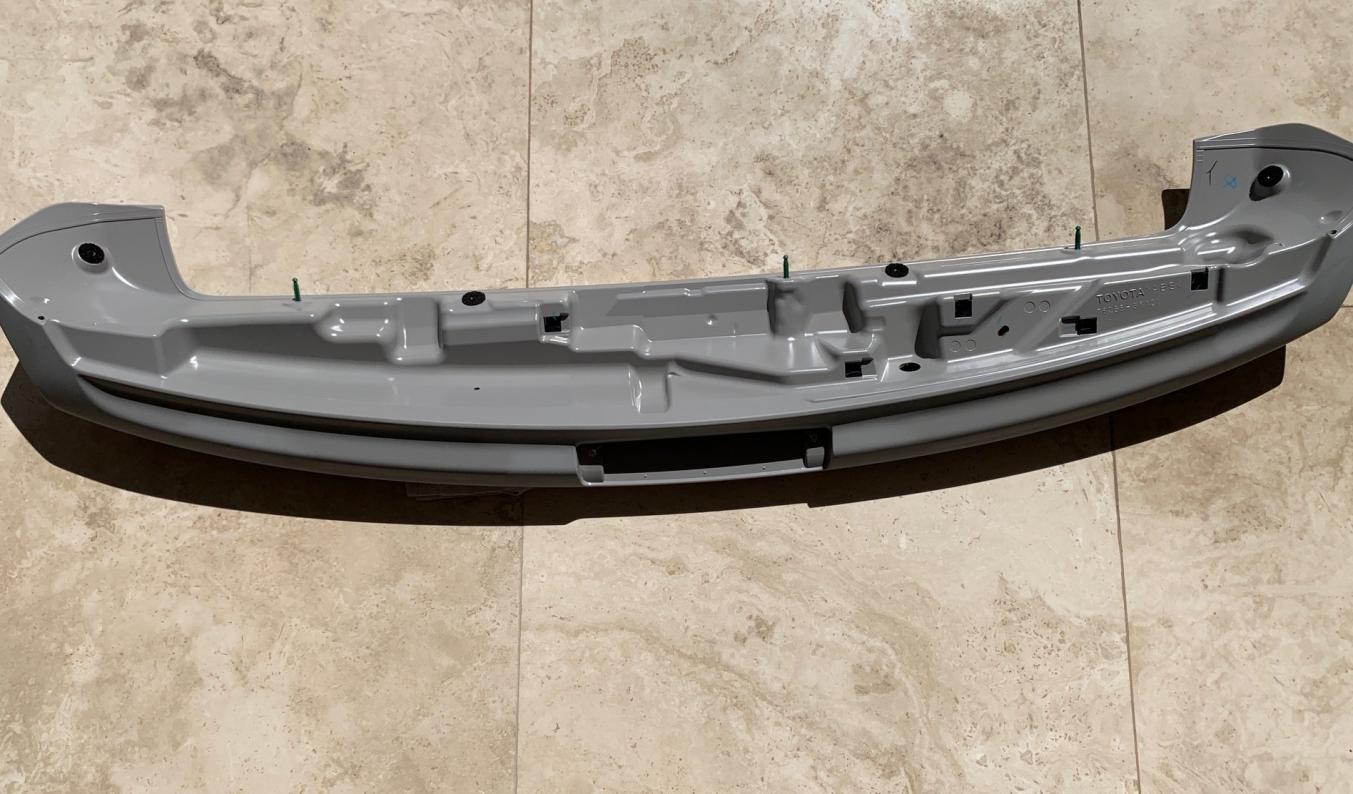

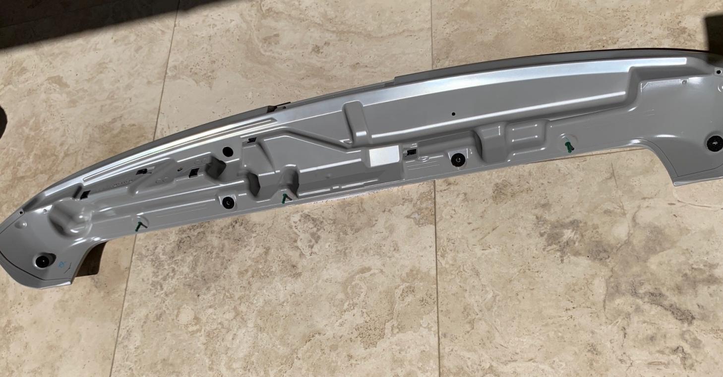

Here's a couple of pictures of the spoiler.

Wife smashed mine backing into a tree branch and when I installed the new one I laid a bead of silicone around the perimeter where the marks are for the crappy, thin felts........nice and cushy and no rubbing! ( and the crummy felts are obscenely priced!)

Those are the green locating pins and I didn't break any pulling it off.......pull evenly and straight out and work your way around slowly. They pushed back in perfectly and tight! They are strong, and you think something is going to break when you pull the spoiler off!

What I was asking about is the retaining clips - there should be 5 of them and slid in to the areas circled in red on the attached picture.

Thanks, it looks like the best way to remove (after removing the bolts) is to push up on the spoiler to release the retaining clips and pull the spoiler straight back.
