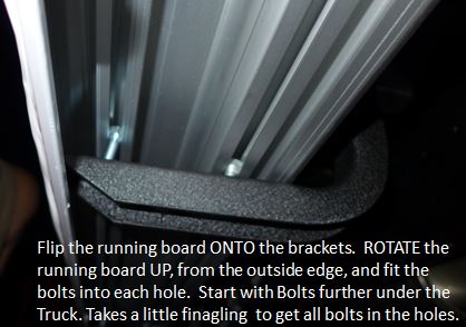

2013 Running board Ordering and Install. Installed onto SR5 4runner WITH mudflaps. (cleared mudflaps just fine). Hope this helps you.
1) Ordering:
Ordered these: Toyota OEM part: 00016-89040, 4 runner running board, short. Found them for $308 delivered.
Details: Original Toyota Running board: Nonslip on top, aluminum core, rubberized end caps, and nifty rubber trim that tucks under the car.
Found them on Ebay with this search: 4runner running boards OEM new 2010 | eBay
Also found them here:Toyota of McDonough Parts ? 00016-89040 Toyota 4Runner Running Boards 2010 - 2013
There are instructions on-line here: http://cdn.shopify.com/s/files/1/0176/5842/files/00016-89040.pdf?3
Tools:
1/2in drive, 12 mm and 13mm socket.
1/2 in drive extension.
Install:
See Pictures below:
Tips:

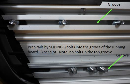

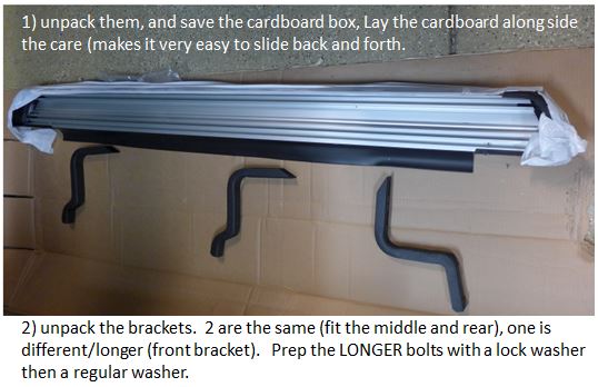

-Lay the cardboard from the running board next to the car for install.
-LONGER bolts/Washer/Lock washer are for BOLTING the new brackets to the CAR. SHORTER bolts slip into the slots on the running board, hold the running board to the brackets.

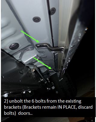

-Bolts removed from the truck are discarded and replaced with new ones.
-The rubber seal attached installs TOWARD the vehicle, and slips under the vehicle edge.
-1/2" drive with 4" extension (no ratchet at first) was the easiest way to get the bolts started in the holes.

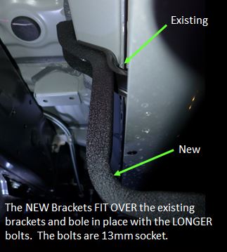

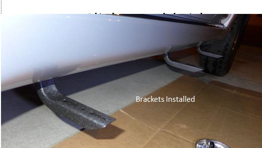

-NEW Brackets install OVER the existing brackets, and are bolted with NEW longer (30mm) bolt/washer/lockwasher).

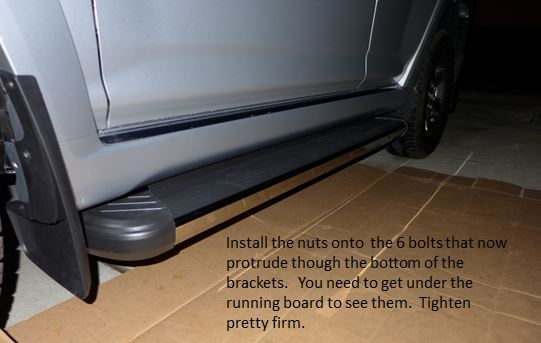

-Once all nuts are installed on running board, you'll notice it can push the running board IN OR OUT, I pulled mine all the way out, then tightened.
-The running board can slide LEFT or RIGHT before tightening. I aligned the rear edge of the running board with the edge of the fender. This gave about 1.5: clearance on the FRONT between the running board and Mud Flap.
-Good Luck. Pretty simple install, need to be patient.

Also - in step 2 above - you are told to remove bolts from existing brackets. I have a 2014 4Runner SR5. The are bolts where you see them above, but no existing brackets anywhere along the underside?

If you have a 2014 4Runner SR5, you will not see the "existing" mounting brackets underneath that are displayed above in the first post. Neither Dee Zee nor Westin make boards for the 2014 either. It would seem they are going to have to include the "existing" brackets that Toyota did not include on the 2014 4Runner SR5 or come up with a whole new design . Not sure what Toyota did on the other 2 models.
thats because the 2014 with a TE style rocker. Only the limited retained the fiberglass rocker like the 10 - 13 SR5/Limited. The "existing" bracket is the bracket that holds the rocker on. Your best bet is NFabs. Personally I like them better than mine
