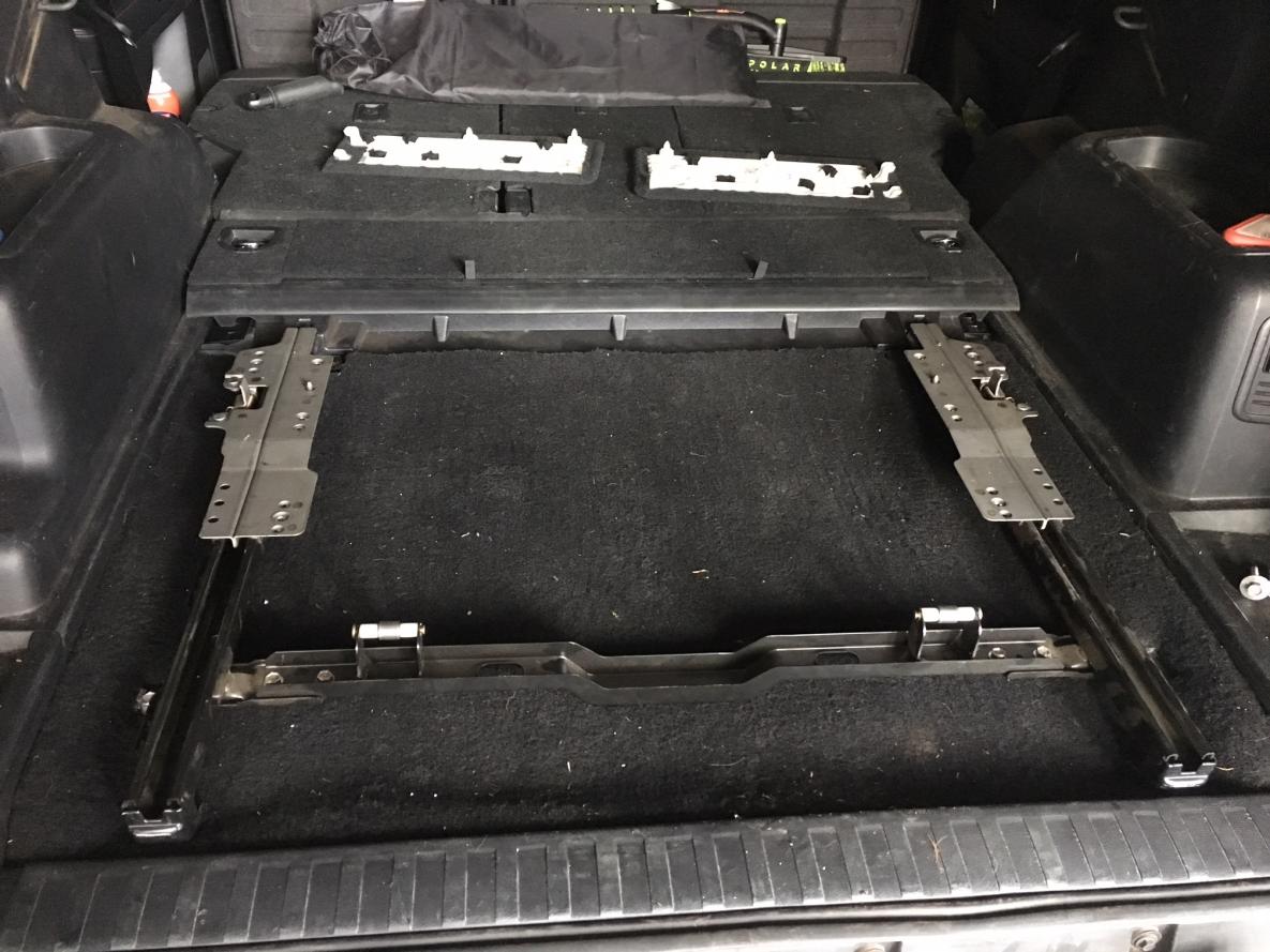

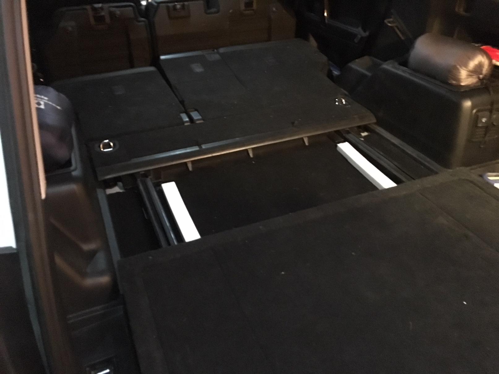

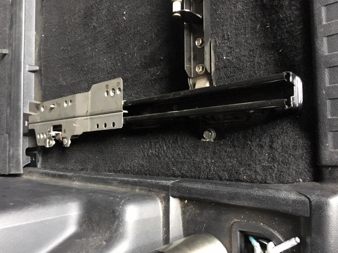

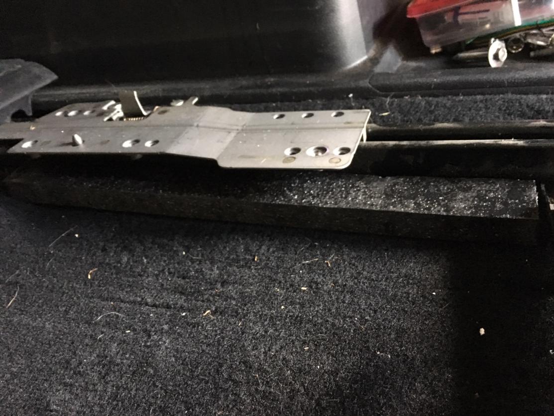

Here are photos in progress. You can see the not-so-straight edge of the carpet against storage cubby that I cut while it was in the back of the 4Runner. You have to cut off 3-4" as it otherwise extends over where the cubby goes with the tray, and you need to clear the front bolts into the floor pan. It would have been tidier to measure in place and remove it to cut, but I didn't really care since it is generally covered anyway and I'm a bit impatient with those kind of things. You can see the test fit of the white strips of Styrofoam in the last shot, then spray painted black to blend in more in the third photo. They have a strip of velcro tape on the bottom to hold them in place. I'm not sure they accomplish anything, but I'm thinking Toyota put a barrier in their version for a reason - to keep things from rolling into the mechanism and jamming it. You can see the bolt on the outside of the mechanism in shot two - that is the one you have to drill for and it's also the location you need to cut small openings in the stock flat-floor carpet.
Anyway, that's it, I now have the cargo tray I have wanted since day 1, and not having the oem carpet that accompanies it was not a barrier to installation. Also on a side note, you really don't lose much cargo capacity with the tray over the flat load floor. The oem Styrofoam tray under the flat floor carpet is really thick, it's absence is what gives storage capacity under the tray. I haven't really driven it anywhere since install to see if is noisier with the Styrofoam gone.
