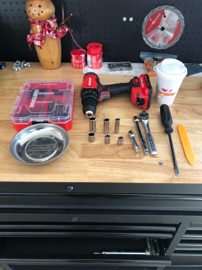

Tools wise:
- Socket wrench with 10mm, 12mm and 14mm drivers (i.e. the 3 most used drivers on a Toyota)
- Flat head screwdriver (the larger the spade the better)
- Drill with 2-3 bits ranging from 5mm to 10mm in size
- 1 beer or coffee depending on time of day (or something else if you don't like the hard stuff)
