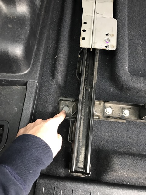

Just managed to pick up a tray set-up to swap out my 3rd row. I was able to remove the third row and realized that I do not have tie down mounting points for the storage box. These guys:
237691d1486321760-5th-gen-sliding-cargo-tray-install-pics-steps-102-jpg
Does anyone know if this is a drill through the sheet metal situation? Are there weld on washers under the body? With removing the seats, I actually already have this hole:
238782d1486910457-5th-gen-sliding-cargo-tray-install-pics-steps-114-jpg
I'd much rather drill two template holes than 4 flying blind. Anyone have any experience here?

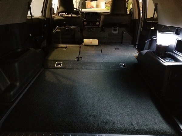

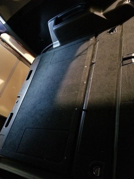

Thank you so much for making this guide! I bought all of the cargo tray parts from [MENTION=422636]JeuTheIdit[/MENTION] and [MENTION=636690]cjalexander[/MENTION] installed it for me over the weekend.
The whole process took less than 2 hours. Carefully drilling to expose the mounting points was the most time consuming step.

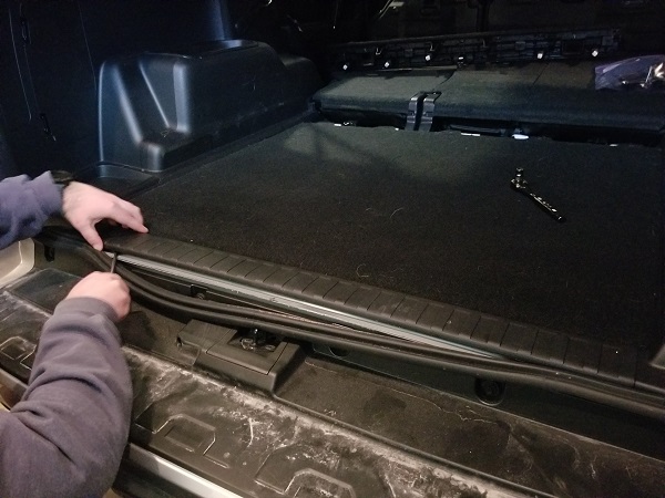

I thought I would point out one small difference we noticed for my 2021. The trim piece you lift to unclip the carpet cannot be fully removed, it is a one piece construction with the side hatch trim. cjalexander was still able to access the clips fairly easily. A picture is included.
