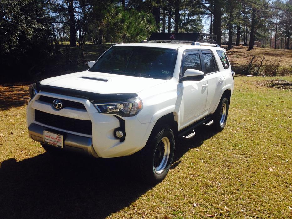

Thanks. My choices in Trails on the lot were Super White or Magnetic Gray. I seem to have a bent for white vehicles, so there we went. If you stayed with your factory rims you may not end up with a rub. I have what is almost exactly the same tread pattern on those Grabbers, on 9" wide wheels with 4.5" offset. So most of my width gain is pushed out. I think that is where you get into rub problems. I wanted the wider stance so I did this knowing I might have some rub. My left front tire does have a slight rub in reverse at full right lock. My right front looks like it will be fine. Looking at the inner fender wells the driver's side looks like it sits closer to the tire and the passenger side looks like it already has a bow in it. So I'll be doing the fender well mod to the driver side, and trimming maybe 1/4" from the inner lower lip of the fender. I'll have to play with it some off road before I trim anything else.
I have to admit Super White is difficult to shoot in bright daylight. I don't have the camera skills to get a decent picture....... :dammit:

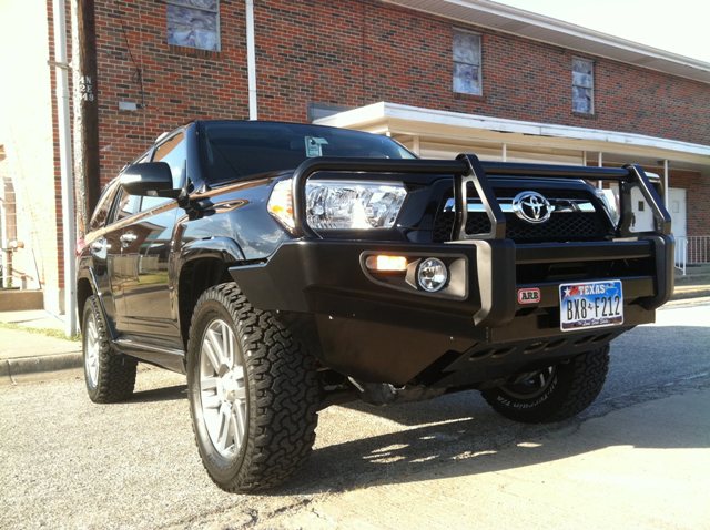

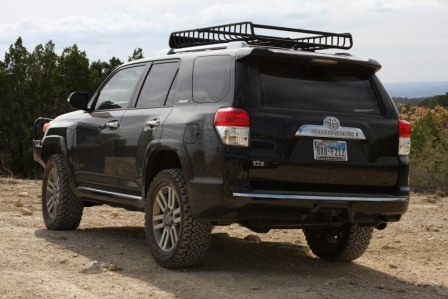

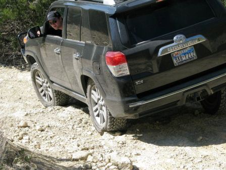

I am running 285/55/20 BFG A/Ts on stock 20" Limited wheels. Love them. At first, there was a bit of rubbing on some of the plastic up front, but the tires won that battle :).
I did install Bilstein 5100 adjustables to help support the ARB bumper on front and to level the truck.
