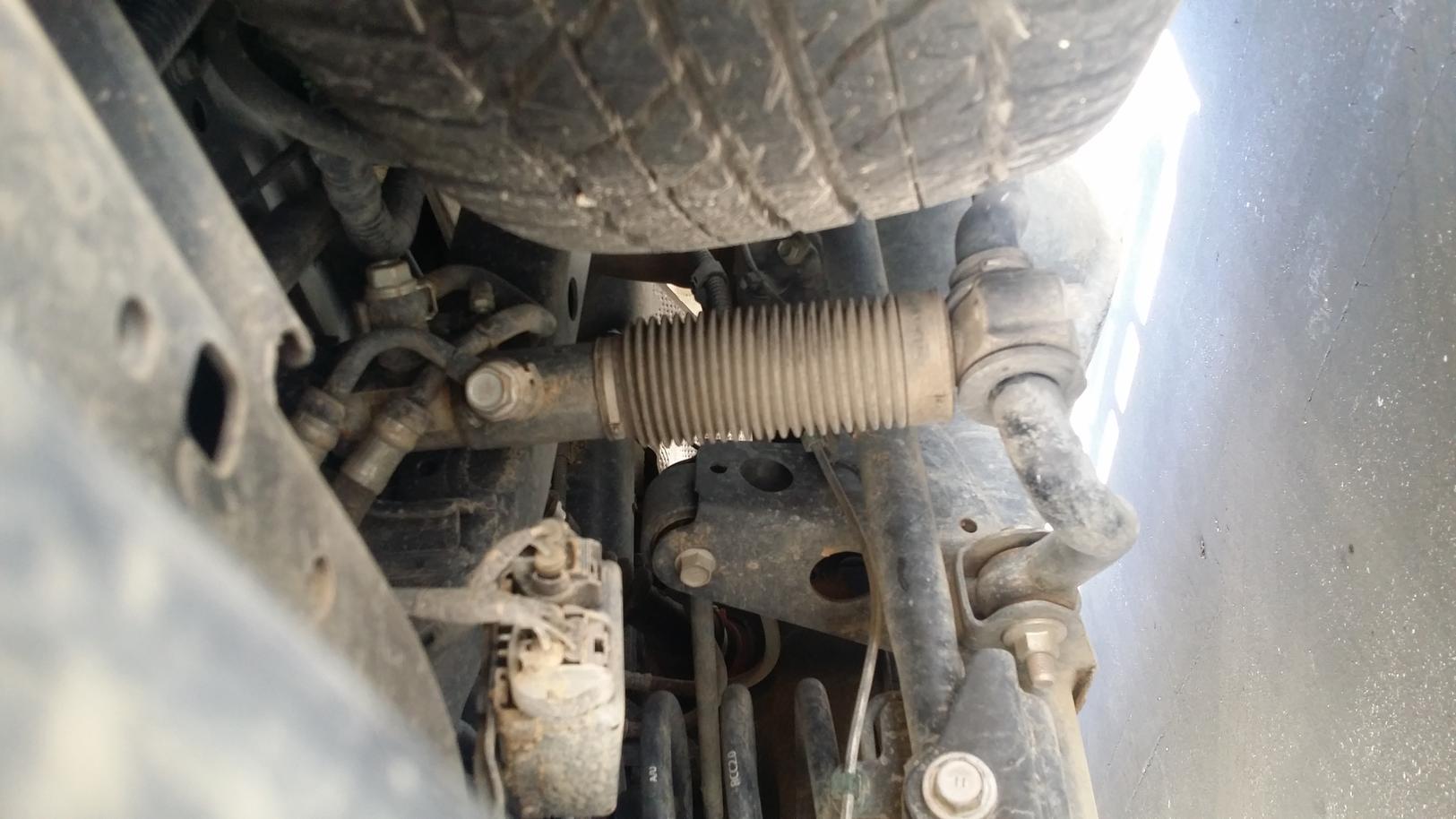

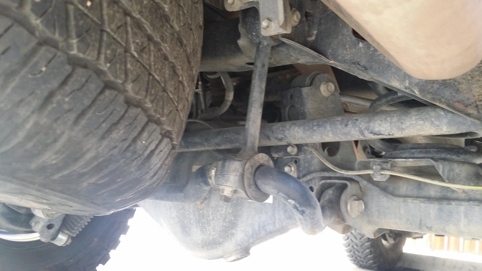

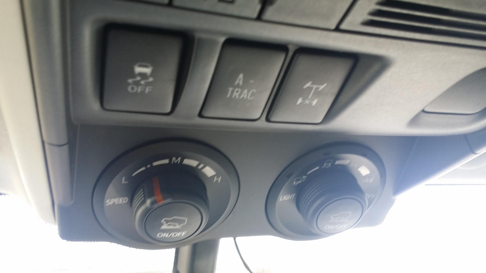

hello.. i have a question....
i have 2010 4runner trail 4x4 w/KDSS..

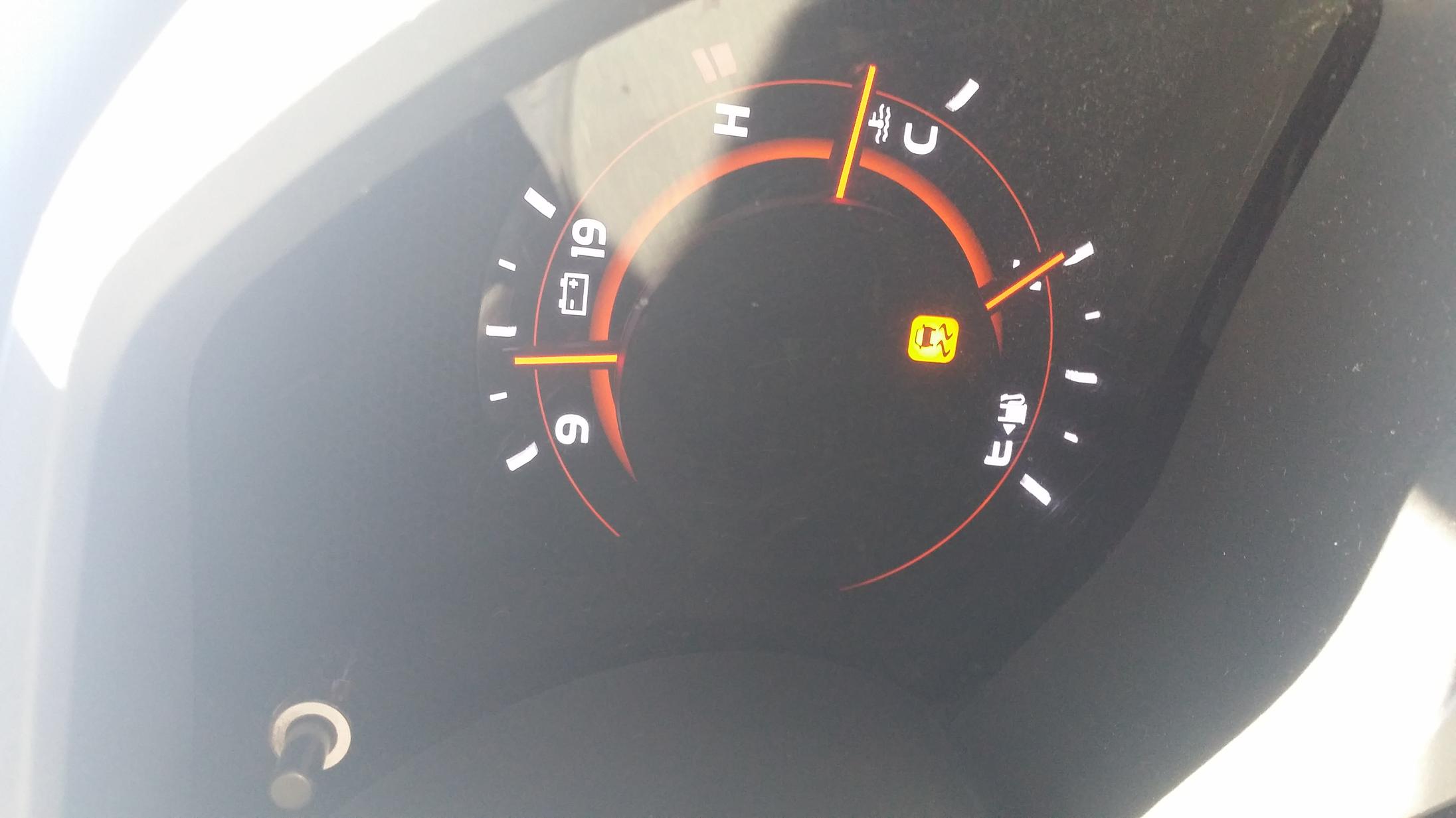

i lifted up 3inch in front&rear but, after i lifted it up i see traction is off...
i went to toyota dealer and they checked everything and said all system are working fine just the traction light is on..
but, i heard when traction light is on abs won't work...
also, tried to use crawling system but, don't work ...
turned what should i do??
i need help...
i'm going to buy UCA, rear sway bar, real coil spacer, 17x9 rims with 35 MT tires, front bumper and do front body chopped...
cause, i'm doing rock crawling...

Search this site for Zero Point Calibration.

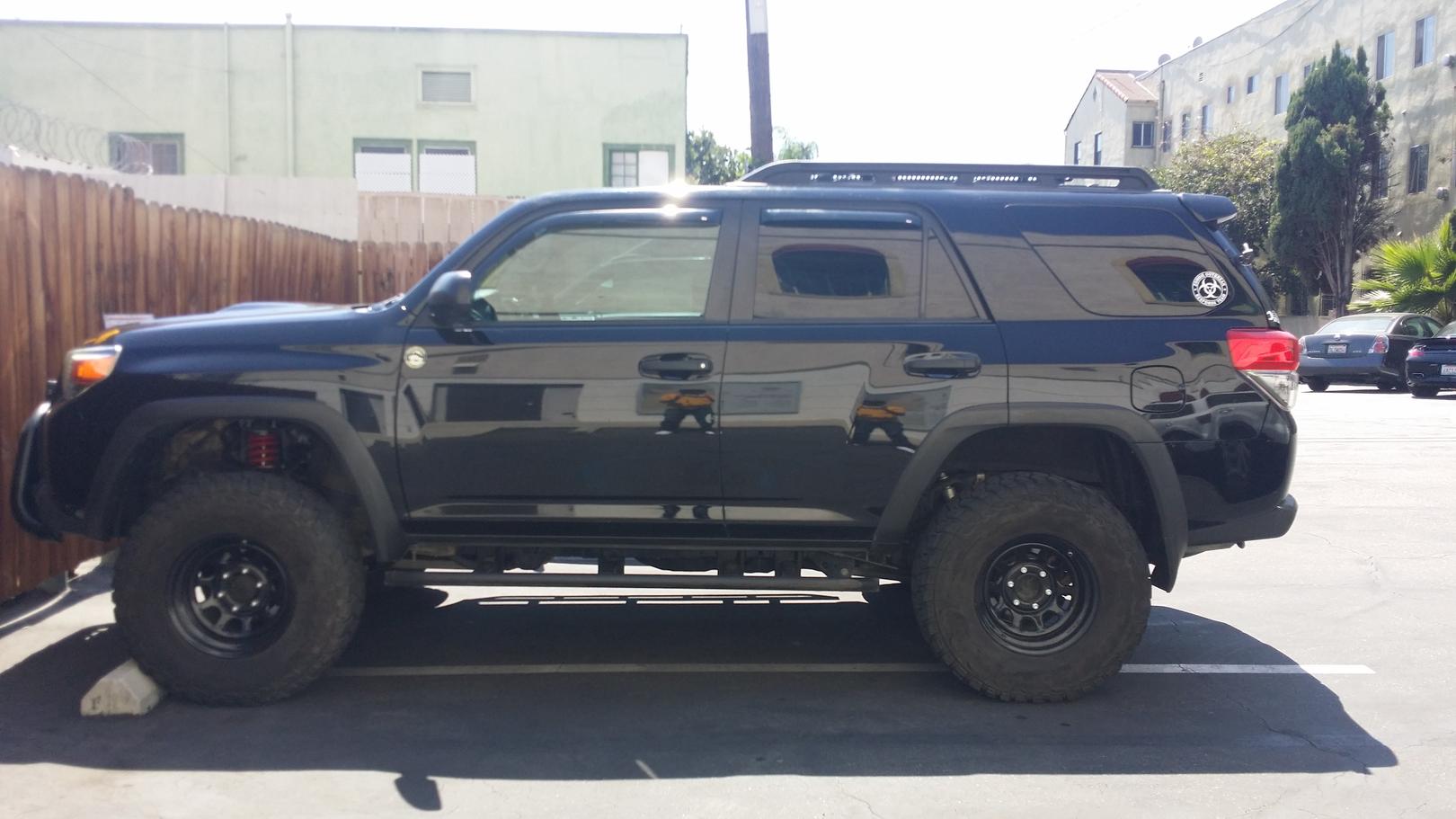

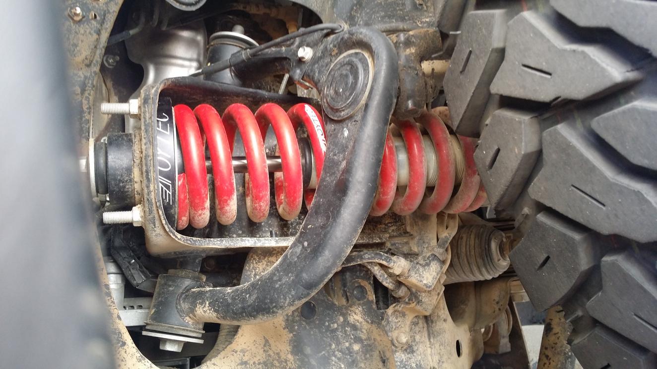

At that ride height it is going to have a terrible ride and your CVs won't last long. Why do you need a new rear sway bar?

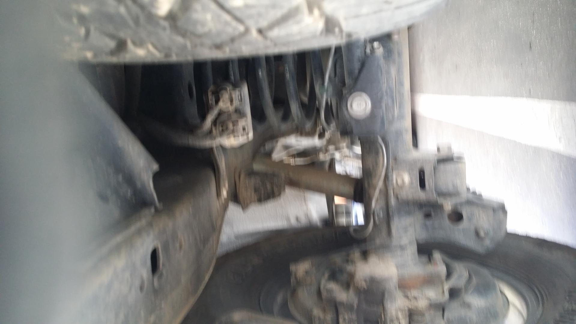

i'd've guessed stretched brake wire(s), but yeah, try searching for the Zero Point Calibration instructions and see if that clears the fault.
looks pretty nose-high to me. and yes, new UCAs ASAP. also, why do your sliders hang 4-inches down from the rocker panel? that brush bar is just going to get in your way/cause a bigger problem too.
could be that you snapped one of your abs wires when doing the lift? thats what happened to me and i ended up having to located the problem, taking out the wire and luckily i was able to solder it back together.
+2 Did this too. Figure out which one and order the part. You'll need Techstream to pinpoint which one.
