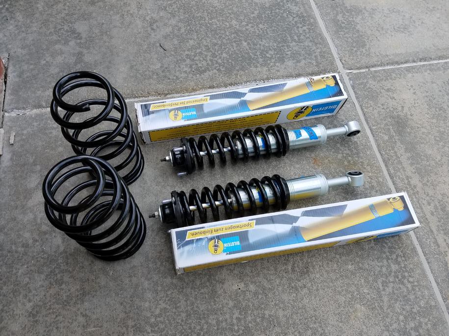

Just received my Bilstein 6112 / 5160 shocks, in addition to the Wheelers T13 springs. Wheelers assembled the 6112s for me at the #6 / #5 settings.
Based on what I have seen others do with their KDSS setup, I'm planning on installing the 6112s with #6 on passenger side and #5 on drivers. The Bilstein instructions indicate the reverse setup, but that appears to be for non-KDSS versions.
I'm hoping these settings give me the slight rake I am hoping for.

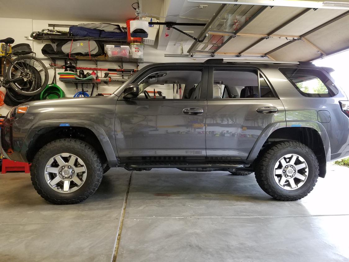

Installed my 6112/5160/T13 spring setup yesterday...took about 6 hours. The 6112's were setup with the 6th clip on the passenger side, and 5th clip on the drivers side.
Looks like the front was lifted about 2 1/2" and the back about 1". That's more on the front and less on the back that I was expecting. Seems to be fine though...still appears to be a slight rake to level.
Measurements from before and after....from fender to ground...centered on rim:
LF 34 1/8 , 36 5/8
RF 34 1/4 , 36 3/4
LR 37 , 38
RR 36 7/16 , 37 1/2
