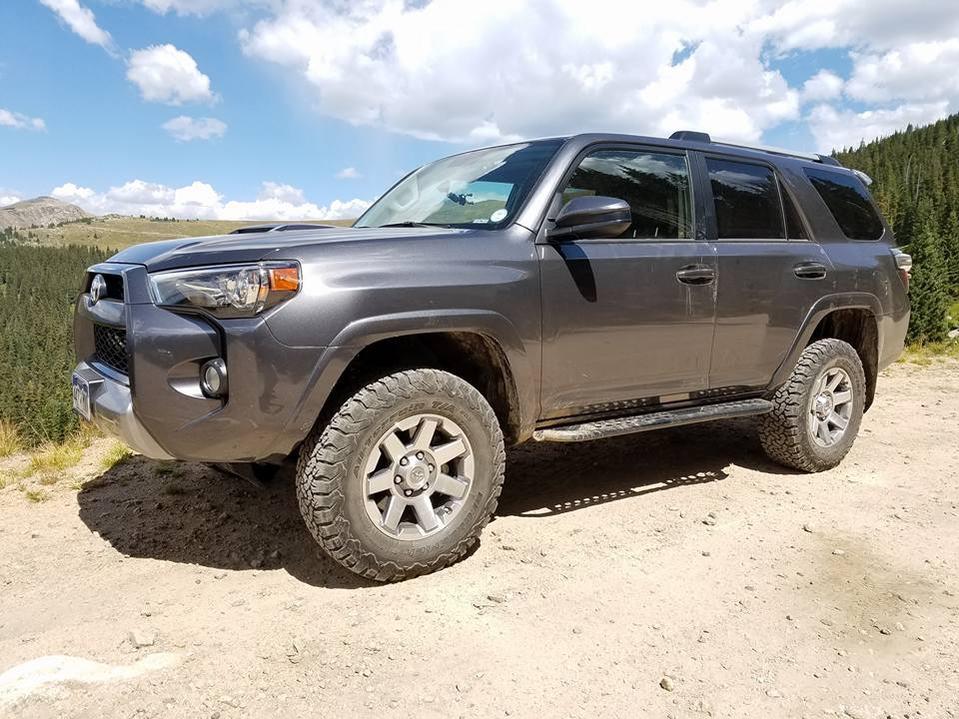

Better pick of my setup...had it on an easy trail today...checking bolts tomorrow.

Havnt seen any settling in mine after 3 weeks...still still at about 2.5" in front and 1" in back.
Not enough lift to impact garage parking.
Am happy so far...rides well. I was hoping for a bit more lift from the T13s though...was thinking of a trim packet on both sides, but don't know if it is worth the trouble.
My main goal was more lift for rocks though...front was too low. I wanted something a bit better than the 5100s, but wasn't willing to pay for fox or kings.

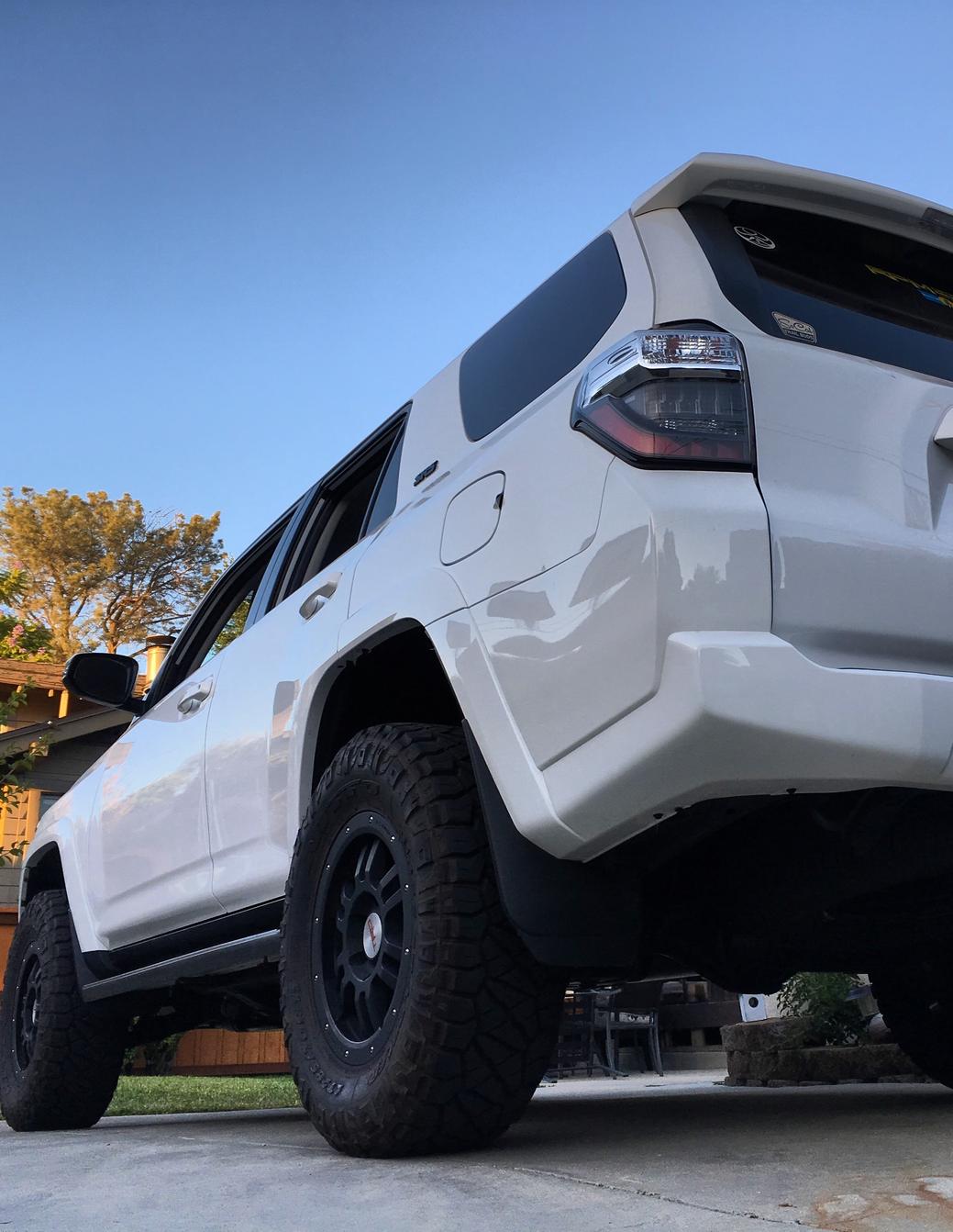

Maxed out the fronts on both sides. Let's see how they look after they settle....
