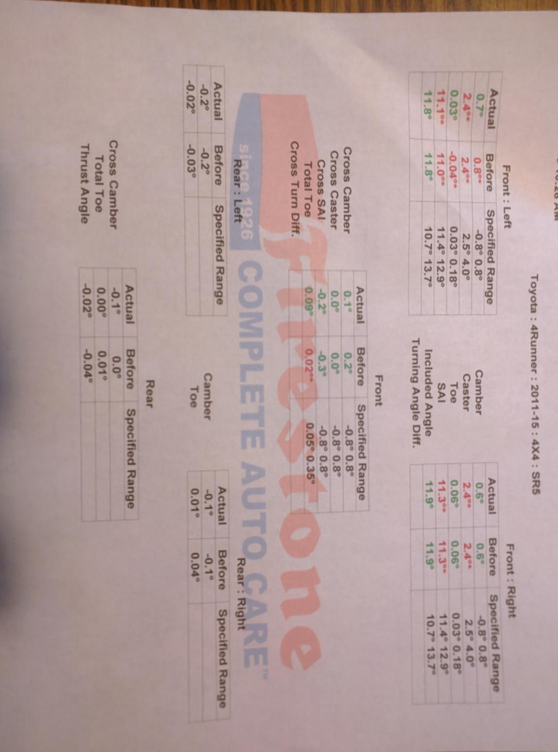

Any updates? I just had mine checked since I had installed the SAW coils in back since last time. Here is where I am at on the third notch (2"). Right on the line for caster.
None yet. I'm going to take it to the guy who does all the alignments for the local 4Rn and FJ guys locally. Should have taken it to him to begin with but sometimes you have to learn the hard way. He says he can do better so we'll see. I'll post updates once I have them.
