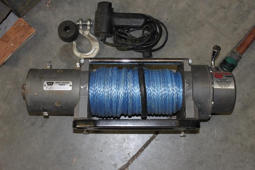

Put a synthetic rope on it for some weight reduction.
My old Warn 8000 with the rope is 45lbs. that cable is heavy.

I put the cheapest stuff I could find on mine at the time, ebay, Promark synthetic winch rope 5/16" 92ft. It was all blue then, now you can get any color you like.
This Warn 8000 is from the early 1990's, could fit 100' in it. Don't know if the new ones are different.
