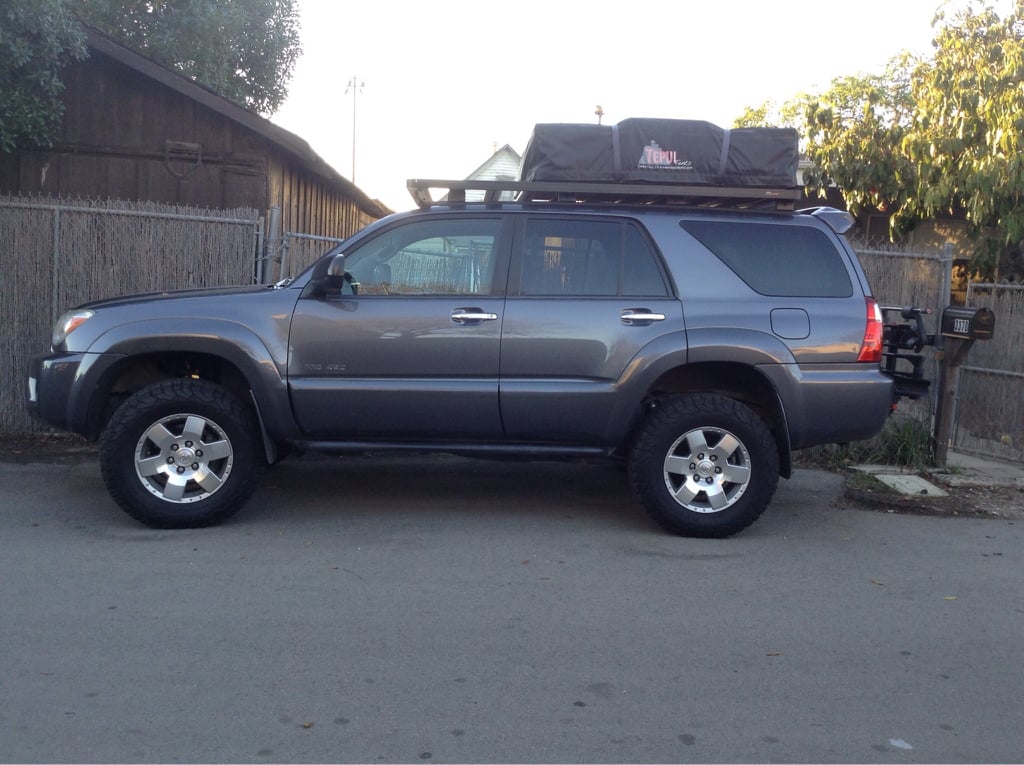

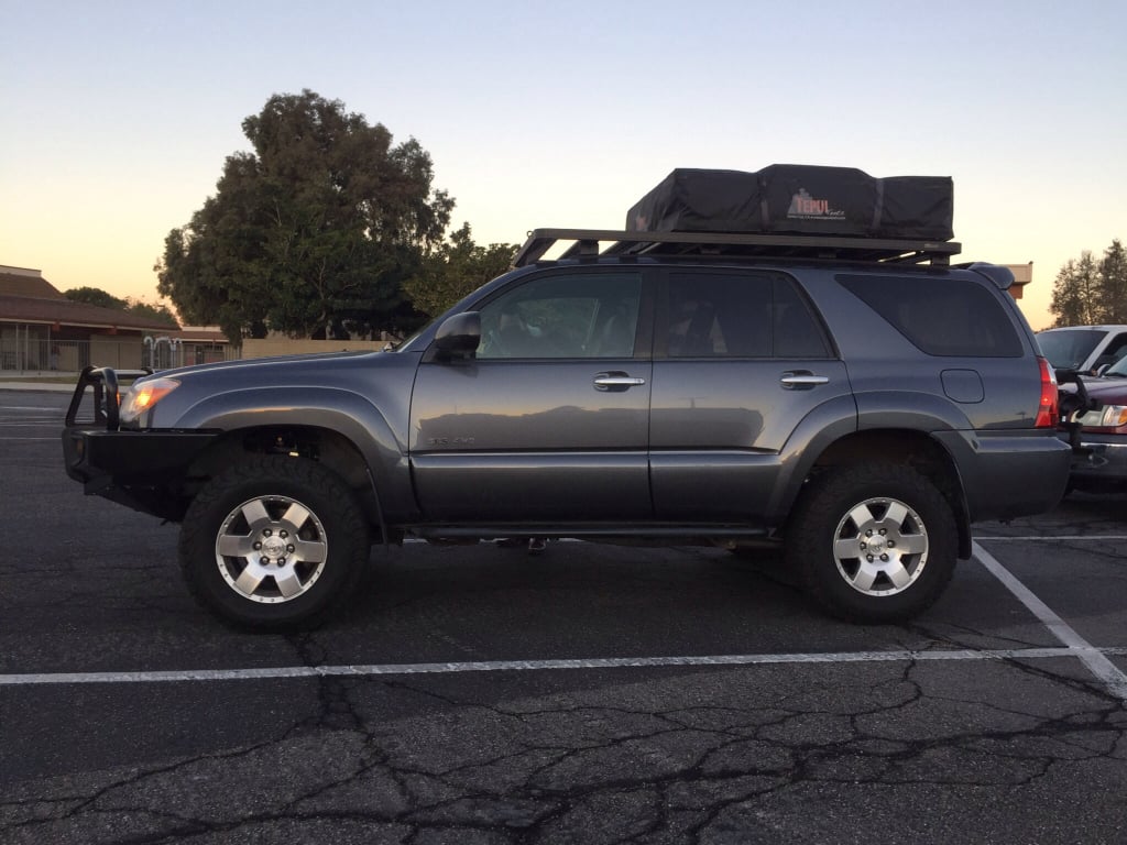

This picture is as low as the front would get, the collar was threaded all the way up the shock. Stock size tires and no lift in the back.

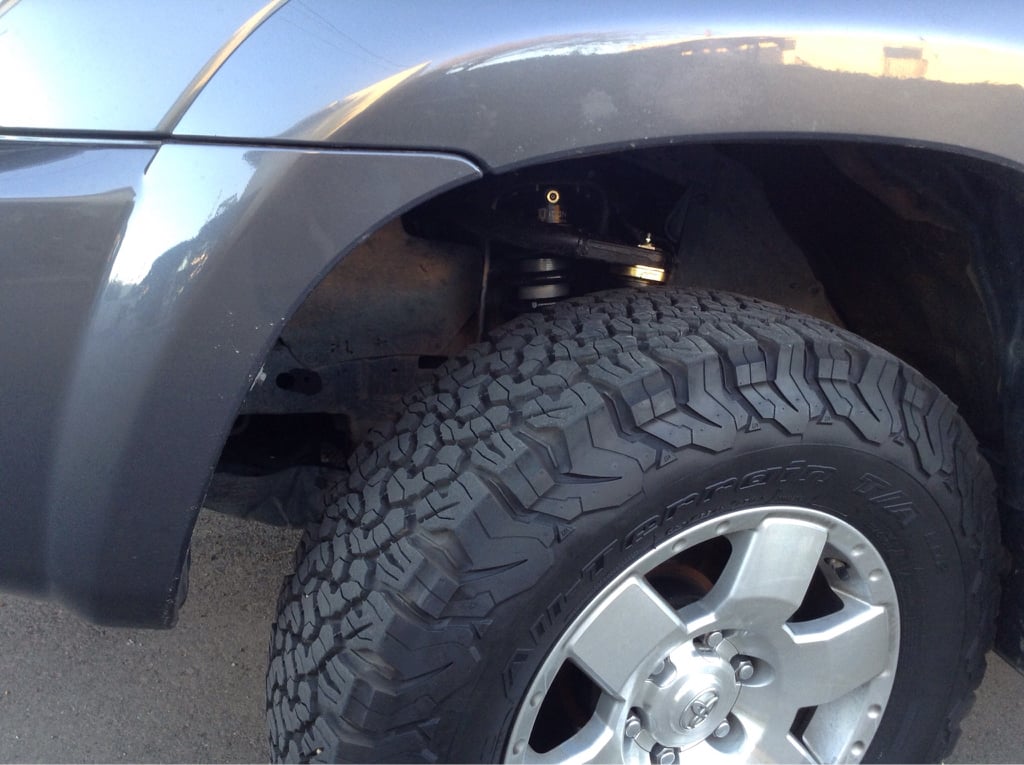

I have ICON CO's with 700# springs with almost no preload on them. I only have about 2 threads showing on the drivers side and about 1 (maybe .5) on the passenger side. The 700# icons are 14" long compared to 650# icon springs which are 13"(?).

Probably can't see how little preload on drivers side...
With bumper/winch, same exact settings as before
