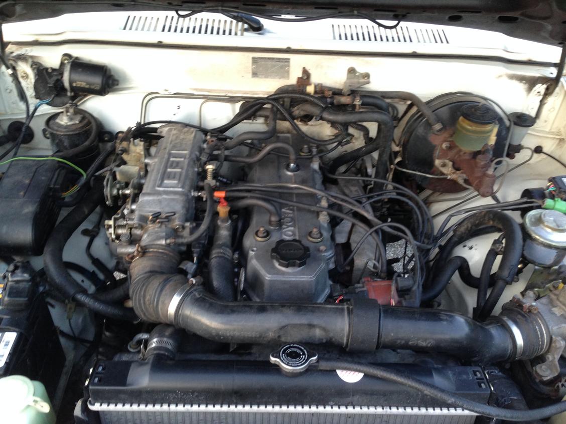

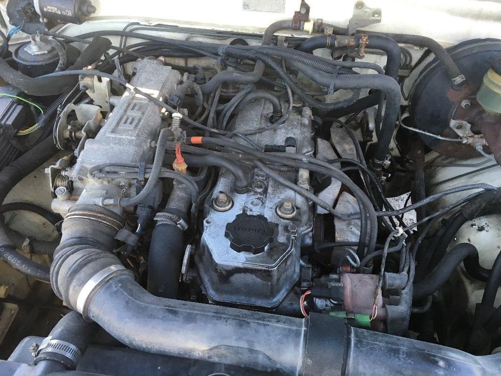

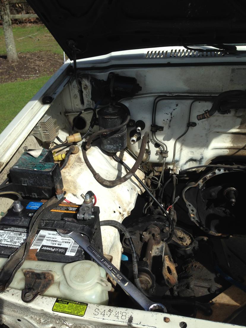

This weekend I addressed my rough idle upon warm starts by taking the IACV off and giving it a good cleaning. I also deleted the egr, cleaned the upper and lower intakes, replaced the PCV valve and put some new fuel injectors in.
after buttoning up everything the first time, with new gaskets and all, I had a coolant leak between the block and the lower intake... UGHH!!! so, I ended up pulling everything off, buying new gaskets again, and coating the two surfaces with silicon. worked like a charm!
drove back to school tonight and everything seems to be fine, i just need to do a little adjusting to the idle.
no pictures of anything, just a before and after engine shot (Sorry for the terrible quality). started to do some cleaning, but definitely needs some more.
before:
after:

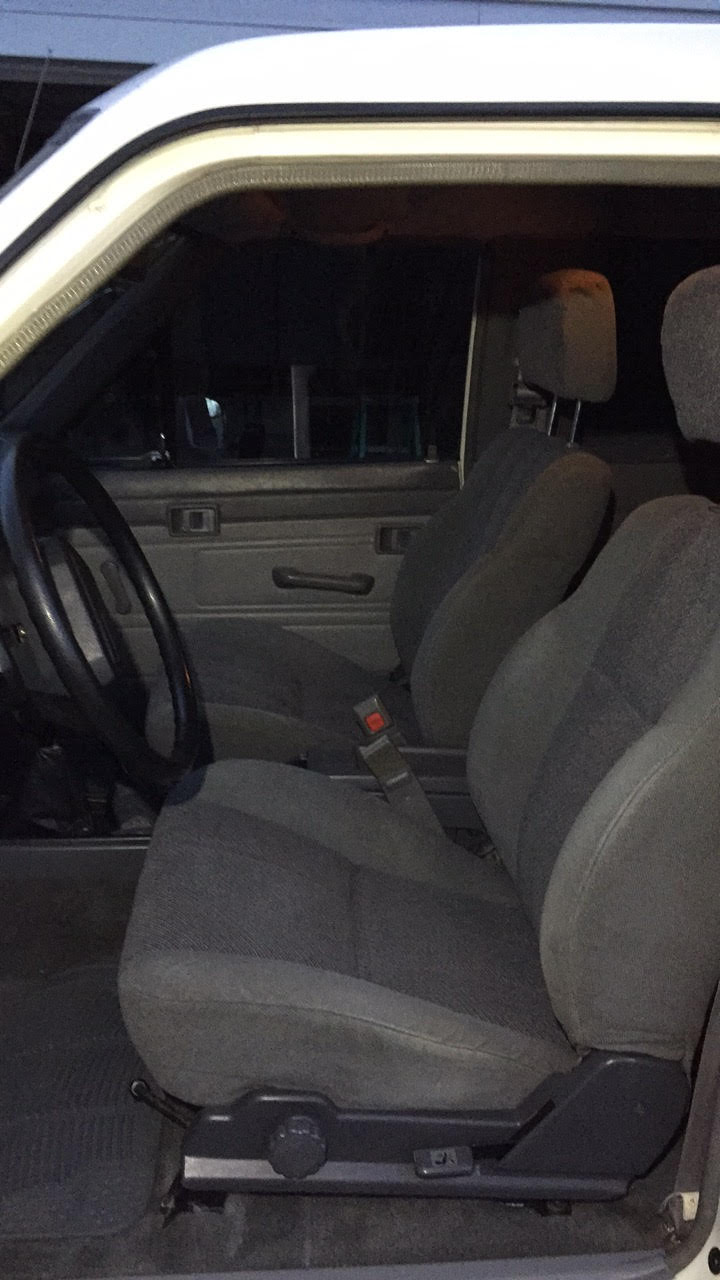

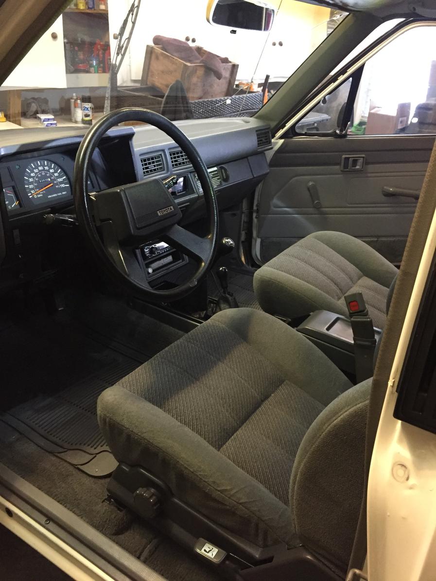

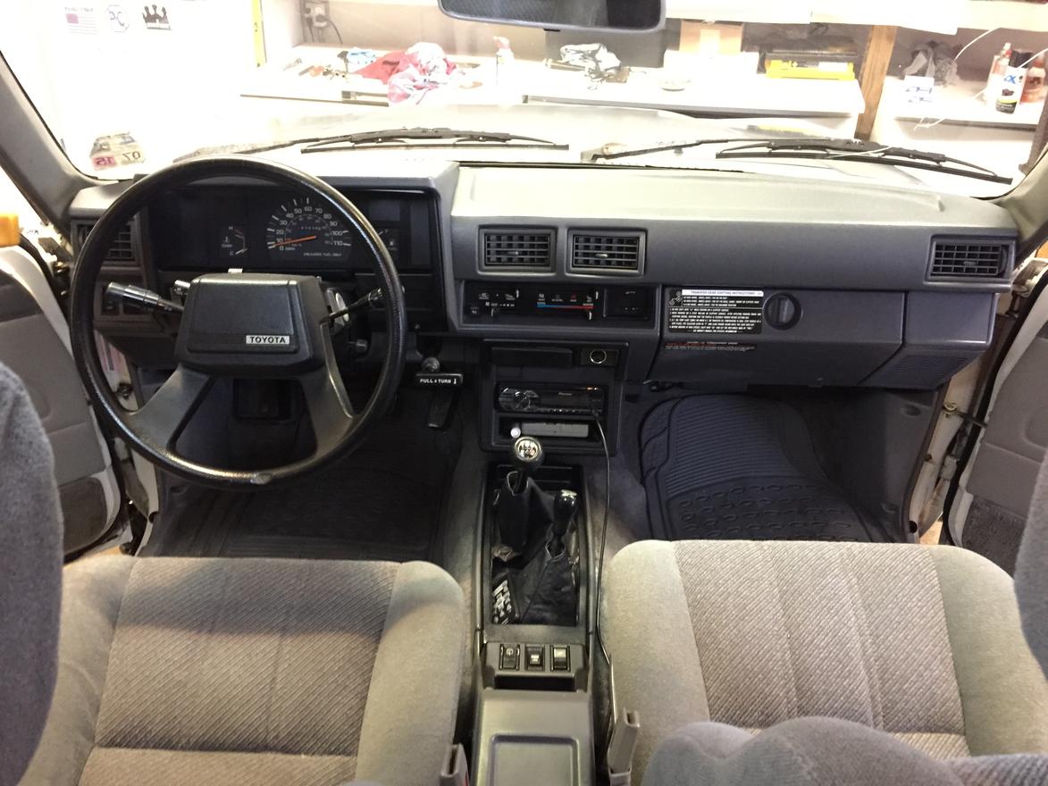

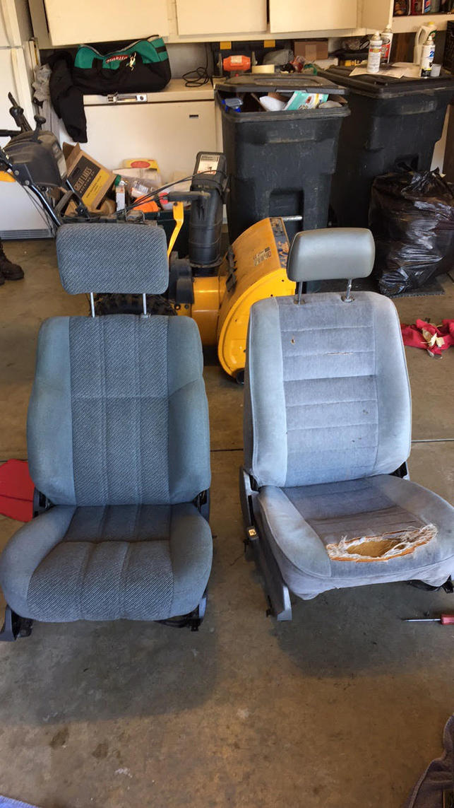

My interior is officially complete.
I have a 2 wheel drive Grill on mine as well. I put in a 4Runner logo instead of the Toyota and really like the way it looks.
Here's a few more interior shots with the new seats. Oh, and a new glove box with the transfer case instructions. It came from a turbo, so it has a note about the turbo below the transfer case instructions

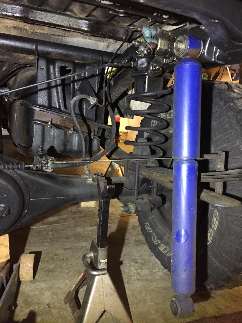

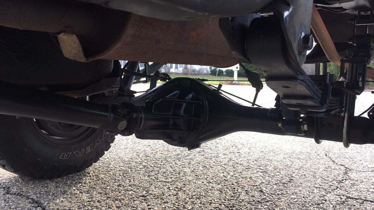

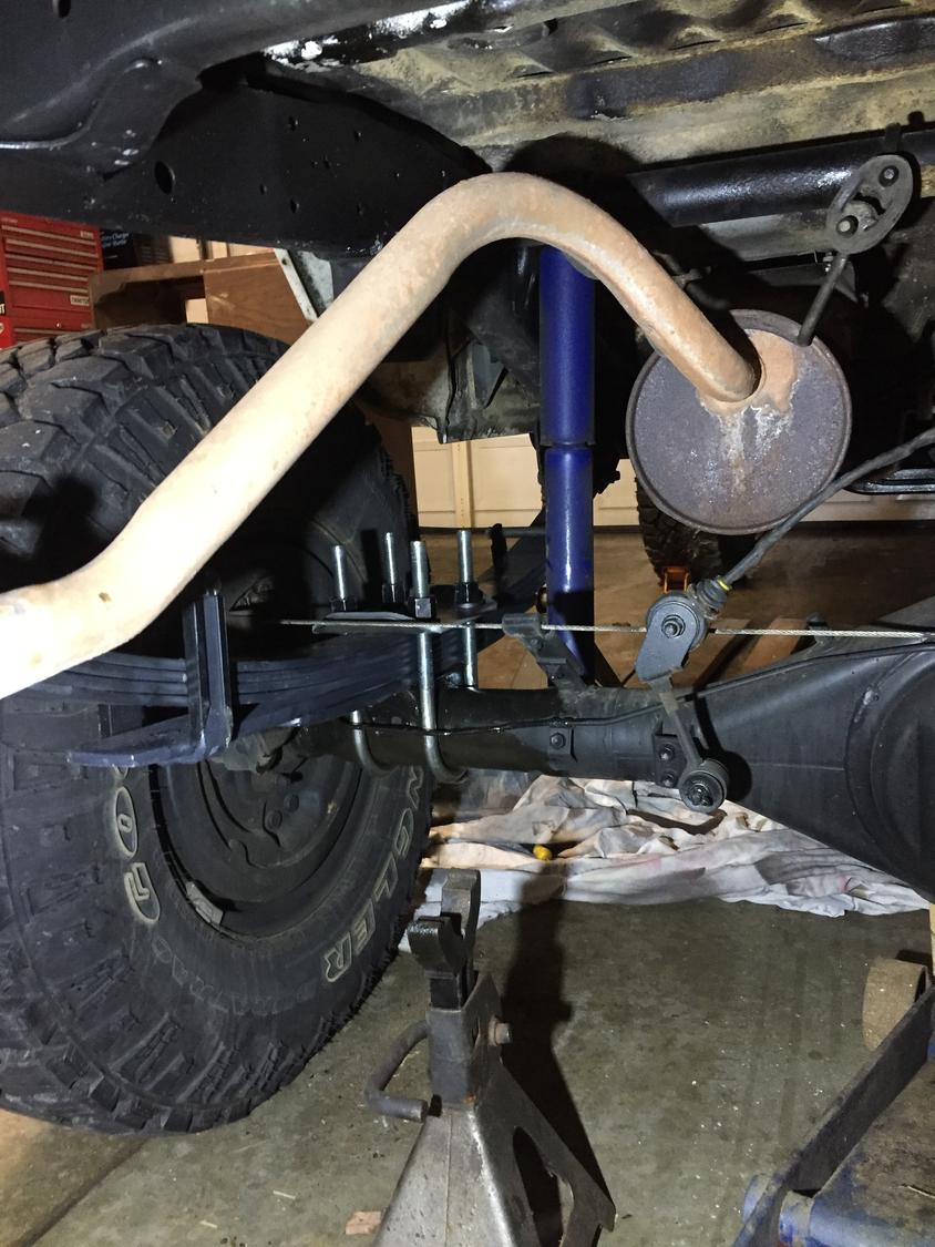

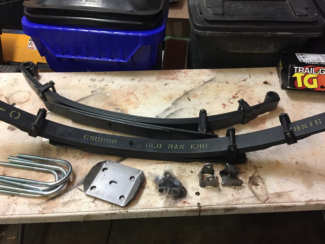

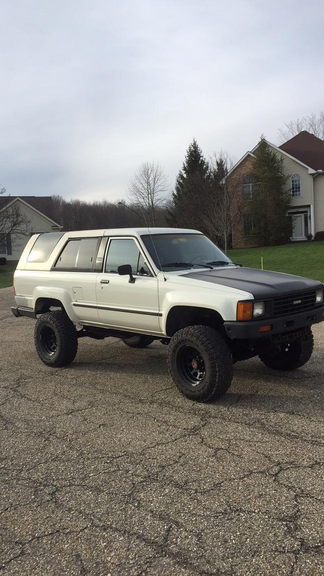

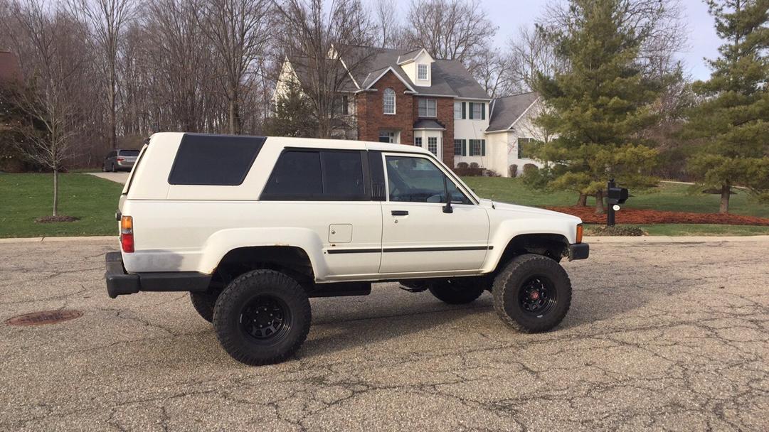

Finally decided to replace my old leaf springs. I was running the original springs along with the zuk mod using 3rd gen coils. The original springs were giving me a ton of axle wrap, and my u-joints were finally toast.
So, I went with OME medium load springs (CS009R) with a u-bolt flip kit and new bushings. I replaced my u-joints and rear pinion seal while I was at it.
old setup:
new setup:
Pretty good stance with ball joints spacers up front:

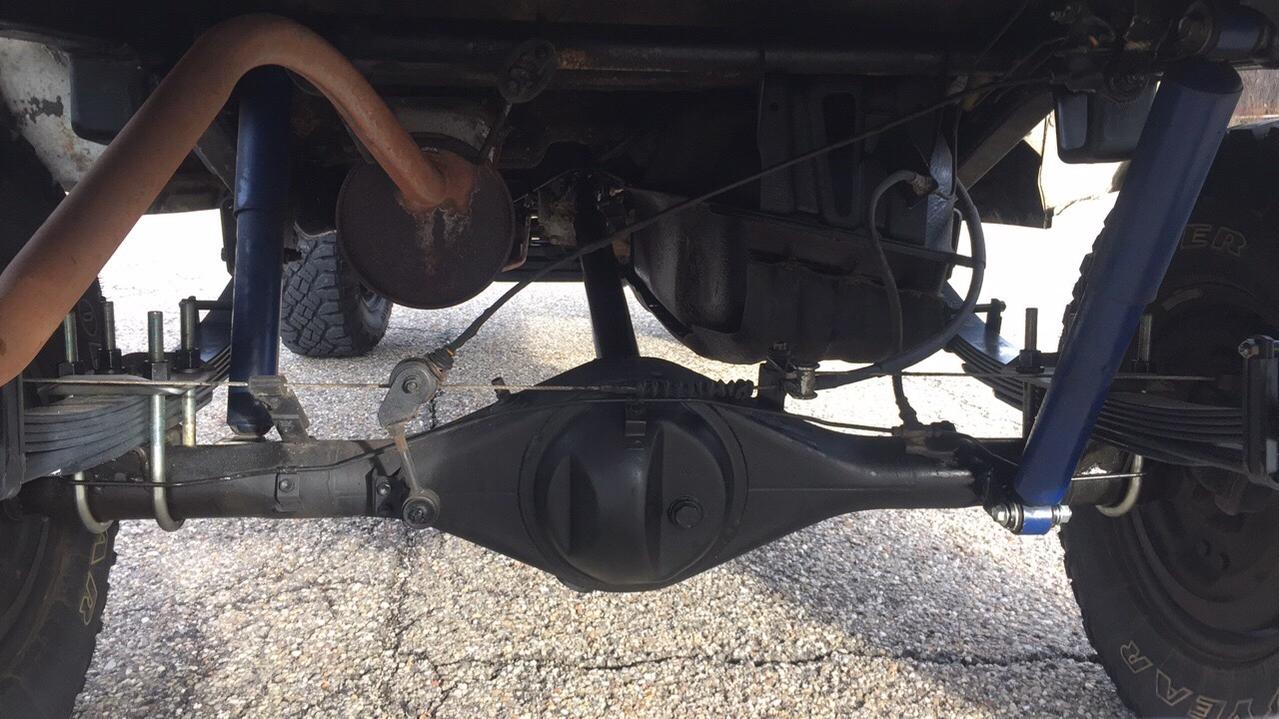

Finished product underneath:
Still have to put my bump stops back on and trim the ends u-bolts a bit.

looking good! SO you didnt touch the torsions at all to get it level? Most OME leafs i see look much higher in the back.
Thanks! Correct, I didn't touch the torsion bars. But, I do have bj spacers and I don't know if the torsion bars were cranked prior to owning it

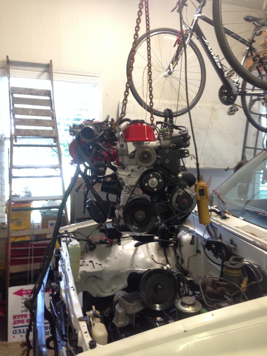

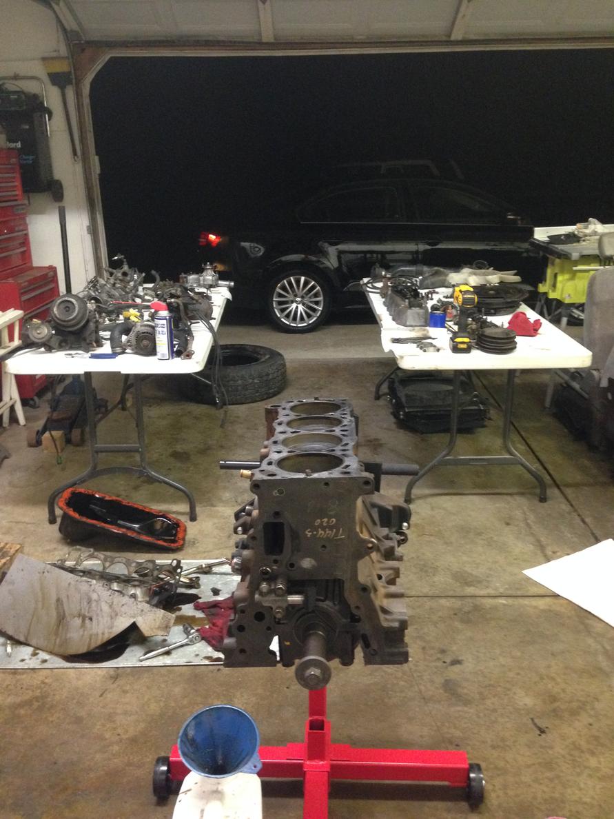

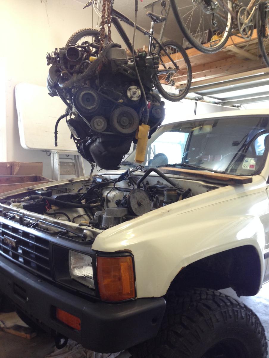

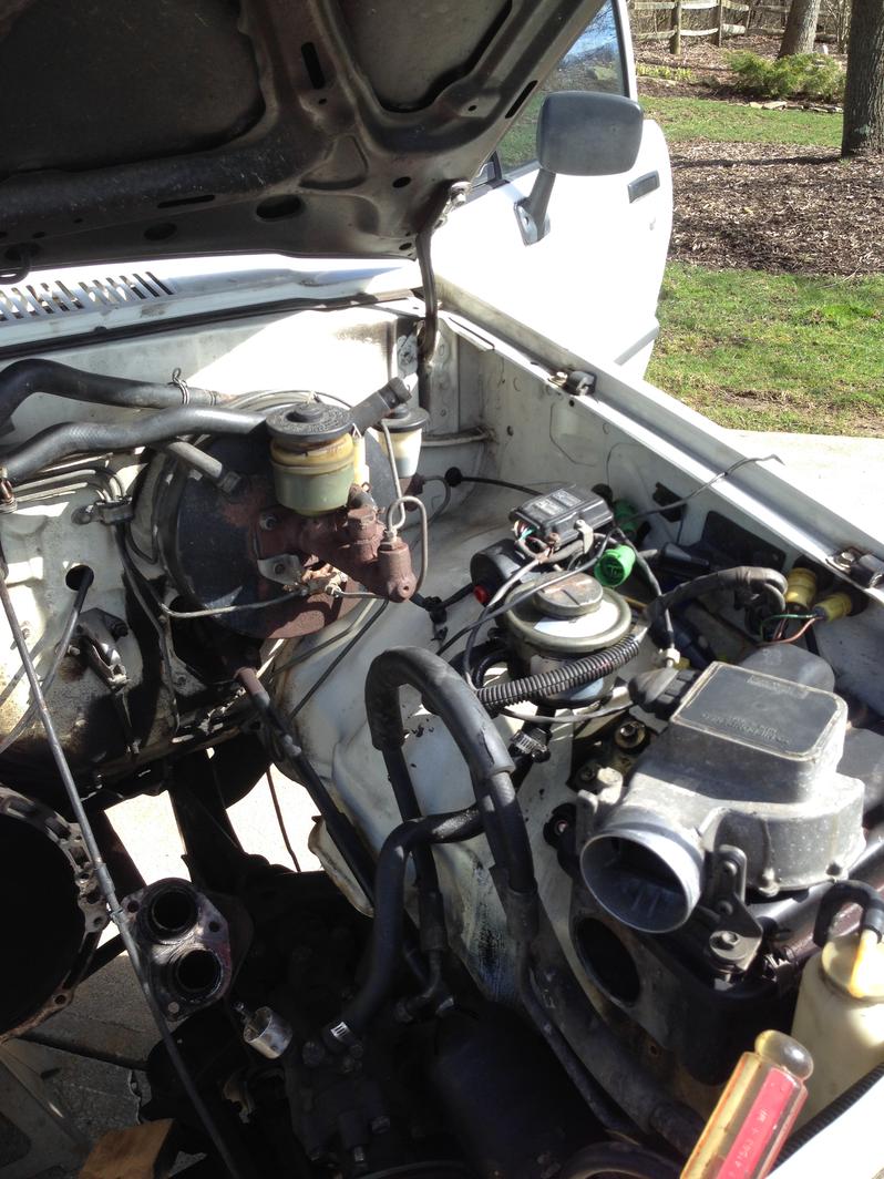

So, I decided to pull the motor the Friday before spring break. With a week off for spring break, I thought this would be the perfect time for the rebuild.
My plan is to clean up the engine and engine bay really well, paint and refresh everything I can, without going too crazy. I'll be putting a new head on and cam in from Engnbldr. Think I'm leaning towards the 261 cam, anyone have any opinions?? I'm also going to be having the block inspected.
Using our harbor freight hoist to pull out the engine. Did it by myself, worked great.
got every disassembled and organized by the end of the first day.
The block is at the machine shop now, waiting to hear back on whether I need to bore out the cylinders or just hone it. In the meantime, I'll be doing a lot of cleaning.

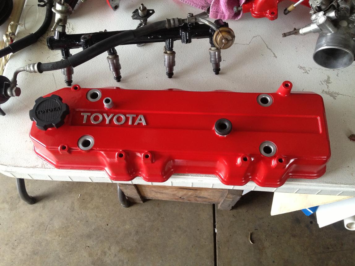

I'll leave a little shot of the valve cover here..

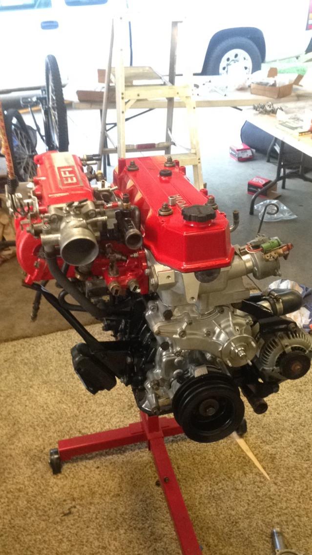

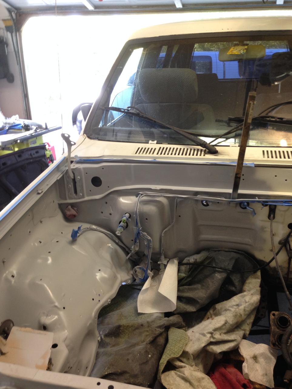

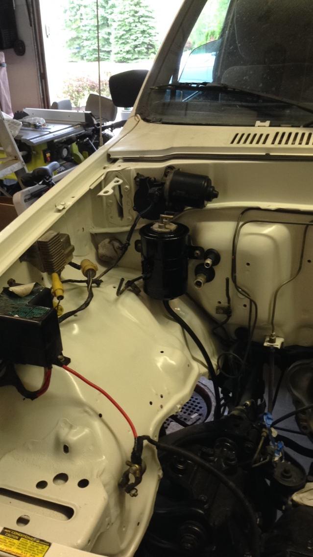

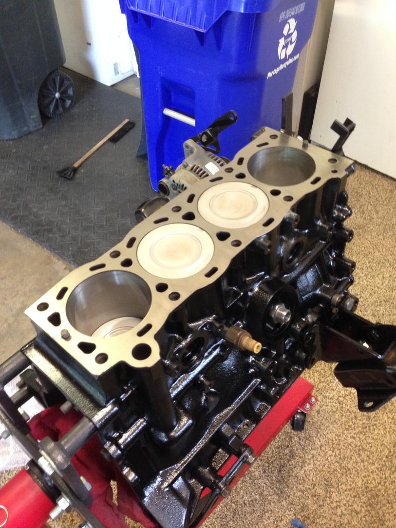

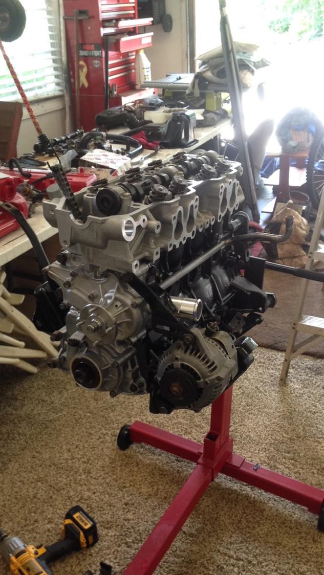

Well, the block finally came back from the machine shop! I found out the cylinders were bored at some point in the past and i could get away with honing them. After the crankshaft was polished and the block was decked, i had new bearings, rods, pistons, and rings installed. Once I got it home, I gave her a paint job and then started assembly.
I ended up putting Engnbldr's StreetRV head on it with the 268C/Torkr Cam. Put a new water pump, oil pump, timing cover, and timing chain kit with steel backed guides on. Also put on a new clutch and flywheel.
Painted the engine bay as well. The more time the block spent at the shop the more things I found that should be done.
