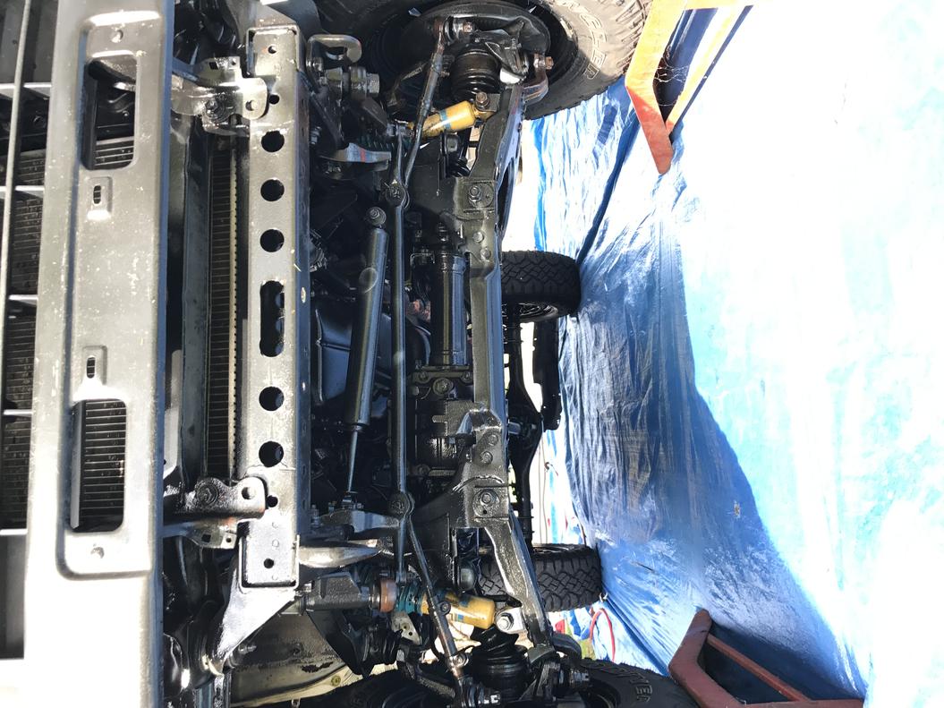

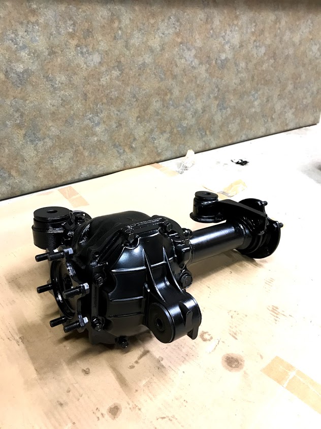

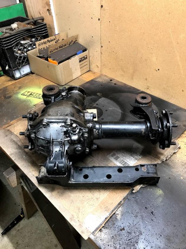

cleaned up the front end too.

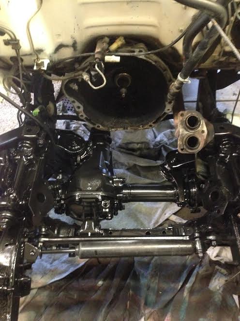

finally, the before and after shot...

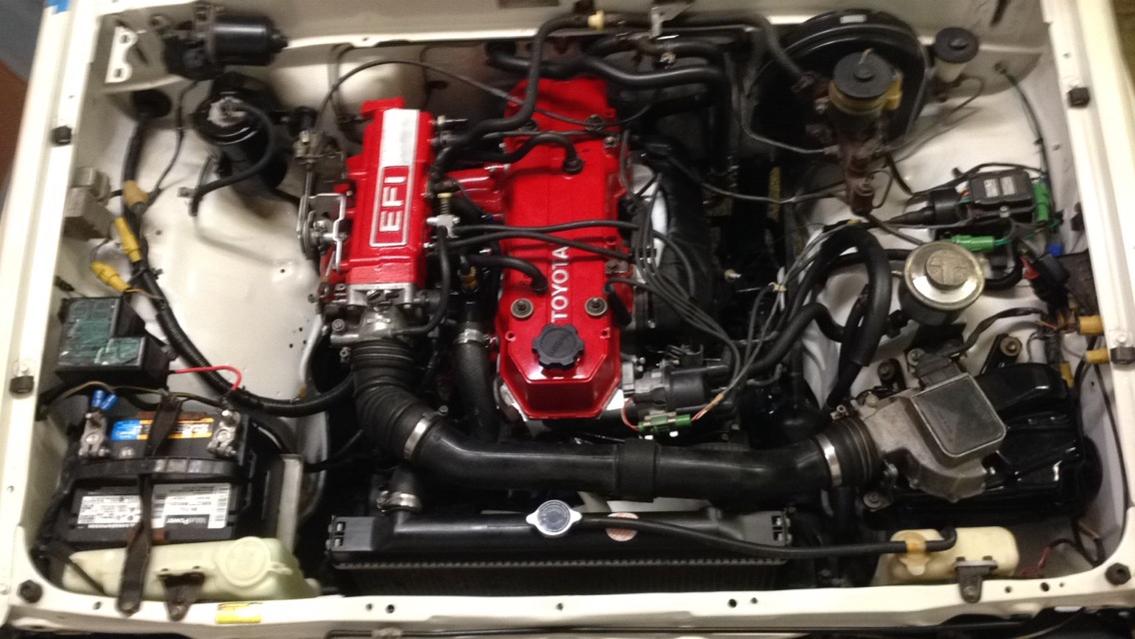

Other than losing about 3 qts of oil in about 30 seconds on initial start up because the machine shop forgot to replace one of the oil galley plugs, the whole rebuild went pretty smooth, and she is running great! Unfortunately I have one small leak from the rear main seal housing, but ill address that a little later.

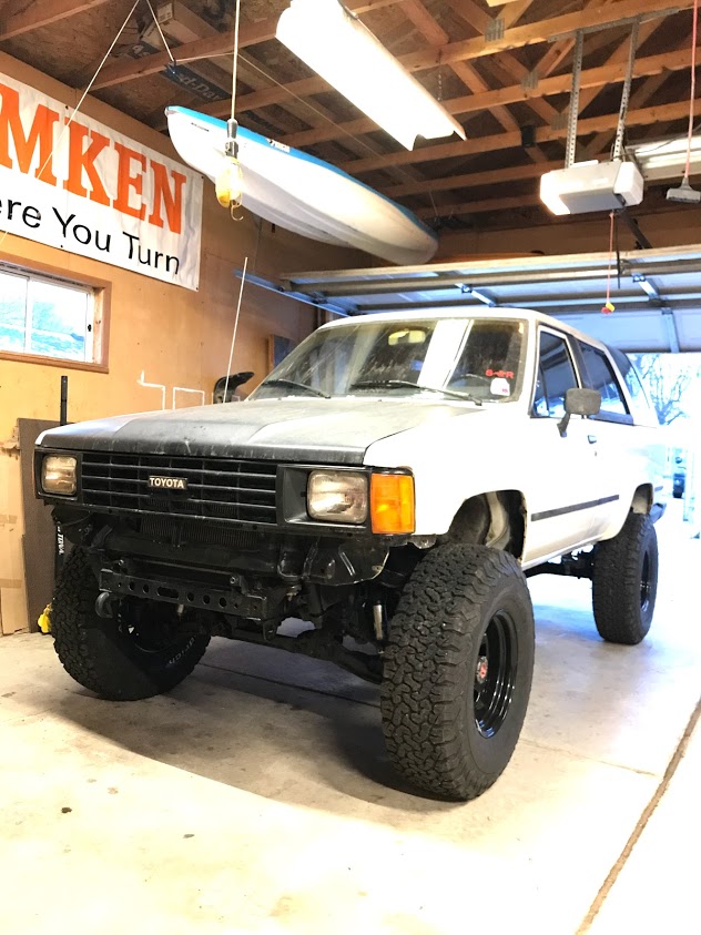

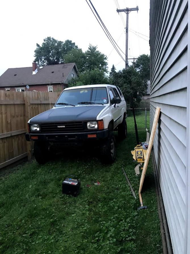

Finally pulled the 4Runner out from behind the garage after a little over a year.
Sold the wheels and tires that were on it with a '91 4Runner I had bought for cheap, planned to rebuild the engine and sell... Ended up taking the engine completely apart, realized I didn't have time to rebuild the engine, and sold it.
With no tires and wheels, I needed to get some...
I've always wanted 33's, so I got some. 33x10.5r15 mounted on cheapy 15x8 steel d windows.

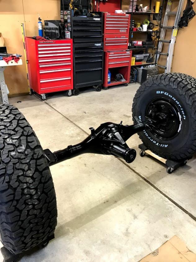

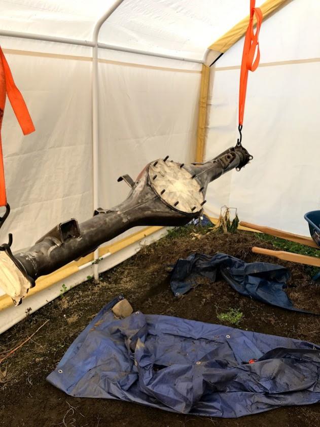

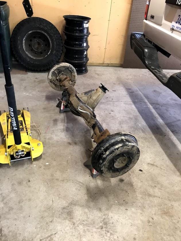

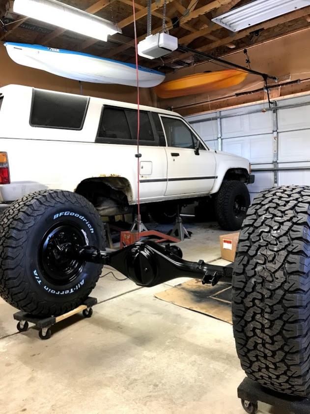

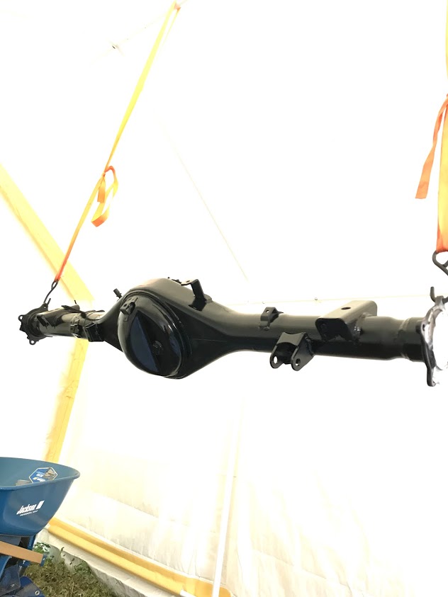

It was a dog with the 31's, so a regear was a necessity with the 33's. Went with 4.88s and threw a Yukon Grizzly locker in the rear while I was at it.
Replaced wheel, diff, and pinion bearings, all seals, and brakes while I was in there.
Oh and a fresh paint job too.

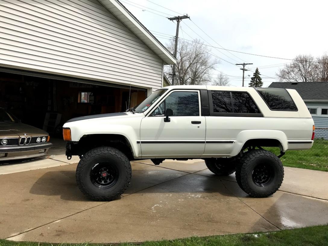

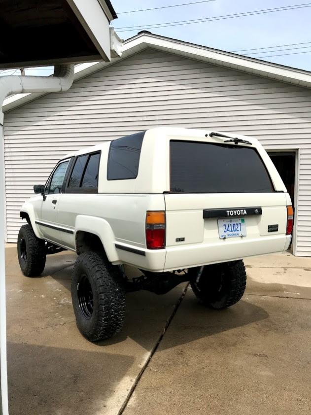

Sitting nice and purty.
Rides great! I can actually accelerate up hill going 75mph. With some mixed driving, a tiny bit of trail riding, but mostly highway I averaged 20.3 on my last fill. Not too shabby!
First time setting diff bearings/backlash and pinion bearing preload. Ive put about 1200 miles on since the rebuild and all as been good.

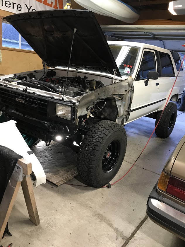

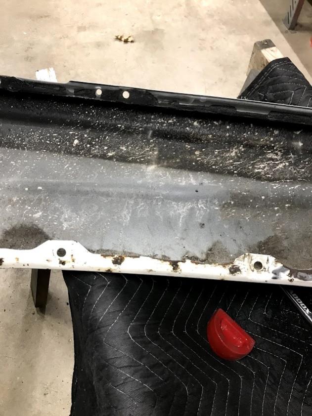

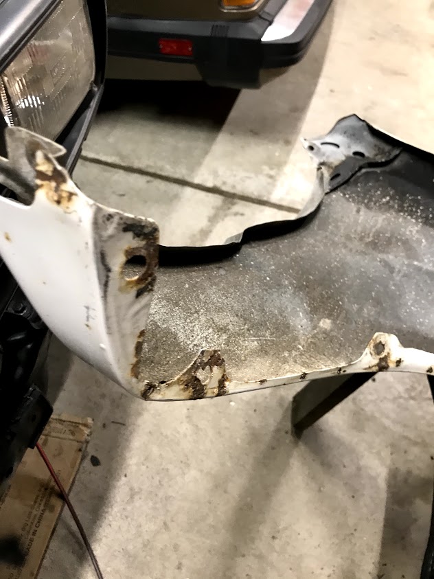

I have started on the driver front fender. A few dents/creases as well as about 15 holes on the inner lip from the PO using self tapping screws to screw in rubber molding as fender flares (the cause of rust on my rear fenders)

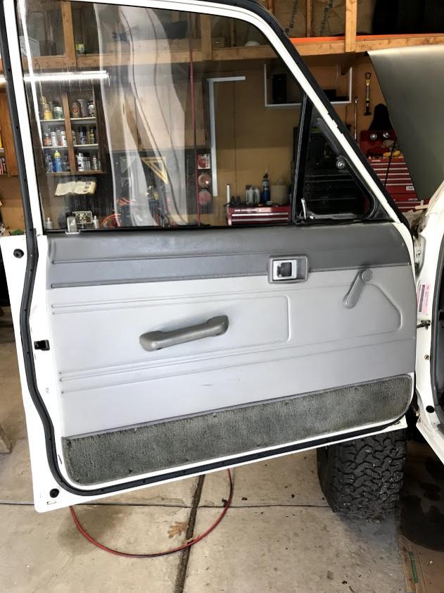

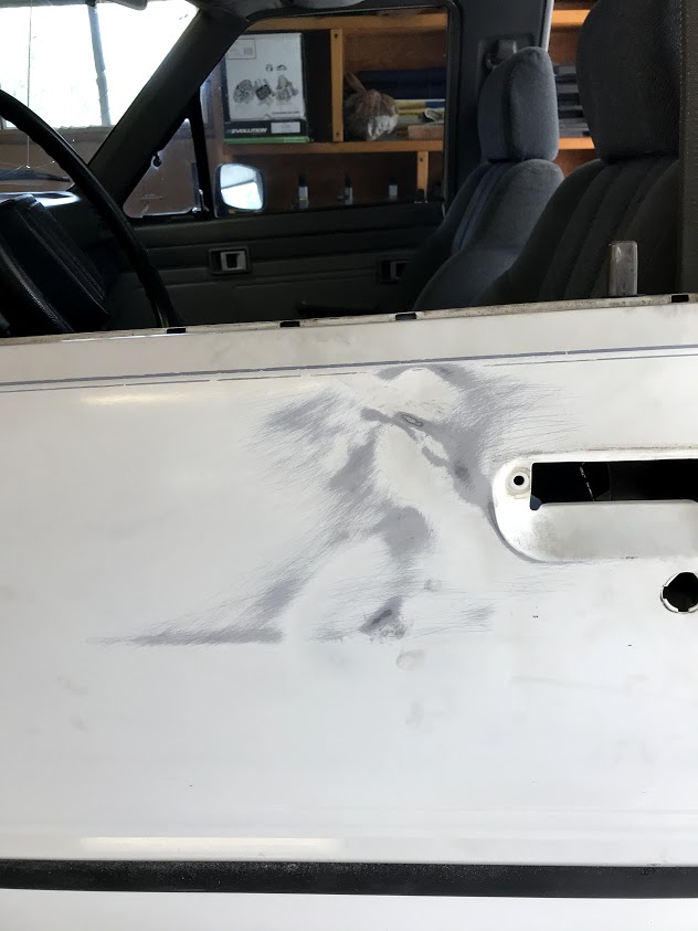

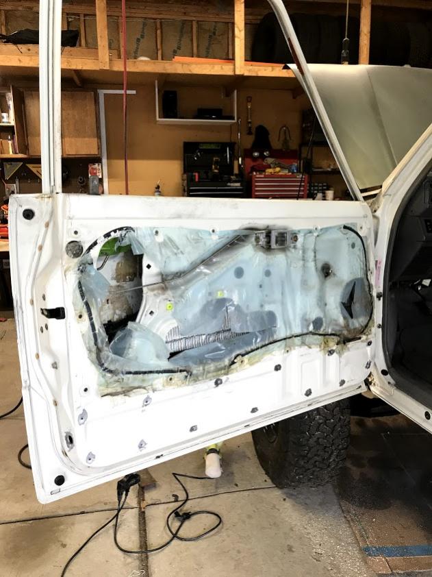

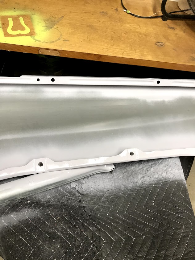

Onto the driver door...
There was a cluster of small dents near the handle. First pic below highlights these dents. Pounding these out from inside was quite the pain. Going to try to use as little body filler as possible.
The PO also used self tapping screws to screw in some carpet on the interior of the door... welded in those holes. Still need to grind them smooth

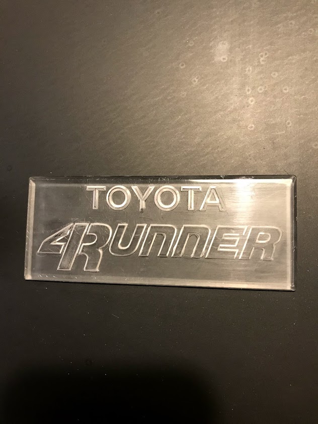

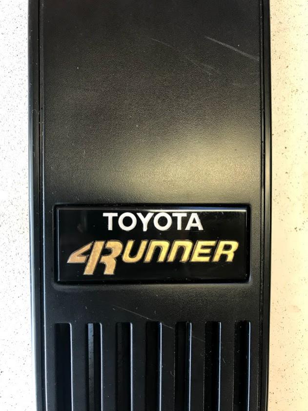

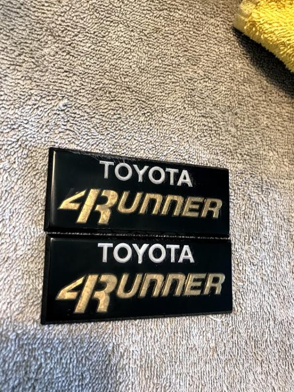

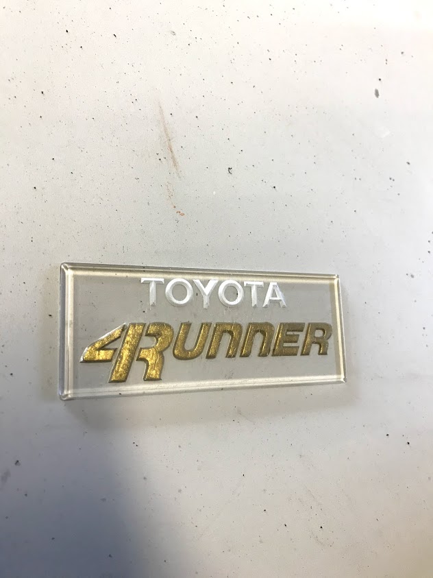

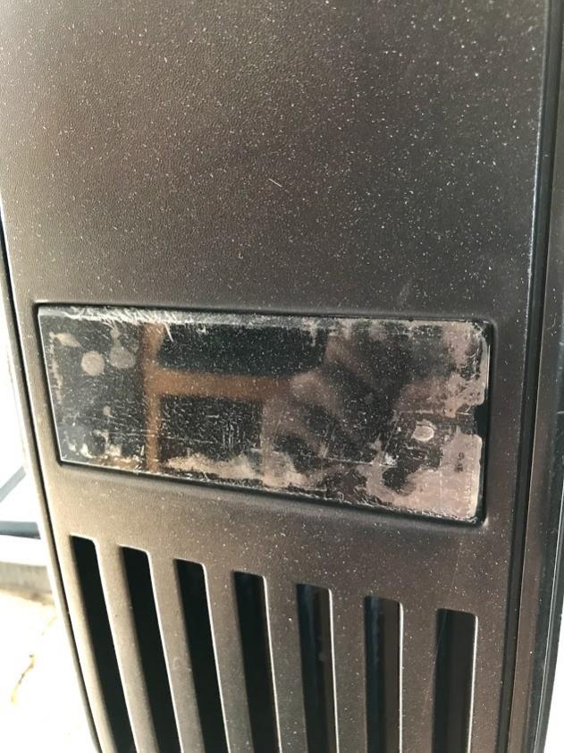

Restored the B pillar badges. They were in pretty rough shape...
Scraped off all the old paint. What a pain...
Used some gel type, t shirt paint for the letters.
black spray paint on the backs.
Not perfect, but much better than before.
