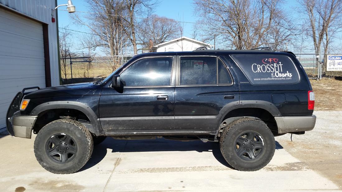

I have 891s and with a 300lb jet ski on a hitch hauler it sits about level with the front (2" lift in front). And it seems to flex well as the others have said (and I'm only running stock shocks...). It's kinda rough with stock shocks, but I don't really have anything to compare it to except saggy stock coils...

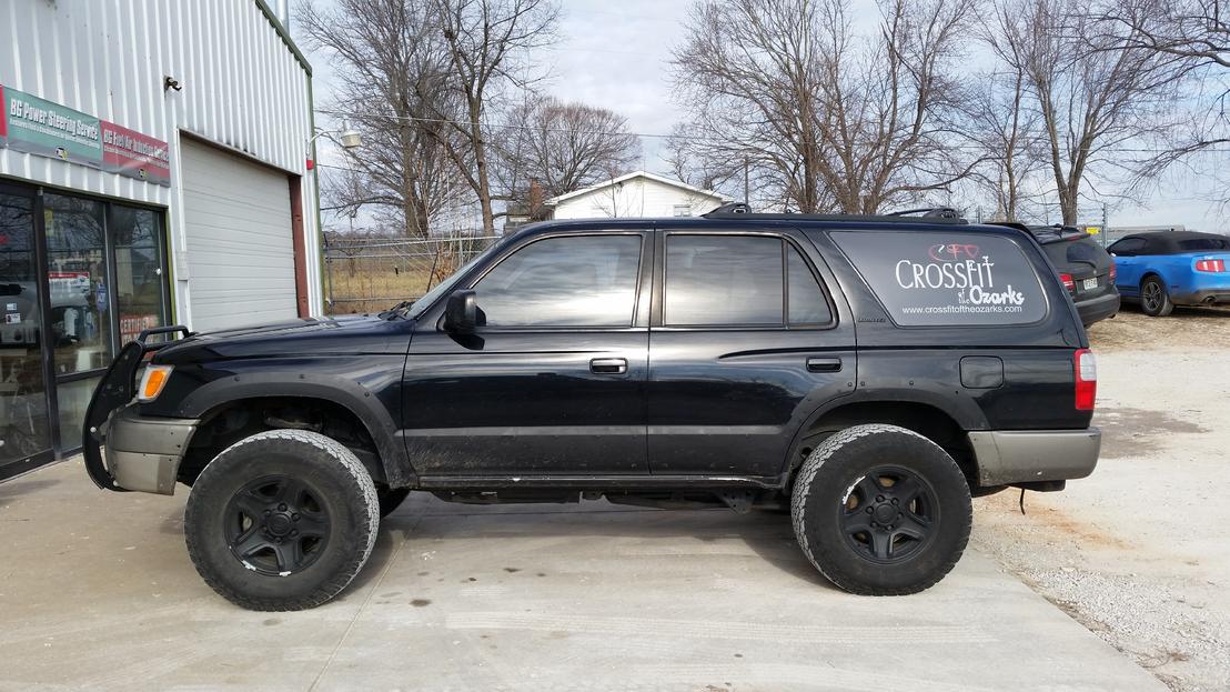

I removed the front 1.5" spacer and 3" rear spacer with factory coils. I added Bilstein 5100 shocks front and rear as well as OME 891 coils to the rear. Factory springs up front. HUGE difference and added height. The truck rides like a dream. I keep about 200-300lbs of gear in the back.

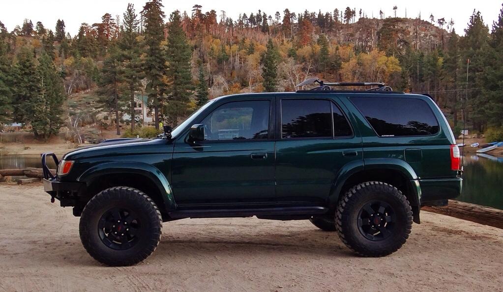

Here's a profile of mine with 890's in the back. I don't haul much and never tow, but it feels perfect to me for trail driving and not too rough at all on the road.
