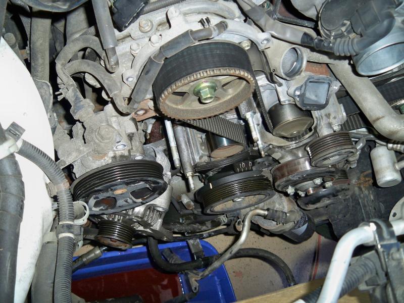

You may be able to pull a cover back and take a peek at the belt to determine if it's fairly new. The back side runs on a couple pulleys and will wear the lettering off. This is mine at 100k, on an '03 Land Cruiser. If the lettering is crisp and clear it does not have 90k on it.

I've done a couple Lexus V8 timing belts at 100K and by the looks of the belts they could have gone to 120K easy. I would feel confident on letting mine go to 120K.
