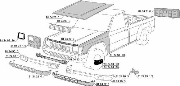

Thanks for your reply. The car whose parts I'm offered is Toyota/Hi-Lux 4WD/1989-97Pick-up
I will attach a picture with all the parts on in.

As far as I am aware the US spec 4runner and hilux 4wd LN 106, LN 107 and LN 109 pickups got identical fenders, front end (except the headlights/grill) and front doors. HIlux surf 2nd gen and 2nd gen 4runners are identical in body/frame.
