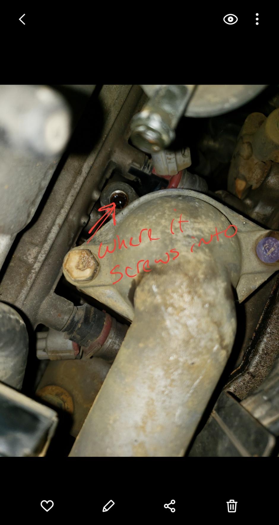

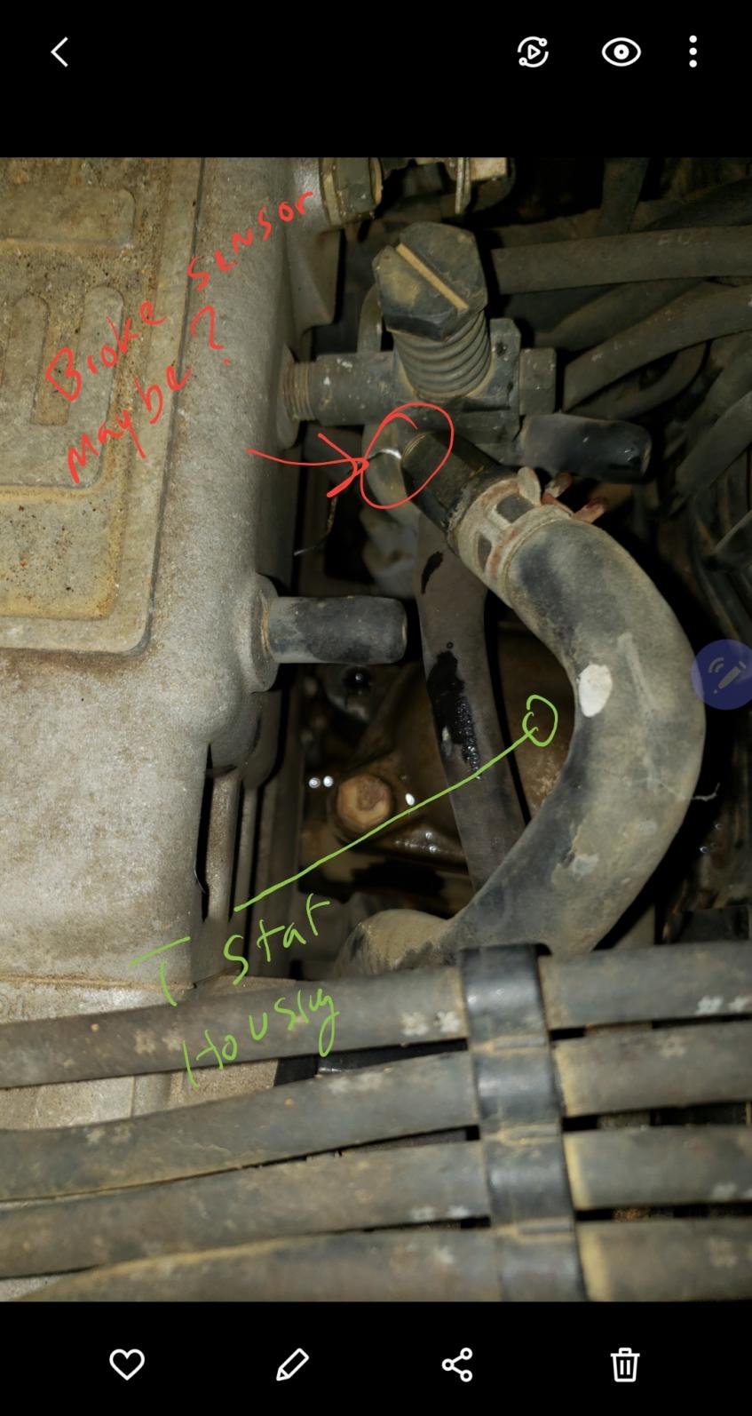

trying to figure out a what a part is on my 94 pickup with 22re. I dont drive it much, but the other day i was driving pretty hard and it started to run hot. I though it was just a old hose leak. Further inspection revealed it to be a metal fitting or sensor of some type broke....this fitting is located right beside and just a bit lower than the thermostat housing. the hose is not broke, but the actual metal is broken and it appears to have left a threaded portion in the manifold or whatever it is screwed in. I am having trouble finding out what this fitting is....please see if you can id it so i can get the right part....thanks
These pictures are taken from looking down on the engine.

Looks like it may be the water bypass union, part# 90407-53007. What does the other end of the hose connect to?
(I'm a 20 year Toyota Parts counterman)

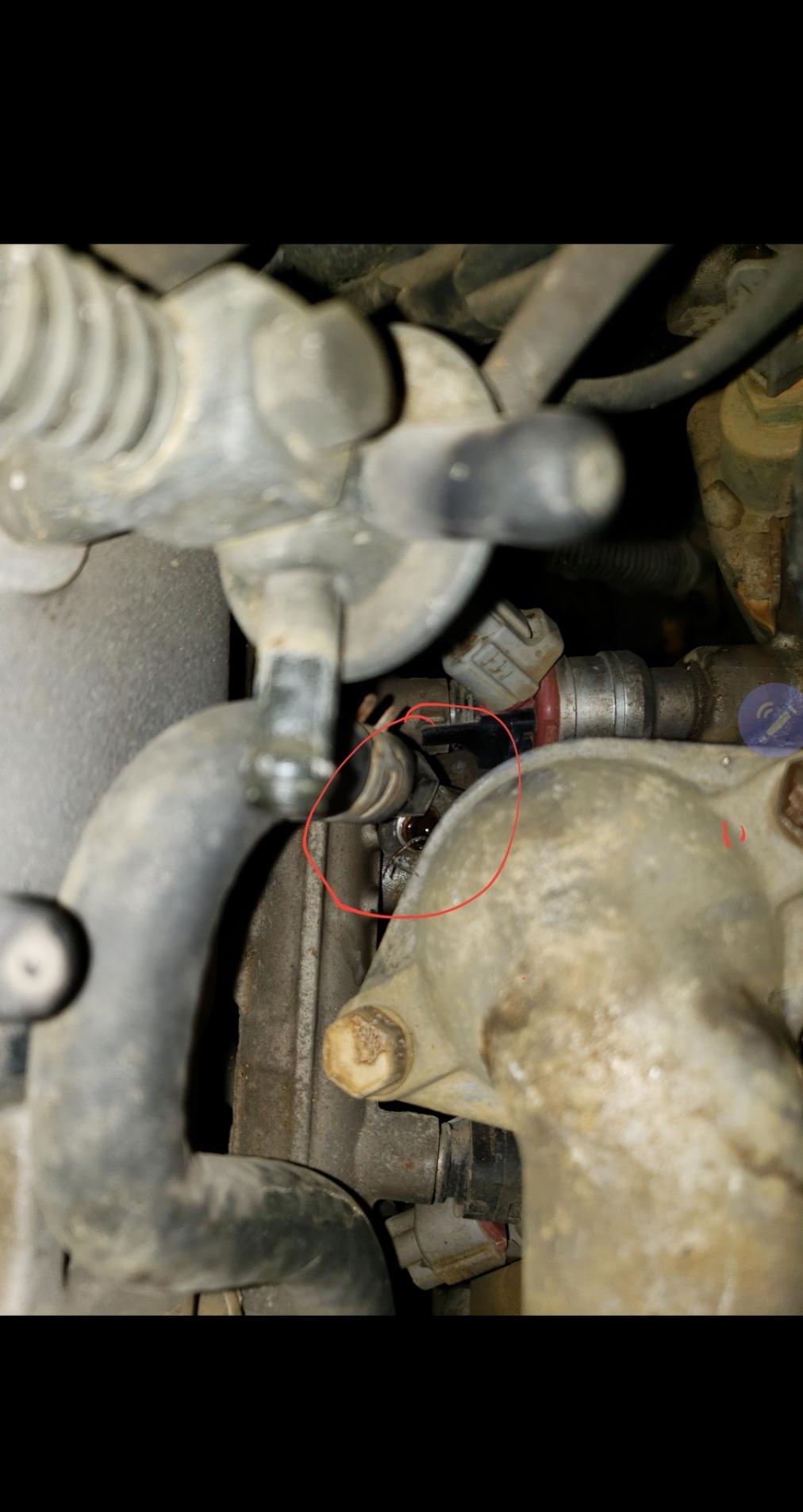

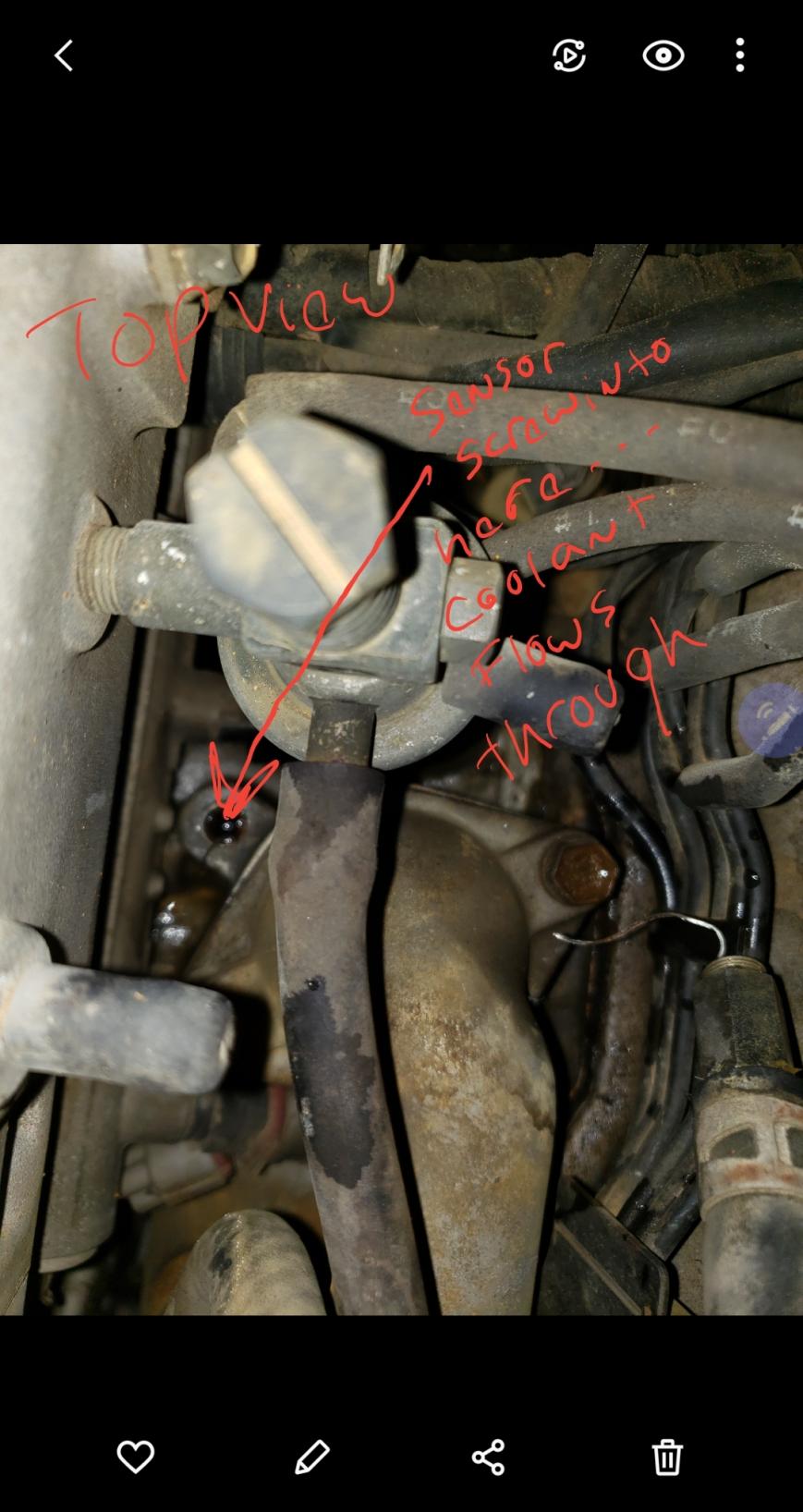

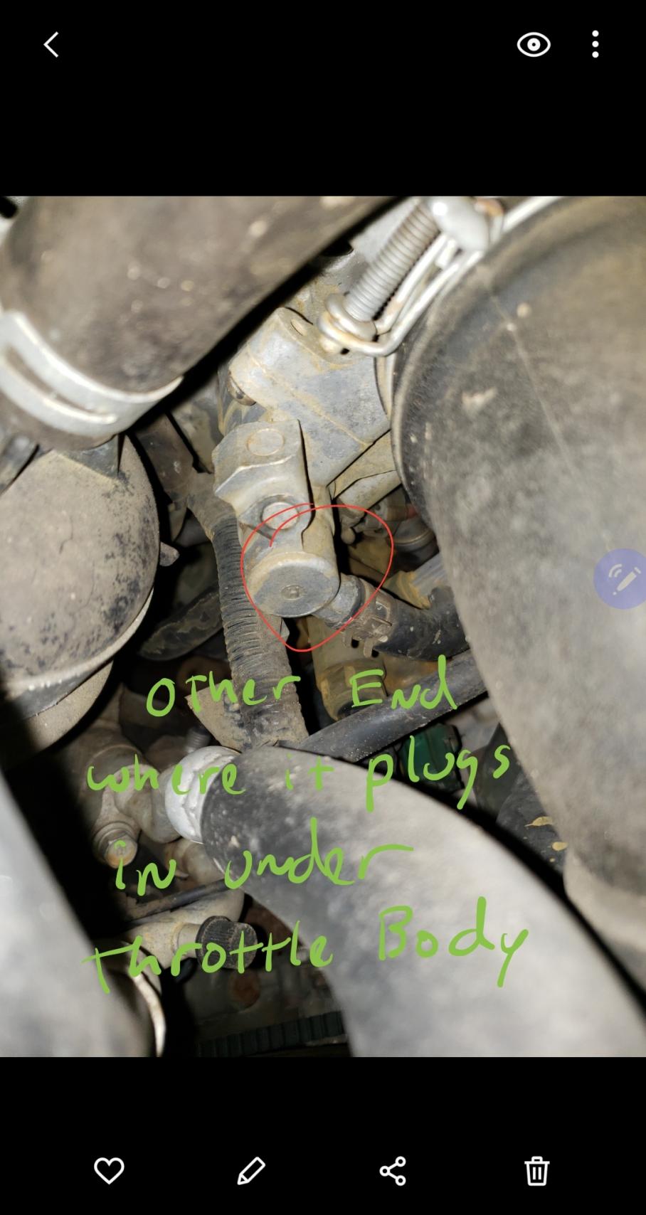

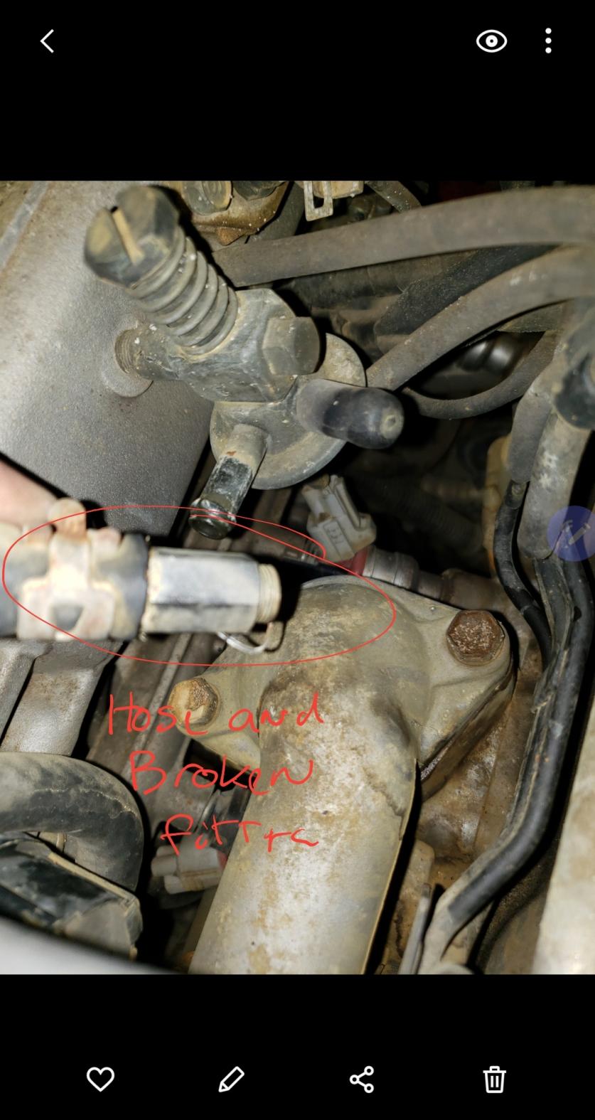

Here are a couple more pics...it goes from the thermostat area and snakes to the manifold or fuel injection area directly below where the throttlebody is housed.....does that help...thanks for your input

Ok, that is called "union #1", part# 90404-51060. It's discontinued, but there are still 10 left available nationwide. I'd order it from your local dealer ASAP...

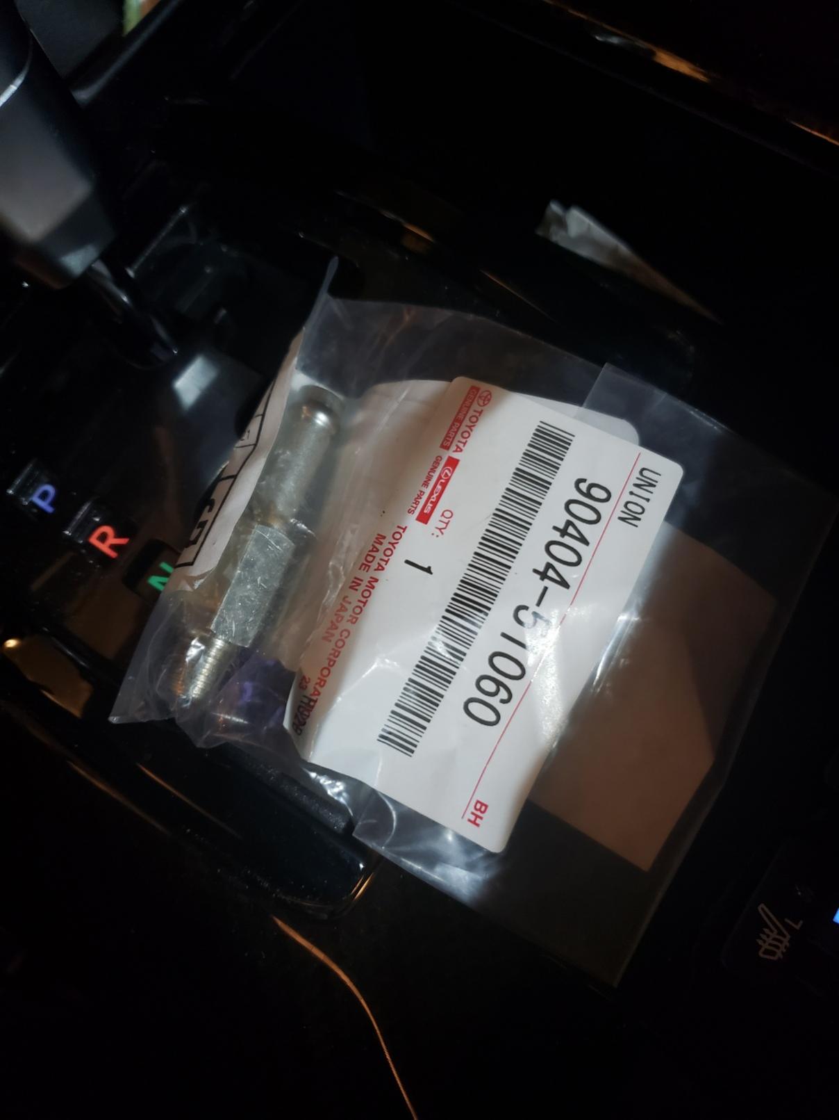

Voltan...part came in, thanks for the help. Now all I have to do is extract the broken off end in the manifold.
