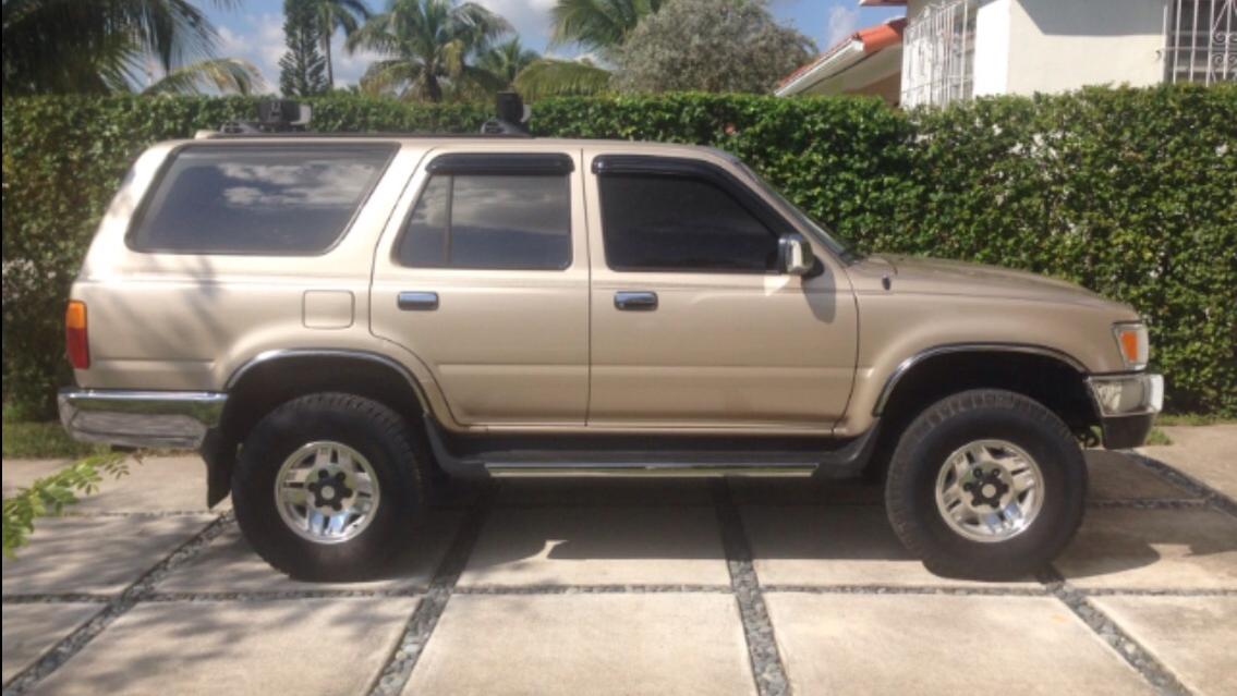

I installed Moog CC255 springs and Daystar 1.25" spacers all purchased on Amazon and at first the rear sag dissappeared and rear was just slightly higher than the front but over time the car has really leveled off. If I were to do it again I'd spend a little more and pick up Old Man Emu springs which I'm told raise the rear by 2" and don't require spacers.

Got the Moog springs and Monroe shocks installed on my 94 and it lifted the rear just a hair over 2". Looks level and rides allot better.
