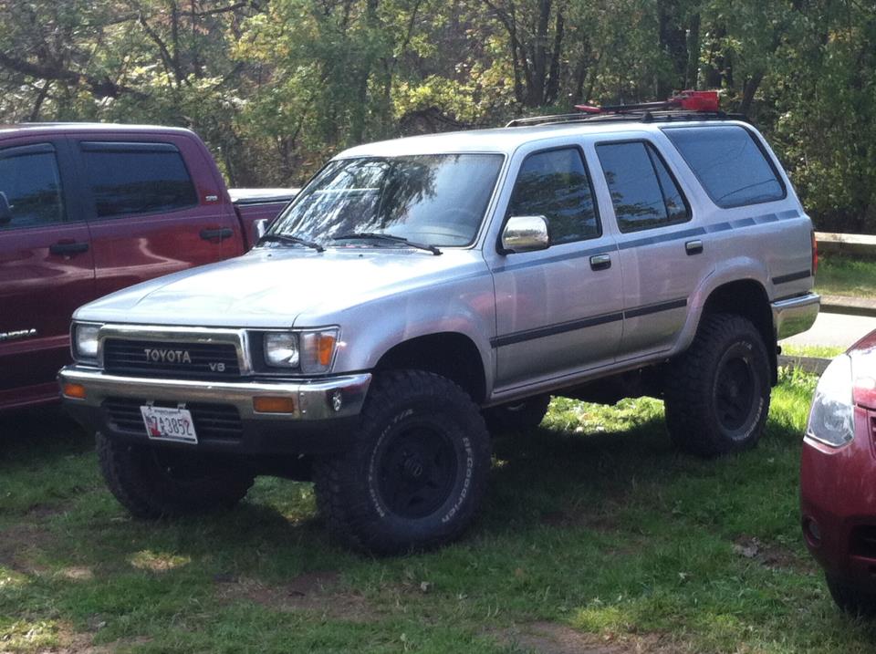

any idea if there are threads with actual pictures to go with the options? My ass has been saggin so long I can't remember what "stock height" looked like. And as far as an OME 2" coil...I'm not imaginative enough to think how 2 inches above what I can't remember (stock height) will look like. Just a thought
this is my 91 with the 2in lifted coils from ome
