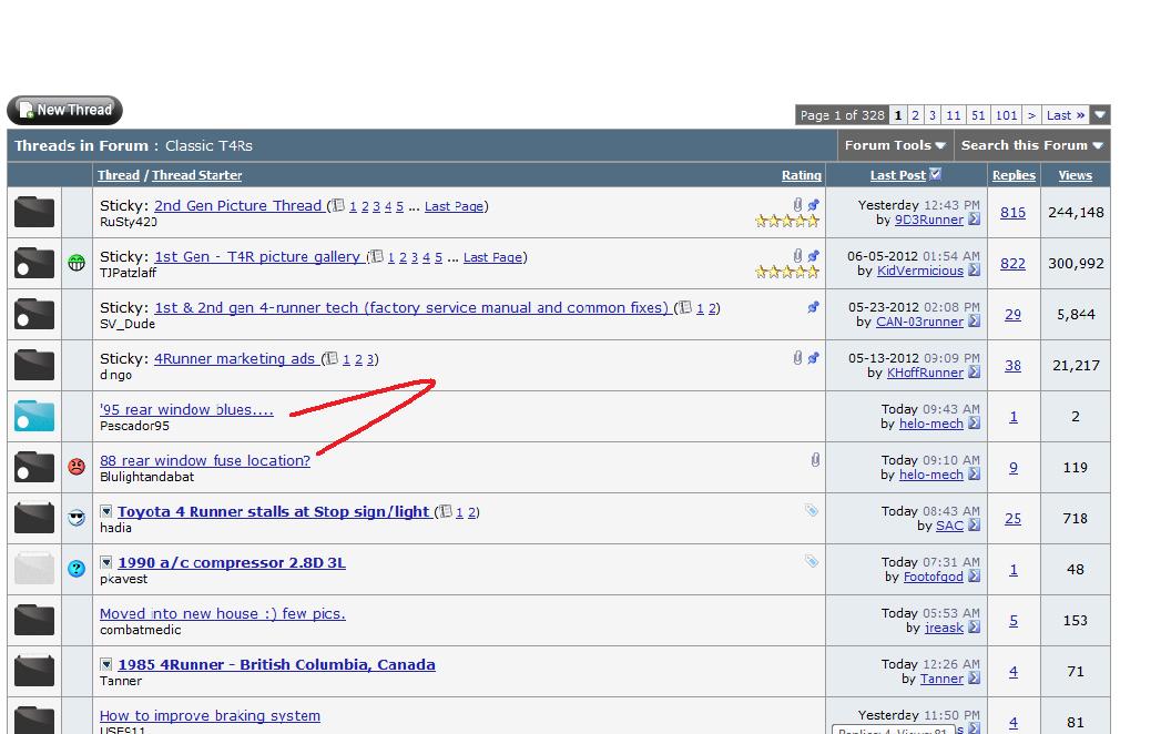

First welcome to the forum. The people here are great and the info out there is astounding. Hang out and browse around a little. This was one thread away from yours...........
http://www.toyota-4runner.org/classic-t4rs/117216-88-rear-window-fuse-location.html ......I know it is not the "same" issue but it is a "rear window" topic and it has some search suggestions.
