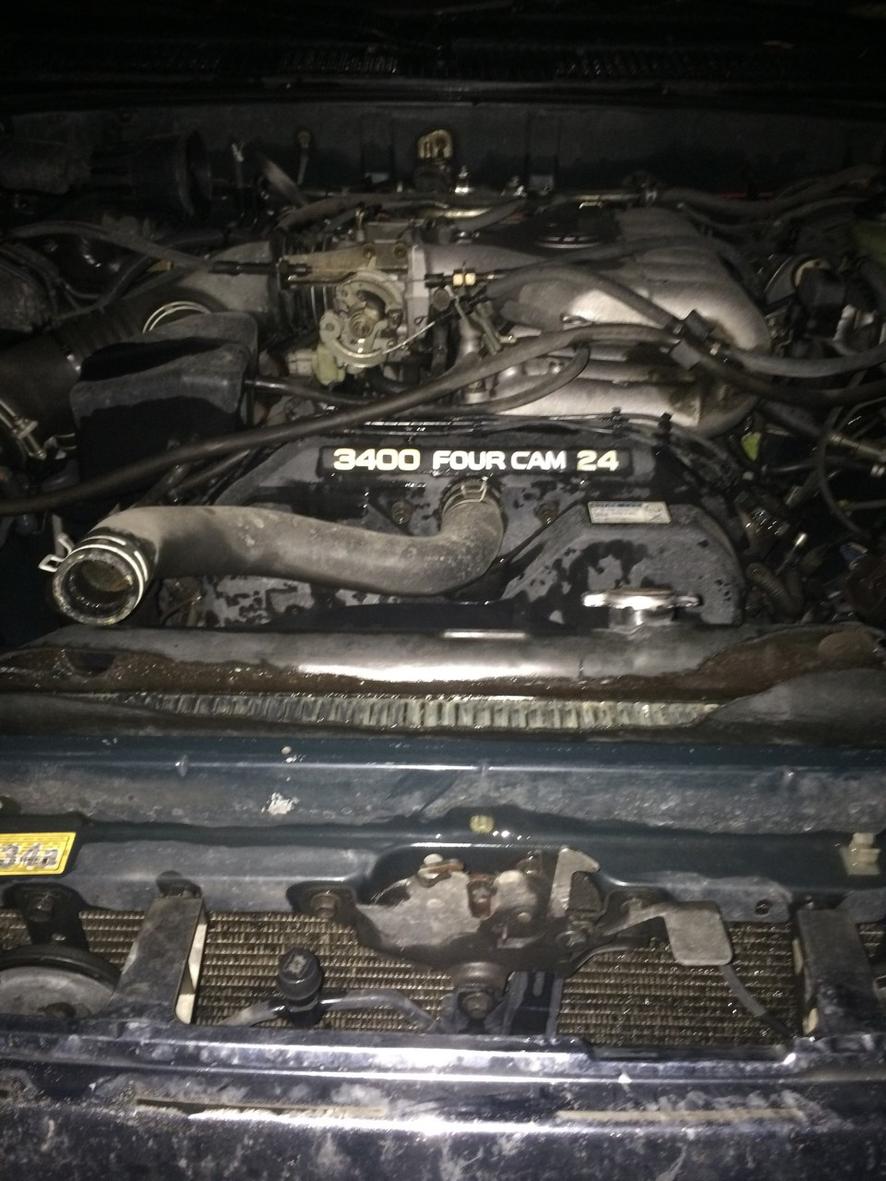

Opened the hood and the top radiator hose is blown off with plastic sheared off from the radiator still inside, the vent line blew off with the plastic still in it also. The entire top of the radiator was opened like a tuna can. Limped out of the mountains and then trailer to home. Radiator has cracks in bottom and side, so it hold no water at all.
Why, how, WTH, not a glitch, never hot, runs perfect (even now), fan clutch is good. Obviously I will put a new radiator in, but I don't want to blow it up either. It appears the radiator in it may be aftermarket due to appearance and nothing Toyota on it (don't know how to tell if factory) Please help or provide any info you can.

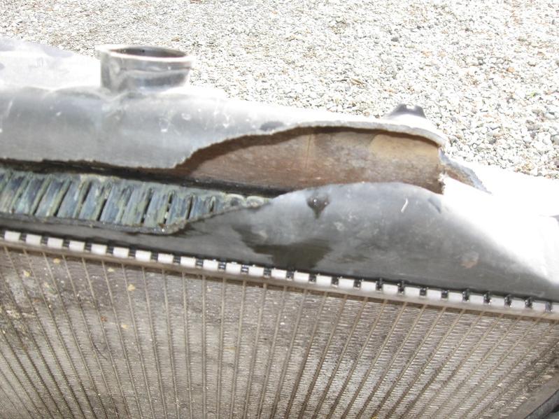

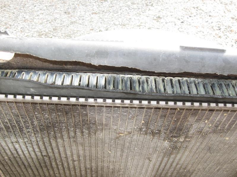

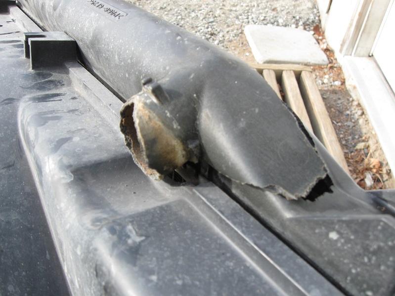

Pulled the radiator today. (Took an entire 15 minutes!!! LOL) Here is what it looks like. It has to have some other cracks as it hold almost no water. (less than a quart came out when removed lower hose) Radiator looked in really good shape as far as internally and cooling fins. Very clean!
