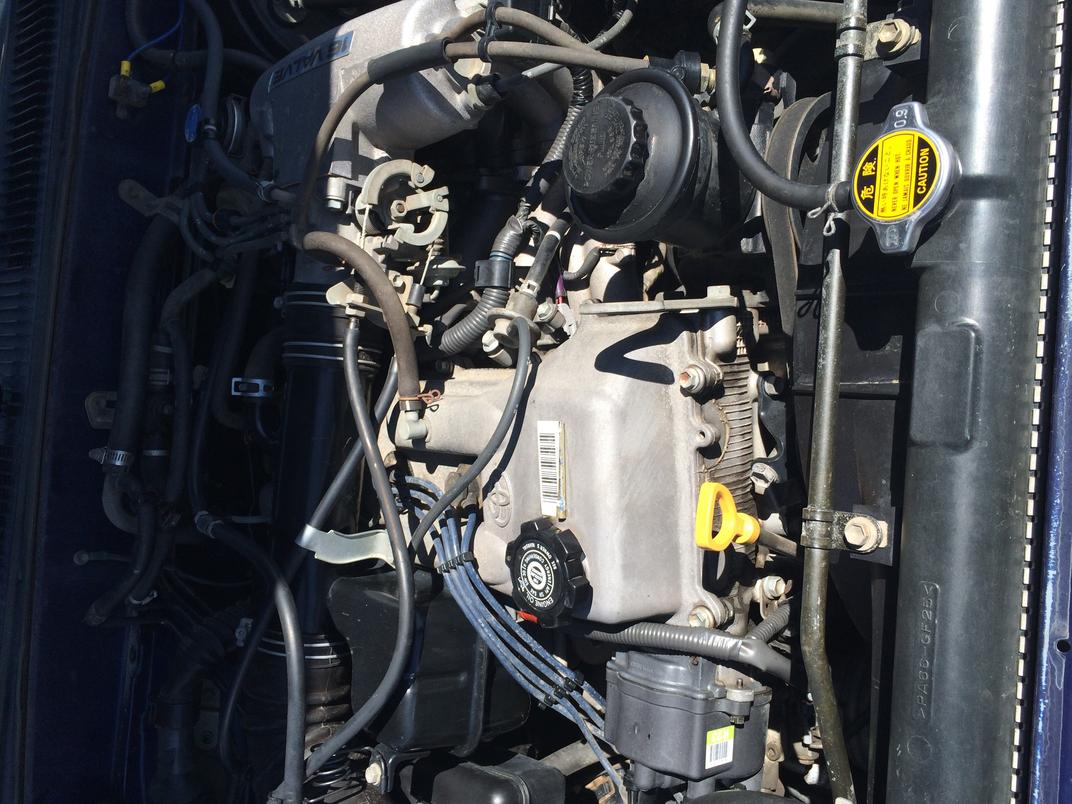

Hi, 2 weeks ago I bought a 96 4cyl with 357,000 kms, my plan is to drive it to work for the next 22yrs.
After reading the great threads on here, I thought I'd throw some in on what I've done.
After purchase of $3000 took to toyota and they replaced rear seal and all brakes and all fluids, $2000. Did I get soaked? Probably as everyone on here calls it the stealership, but was in my budget and now have a starting point as I have no history on this other than it was filthy.
From threads, mine buzzes when shut off, open the gas cap and it goes away, no part made for that anymore.
I had a good oil leak from the top down, took to a car wash, used magic bubbles bathroom cleaner and cleaned it up, went home took off air intake to clean MAS and throttle body, also replaced the PCV valve, all for ~$30 from Napa.
While air intake off, tightened down the valve cover gasket and all of them were pretty loose. Took pics thru out yesterday but haven't figured out how to post more than one.
Next up will be plugs and wires, let me know what you think I should change or upgrade.

3rz is a rock solid engine. You have one that is barely broken in. Next up I would do a seafoam treatment through the vacuum line and put another treatment in the gas tank to clean injectors and the tank.
Another thing to check is your valves. The 3rz is not a self adjusting valve so that's an easy check. It's a fairly easy fix too that would run you another 500 starting at the stealership.

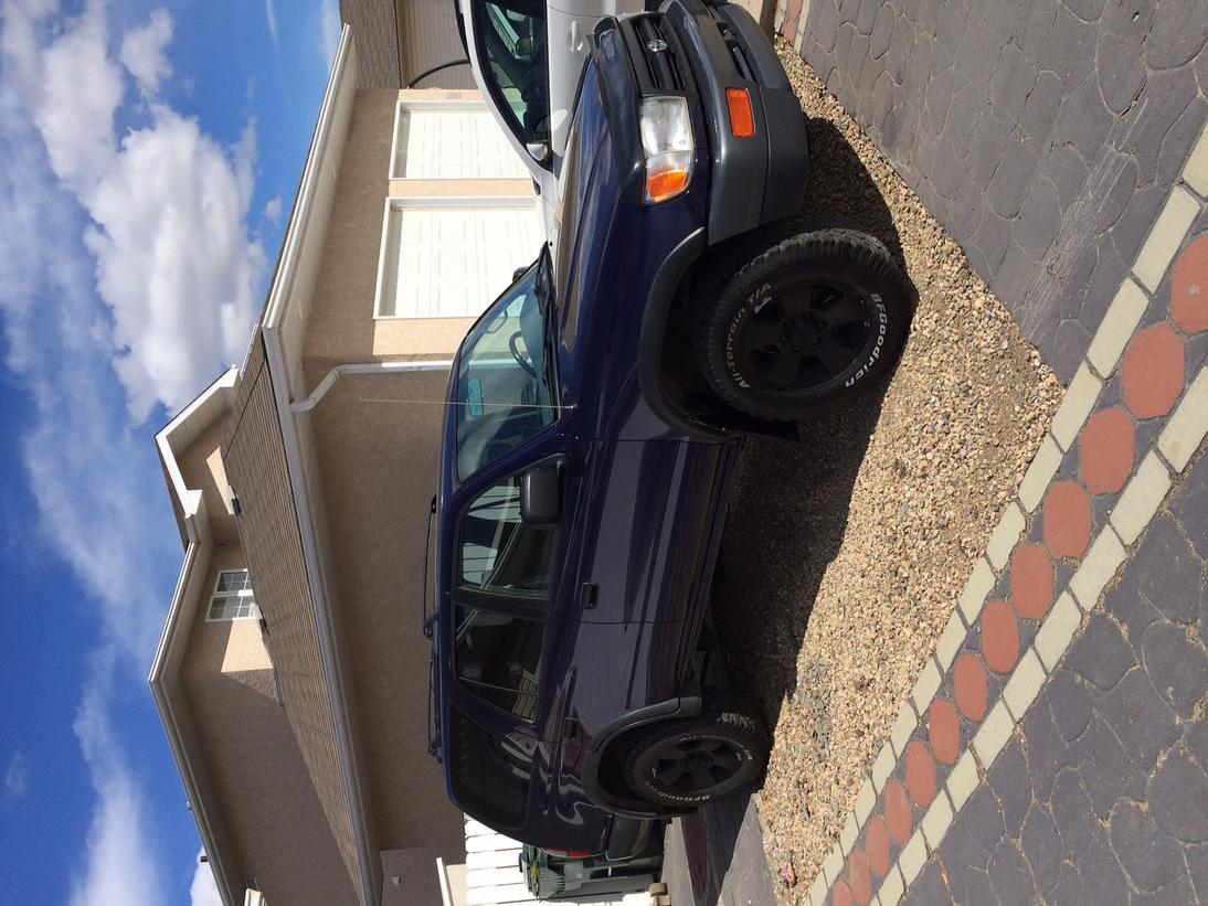

More pics of the truck? 2wd or 4wd, stick?
To be honest the rear seal on the 3rz is a PITA and very easy to screw up. There are guys who are yota professional mechs and they complain about it. To get a starting point you might have gotten hosed......but you didn't get screwed and there is a difference.
It's a 4wd, auto, got lots of pics still figuring this attaching out, underneath is quite rusty, will be wire brushing and painting that too, lots to do, play around with.

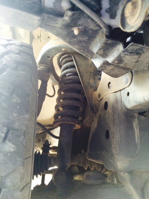

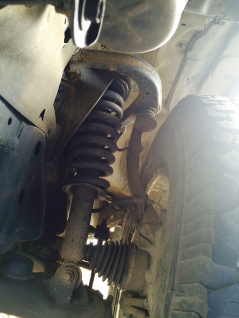

I took some pics of my shocks/ struts, you feel every bump in this ride, like I'm riding on plywood, maybe an air ride seat is what I need haha, check out the rust (grey hair) on this old girl.
And the last one, I'm thinking they are originals? Maybe newer would make the ride more comfortable? This was supposed to be a hobby fixing it up $100 here, $100 there, but I see that it could become an obsession quickly... Love it! My wife still hates it,

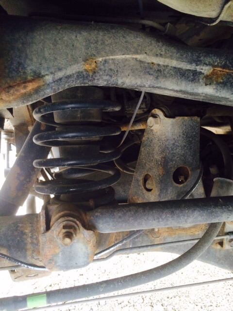

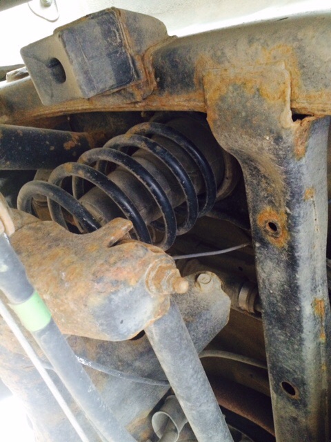

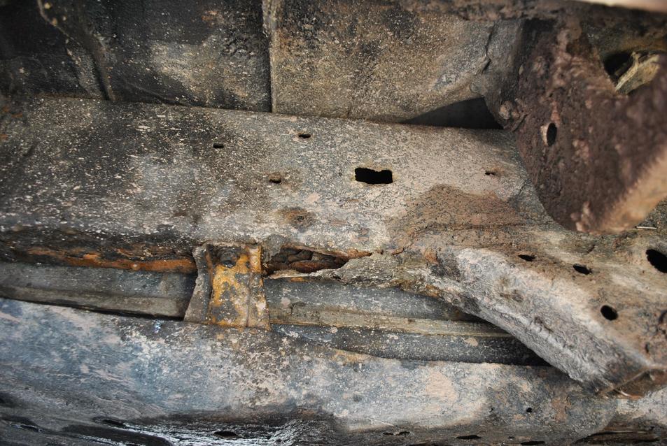

Here are the rust areas I have right now. Not too bad for 18 years eh ! There's a couple of winter snow shots too.
