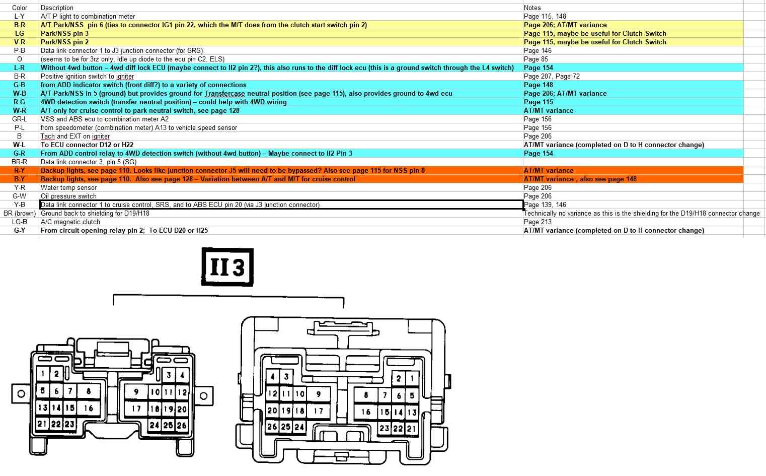

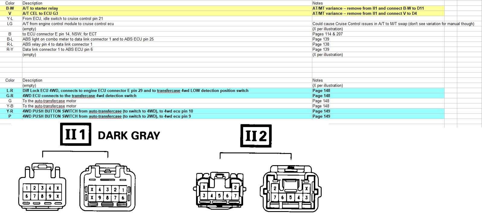

I've gone through the diagrams.
The sr5 manual doesn't even have the II2 connector. It appears most of the transfer case and locker wiring runs through it.
There were around 9 wires from the ECU variation to the body (H vs D plugs) of which 2 will come from II1 (STA and CEL).
There are 3 wires for the engine/NSS I will need to do something with, might attempt to re-incorporate the clutch switch and the clutch cancel switch in the II3 connector.
There are then 4 wires in the II2 for 4wd I will look into, 6 wires on the II3 for 4WD, and 2 wires for reverse on II3.

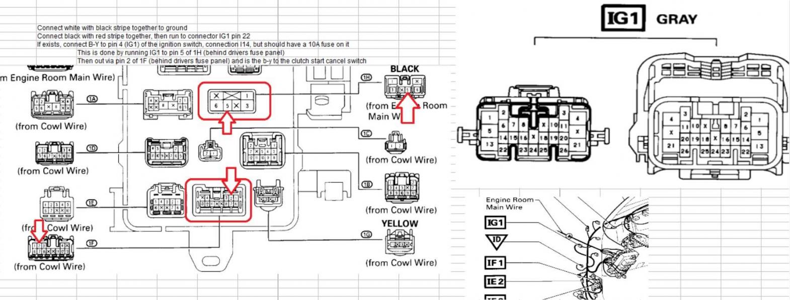

Since the II1 connections to the ecu plug are easy I decided to figure out the clutch switch and cancel switch.
Also turned out to be quite simple and most of the wiring is already in the limited.
The clutch switch bas 2 wires (white with a black line and black with a red line... will refer to them as W and B).
The clutch starr cancel has 3 wires (white with black line, black with red line, and black with yellow line... will refer to them as W, B, and Y).
The Ws go to ground. Tie them together and connect to a ground.
The Bs go together. Tie them together - these replace the A/T NSS system and you done need to do anything at the II3 connector. These connect to IG1 pin 22, which is where the NSS also connects (after it would have passed through the NSS, so you're basically bypassing the NSS). I will use a T-tap here.
The Y is a fused ignition connection that runs through the driver interior fuse panel. This is at connection 1F (which is at the bottom center) pin 2. It's a B with yellow line (imagine that). I will also T-tap this wire.
Connect your B to the IG1 wire and the Y to the 1F wire. This completes both the clutch switch and the cancel switch.

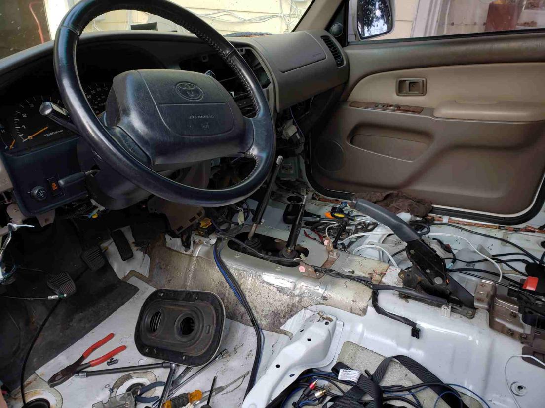

I am pretty positive the wiring is done. Nothing needed for reverse. Repinned 2 wires for the transfer case, so the body (limited 4wd computer) receives the J shifter 4wd/low signals... and then simply jumped 2 wires at the 4wd computer to trick it into thinking the 4wd button is switched when the J shifter is put in 4wd.
Also seam sealed the welded center tunnel.
Now to get the engine back in.
Engine, transmission, and transfer case are all bolted in, started to do some of the connections and ran out of time. Seems to all fit well.

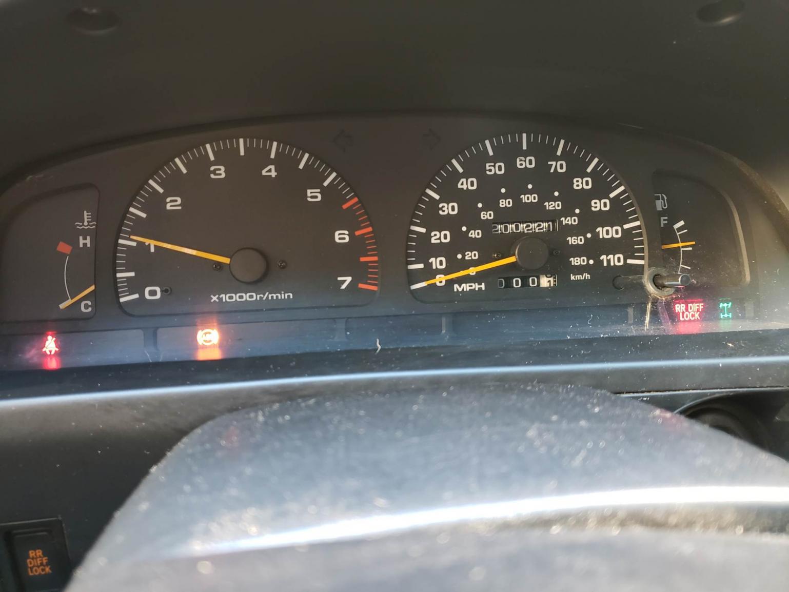

Got some work done and, with the exception of II1 not being tight enough (I did it in the dark of night last night and must have gotten distracted) initial test fire worked flawlessly.
I did put the J shift into 4wd and then the light on the dash did kick on. I hit the diff lock and it just flashed, but there's no drivelines and the ebrake was set... so I'm not sure if it was actually trying or just yelling at me.

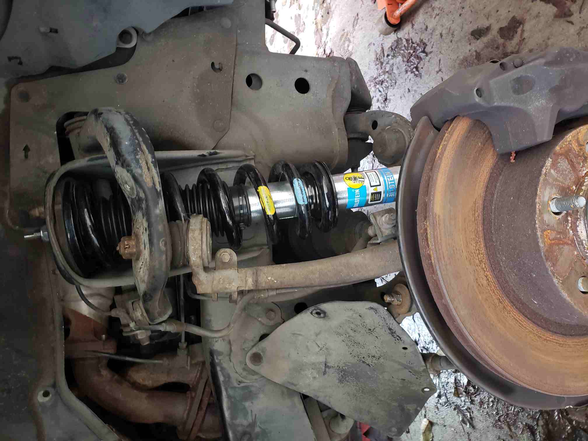

Front and rear shocks (new Blistein) swapped in
Front and rear springs (4th gen xreas, with only 100 miles) swapped in.
Not too happy with the 'lift' on the front- the Bilsteins do have the height adjustment but I don't want too much preload on the springs. Will see how it drives as is.
