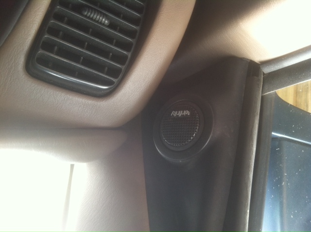

Hello all. I am new here and recently picked up a 97 limited in great shape. I have searched and have had no luck finding any info on the sound system. The front doors have tweeters that say "infinity" I'm guessing like infinity kappa. Does anyone know where I can find the specs or general info about this sound system? Thanks

Dude the 4Runner never shipped with infinity speakers.
You have after market speakers from best buy or crutchfield etc.

Actually yes it is the stock head unit. Maybe that is why I haven't been able to find any information on this setup - it doesn't exist. If in fact these are just replacement speakers someone did a really good/clean install and I won't be fiddling with them anymore.

Here is a picture of the tweeter with the logo which fooled me into thinking this truck was infinity equipped throughout.

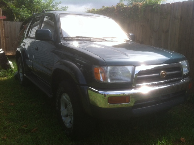

and here is a shot of the nice minty truck itself. Thanks for the help

I think your Prev owner simply pulled the amp and stereo but left the older kappas when he sold the car.
