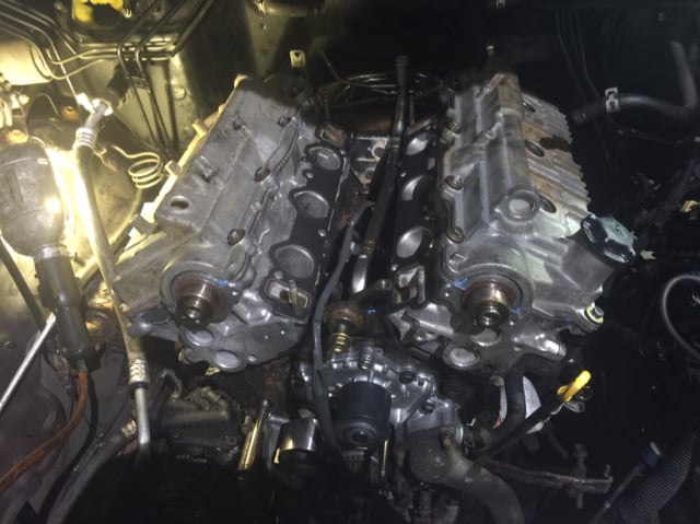

Removed the nuts from the exhaust studs and started installing the studs in the heads. When exhaust manifolds are done I'll look at valves before too much gets put on the engine and things start getting in the way.

So I'm in the process of checking valve clearance and have a few exhaust valves at 016 and 017 thou. I'll reshim those.

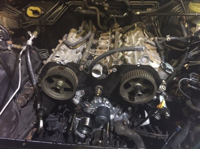

I prelubed the engine and it was turning over way too fast. And of coarse it didn't try and start. So I pulled timing cover off and sure enough I was off around 15 degrees on the cams with crank at TDC.
I'm telling you, I got so lucky. I was able to put the pin back in the tensioner. I removed the center cam belt bearing and put the cams back to strait up. Then put the belt back on the cams and was able to install the cam bearing. Rotated the engine 4 times by hand and cams were in the correct position at TDC.
